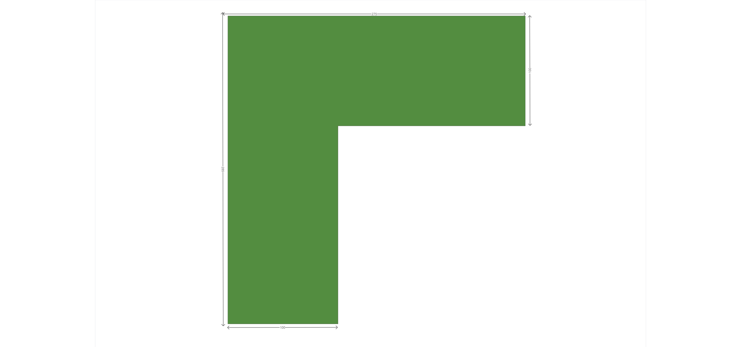

Hey All,
After a bit of shifting things around I now have the following space to create a layout the space see image with sizing was wondering if there are any links to a point to point layout someone may have tucked away that i can draw some inspiration from as i think given the widht of 1m 24130 curves would be my only option which i kinda want to avoid any link suggestions welcome.

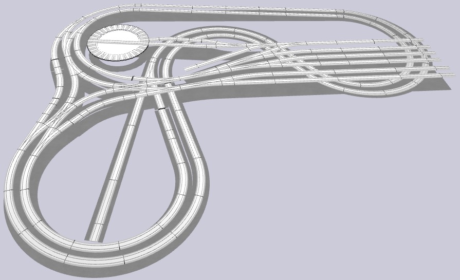

Without further ado, I can pull these two L-shaped "busy big city" designs out of my sleeve:
1. Inspired by John Armstrong's classic "Central Midland" design.
196 x 239 cm outer dimensions according to my trackplanner. The wye is overdimensioned to make the trackwork look more impressive.
The most critical ramp is one the involving the lower R1 curve. The distance between the underpass and the first turnout on top is a little bit more than 210 cm. Assuming that the terminus is 8 cm above ground, the slope would be 3.8%. This is doable.
2. This big city passenger traffic layout would require more cityscaping than landscaping. On the lower level a siding - plus stub tracks for freight traffic in front of the elevated passenger terminus - could be added.
Artificially extended double-track mainline on condensed oddly shaped "corner module" (upper ledge = 170 cm); in-and-out operation from stub terminal on separate "shelf"; concealed reverse loop on lower level of "corner module"; R1 and R2 curves and 4% ruling grade.

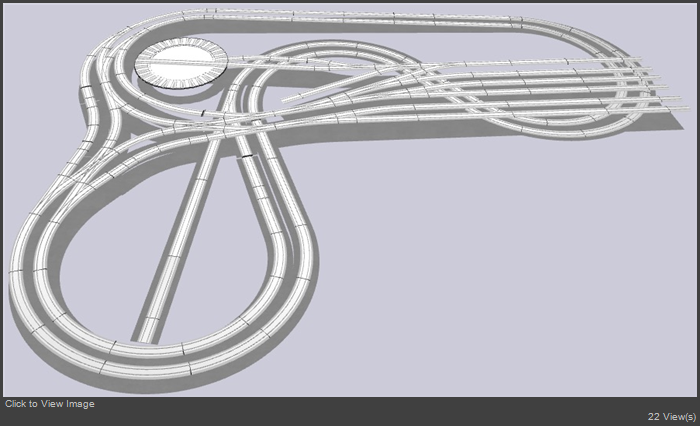

196 x 239 cm outer dimensions according to my trackplanner. The wye is over dimensioned to make the trackwork look more impressive.
Thanks for the inspiration I am to confirm I can access the back of the L I am looking at modern era germany so I was thinking small town or city station, I am not a huge fan of turntables personally i was thinking given my space restrictions a loop layout was a bit too tight space wise i was thinking along the lines of a end to end layout with a possible lower level loop but this has given me some inspiration.
So thanks for responding
