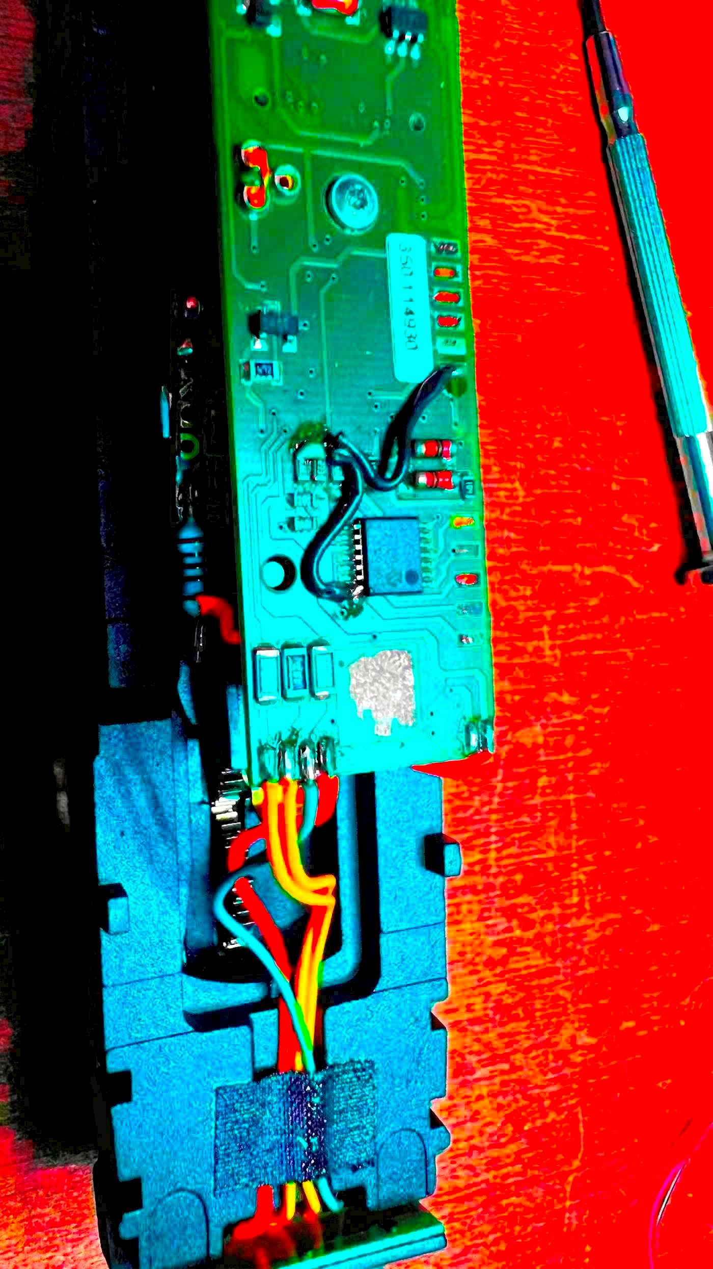

We have a new CS3 and all the auto registrations have gone perfectly until we put the E50 (39500) on the programming track. No activity at all. I've tried to manually register it on Address 50 without any luck. I've got the loco open and it looks absolutely perfect. Any suggestions what I might test for 'under the hood'?

Thank you Jean! I’m looking at everything and it all looks perfect. I’ve attached pics, hopefully you can see them. Could the decoder just fail? It seems unlikely.

Hi John
"Could the decoder fails?" Yes it could have but other things may also be wrong.
I suggest to test the loco with AC power (from 6 to 14 VAC) and see if something happens (light, motor turning, etc). DO NOT try to reverse direction with an old Märklin transformer.
By testing using an mLD3 (60972) or mSD3 (60977) AND updating the motor type (CV 52=1 und CV 56 =0 and CV 51 =24 or =0 depending if AUX3 and AUX4 or logical or buffered.
If the test is negative, you may still use the decoder used for test for another loco.
Make sure FIRST that the power reaches the decoder (21MTC interface). Use a multimeter to check the continuity
Pin 21 connected to wheels
Pin 22 connected to slider

Hi John,
I will also reccomend to first start reviewing the slider. I have had cases of locomotives not starting due oxidation of the cooper contacts after a long period of time of not been used. Take out the slider take a look to it, move it and then re install it and test the locomotive again. May be that is the problem.
Next step will be to test it deactivating MFX protocol in the CS3 and using MM only to test. If there is no reaction (lights or sound) there is still a possibility of a failure in the connection from the slider to the decoder or the return to the decoder.

Well, I sat down and got ready to go through every suggestion that you guys made but I started with this one, Eduard71. Turns out the slider was clicked into the wrong position and was not making any contact with the connector. It's moved the slider, put it on the programming track and it's running beautifully. You can't help stupid!! We now have every single loco running from my Dad's set (16) and we're starting the layout build. Thank you guys for all the help!!
