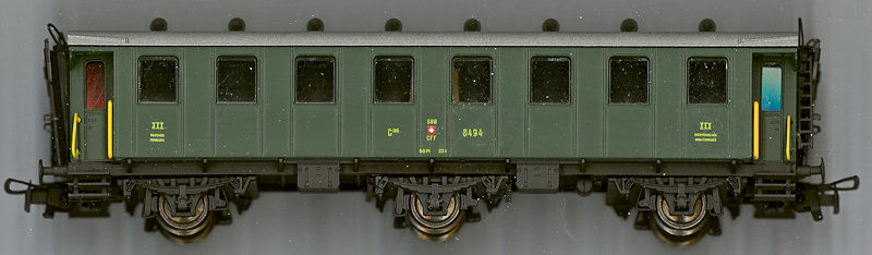

Welcome to the forum! If I am not mistaken, this is an Ae 3/6II. This means there was a total of six axles whose only three were powered. On your picture, the powered axles are easily distinguishable by the size of the wheels and the bars linking the three main wheels. The non-powered axles are the small ones. The designation II indicates the type.
60 locomotives were ordered by the SBB and placed in service between 1923 and 1926. They were used on the main lines of the SBB, after the completion of the electrification of the Gotthard line. At the same time were also in service Ae 3/6 I, Ae 3/5 and Ae 3/6 III.
Brown is the original color. Most of them were repainted in SBB standard green in the late twenties.
As for the passengers cars I am not totally sure. You have two 3rd class cars. As far as I know, the 3rd class (the least comfortable) was abandoned in the late forties, earlier fifties. Thus my best guess these cars must have been in service around 1945-1955. It's not impossible that an Ae 3/6II pulled such a convoy, but most likely they would have been pulled by a more recent locomotive such as Re 4/4I or Ae 4/7.
Such cars can still be seen in Switzerland, but only in historical special trains.

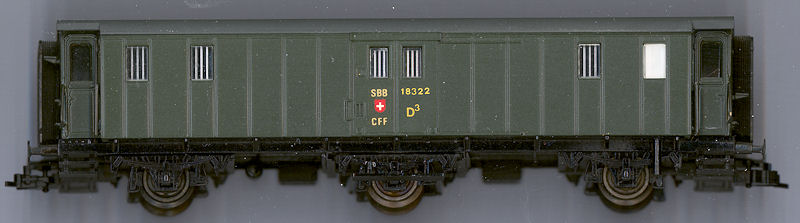

To my knowledge, there were three axles passengers in service in 1920 - 1930. See this model car for a pretty good representation: http://www.roundhouse.ch...afik/Ruco/Ruco_15006.jpg , http://www.roundhouse.ch...ik/Ruco/Ruco_15003-M.jpg and http://www.roundhouse.ch...Ruco/SBB_D3-Eigenbau.jpg
There were also more modern coaches like this set produced by Marklin in 2001 http://archiv.maerklin.d...mp;wishednumber=00790-03 . It's not produced any more but you can find it for sale on Ebay.

Following the advice of Mike C, I also bought the historical set from Roco #45916 containing 4 coaches appropriate to this era. I personally like the restaurant car: the interior looks very detailed. Only figures are missing now to recreate the impression of reality.
3rd class coach car:
Restaurant car:
Restaurant car: interior details
Detail of a 3rd coach car and the Concertina. If the car is used as a tail-car, a enclosed narrow concertina can be used.
