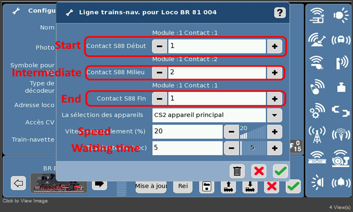

Now how to install a shuttle train?
1- select the loco you wish to set in shuttle mode and edit it (the wrench) and you get this screen
2- indicate
  1. the start contact
  2. the middle contact for a limited stop (optional),
  3. the end contact (where the loco reverses after a while)
  4. the desired speed
  5. the desired waiting time for intermediate stops and direction reversals

Thank you, thats exactly what I needed. Appreciate it.
