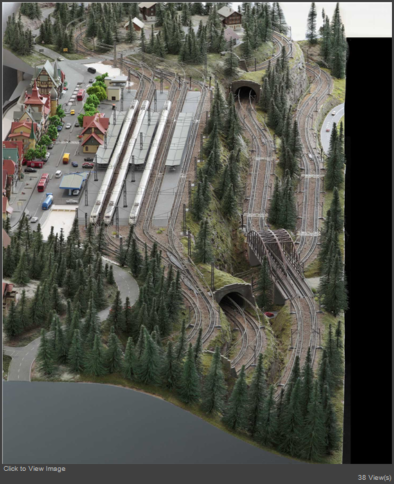

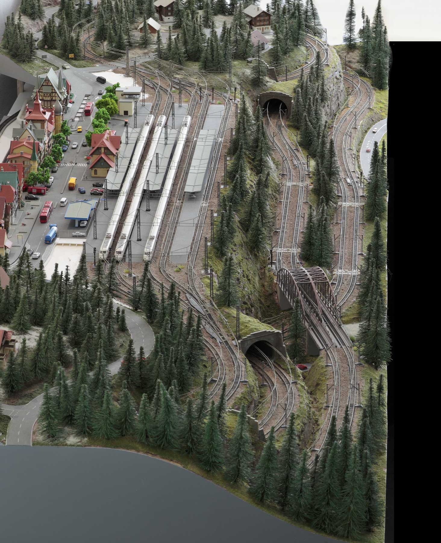

A photo to encourage catenary. Also shows the outer rail 50mm in from the edge and using topography RLs (relative levels) to enhance the "building site".
Vertical topography at the edge is not difficult, actually a vastly under utilised freebie which will visually enhance the scenery above and below track level.
My lowest bit of scenery is 35mm below the rail (in photo below), but even if you can go about -20mm for a creek or culvert it will really stop looking like the layout is built on Lake Eyre (Australia)!
I have also replaced all the short lengths of rail with 660mm.
(Shot with 135mm lens, cropped)

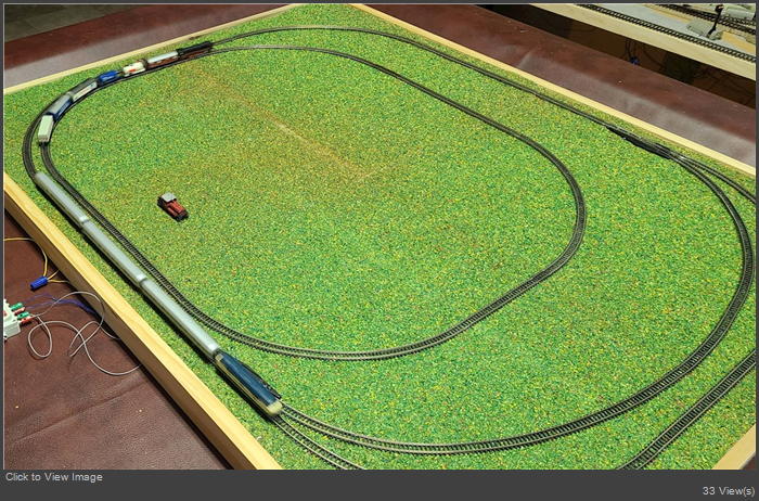

Testing the basic layout with frame and (old) mat on dense foam base. Turns are 8520 and 8530, as 8510 radius seemed a little tight. The outer loop turnout section uses flex track, as I could not get standard track to work. Ramps and bridge for inner loop is next.

@Ben P, steer clear of the 8510 small radius curves as the modern Märklin locomotives cannot negotiate them.
ChrisG
Offline BenP
#13 Posted : 12 November 2022 23:25:04(UTC)
BenP
Joined: 04/02/2021(UTC)
Posts: 549
Location: USA
ChrisG
Agree, but annoying that there is no ramp piece for 8520, so i have to make a ramp myself.

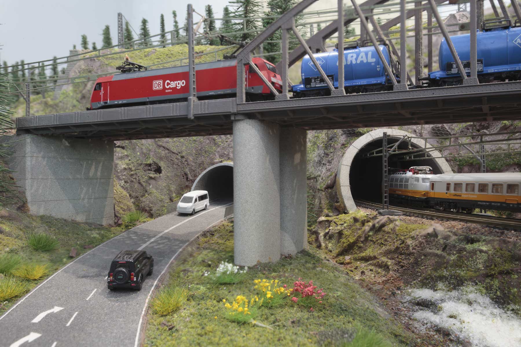

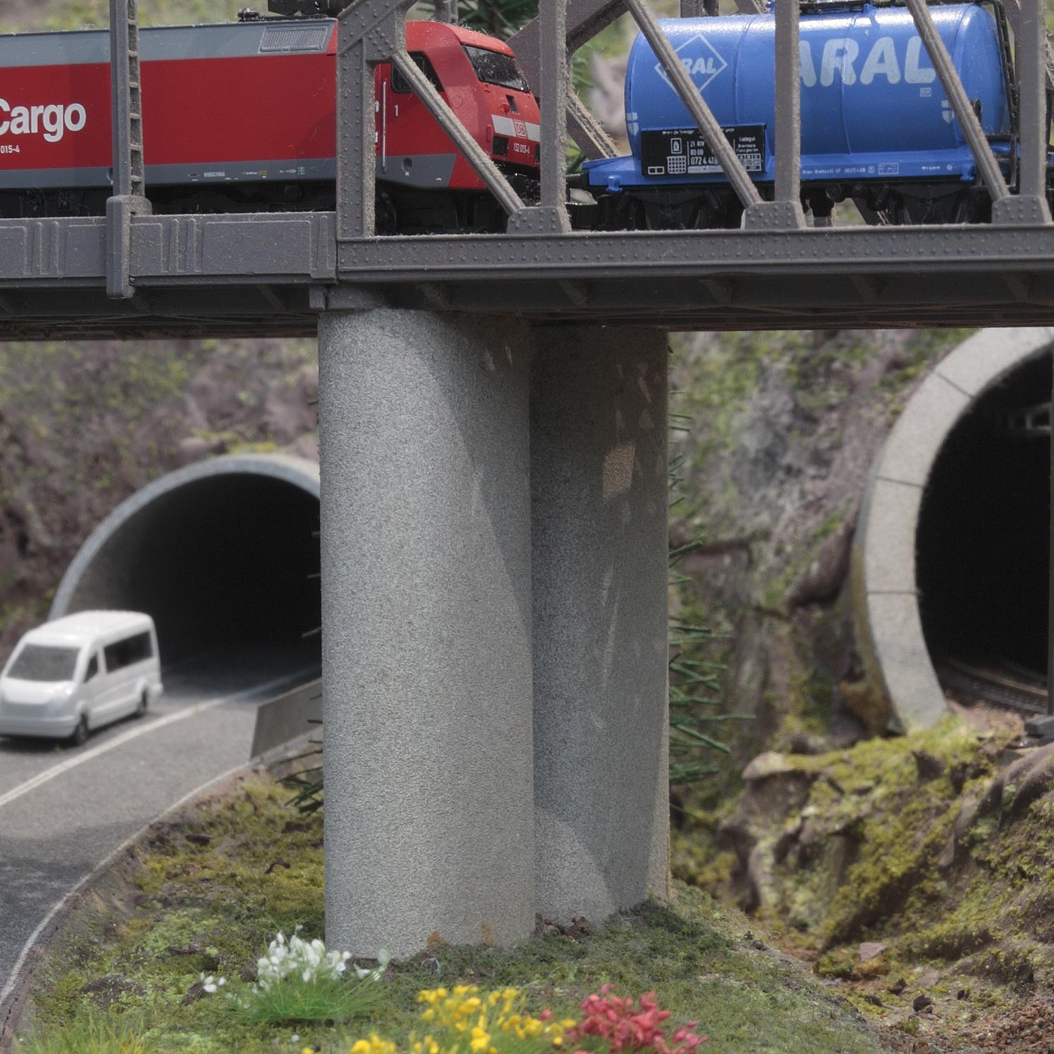

I made up the columns myself and spray painted with touch up spray cans. The bought columns looked a bit ordinary. If you need various bridge radius, use high impact styrene. If you don't really see under the bridge, don't bother with the detail underneath.
To get a textured finish with spray cans, for concrete use grey, white and black. From a distance to get drier texture paint, spray grey, then a touch of black and white colours. Then a touch more base colour grey to cut back the black and white as bit, looks better from acute angles, as the last colour shows up the most, so you need the base colour.
If you are after a bit of moss paint bottom of columns with a whisker of green. Also looks better with a bit of base colour over the top. For finer spray warm spray cans up in a bucket of hot water. Practice on test pieces first.
Same spray painting process for road texture. The bridge structure I spray with a touch of heritage red colour to cut back the plastic look, but it doesn't show up in these photos.

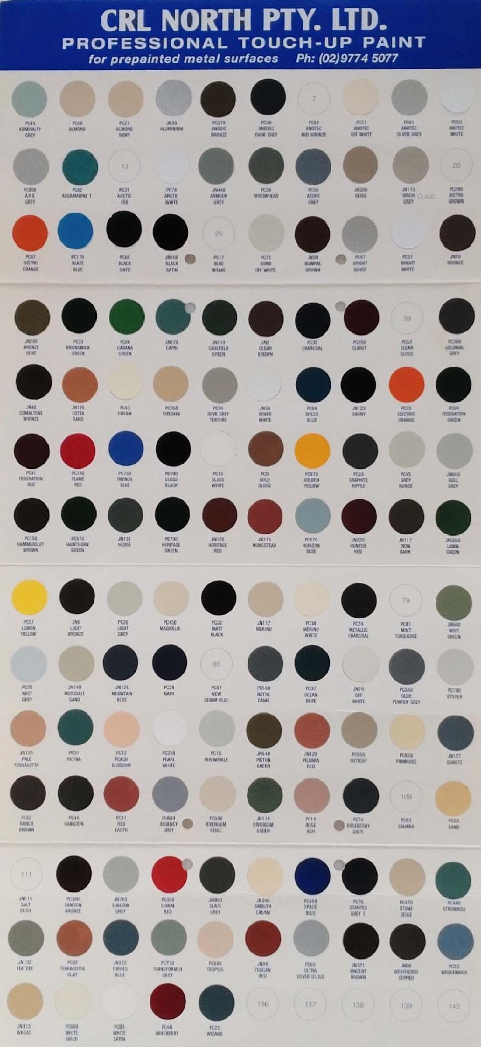

In Australia you can buy these colours from https://www.crlaurence.c...;ModelID=22122&pom=0 a mixed dozen or two is the way to go to amortize freight cost.
An old colour chart, quite a few of these colour are not available now.
The paint is the same as the touch up cans from the auto stores, but just in the building colours and powder coat colours, and a lot cheaper (on the left is a can from Eckersley art and craft supplies, they are expensive but they are a different range of colours. Bought this colour for one of the Unimogs when I eventually get around to finishing it)

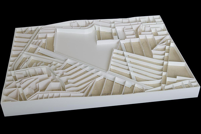

An example of building up RLs (relative levels) on an architectural model. Whether it is an architectural model or gradients for train layouts you need to put the effort in to get RLs correct.
Give the base of your layout a RL and always add from there, it can be 0, -10 or whatever, but it becomes the reference for all the gradients.
You can go about this a number of ways, but at the very least great a master plan. Butcher's paper is fine. You can then plot on the master plan the RLs at each critical point. So for example if you have a loop crossing over itself you can then plot at regular intervals the increasing height for the required clearance.
It doesn't matter how long it takes to do a master plan, but it will save you 10 times avoiding reconstruction stuff-ups.

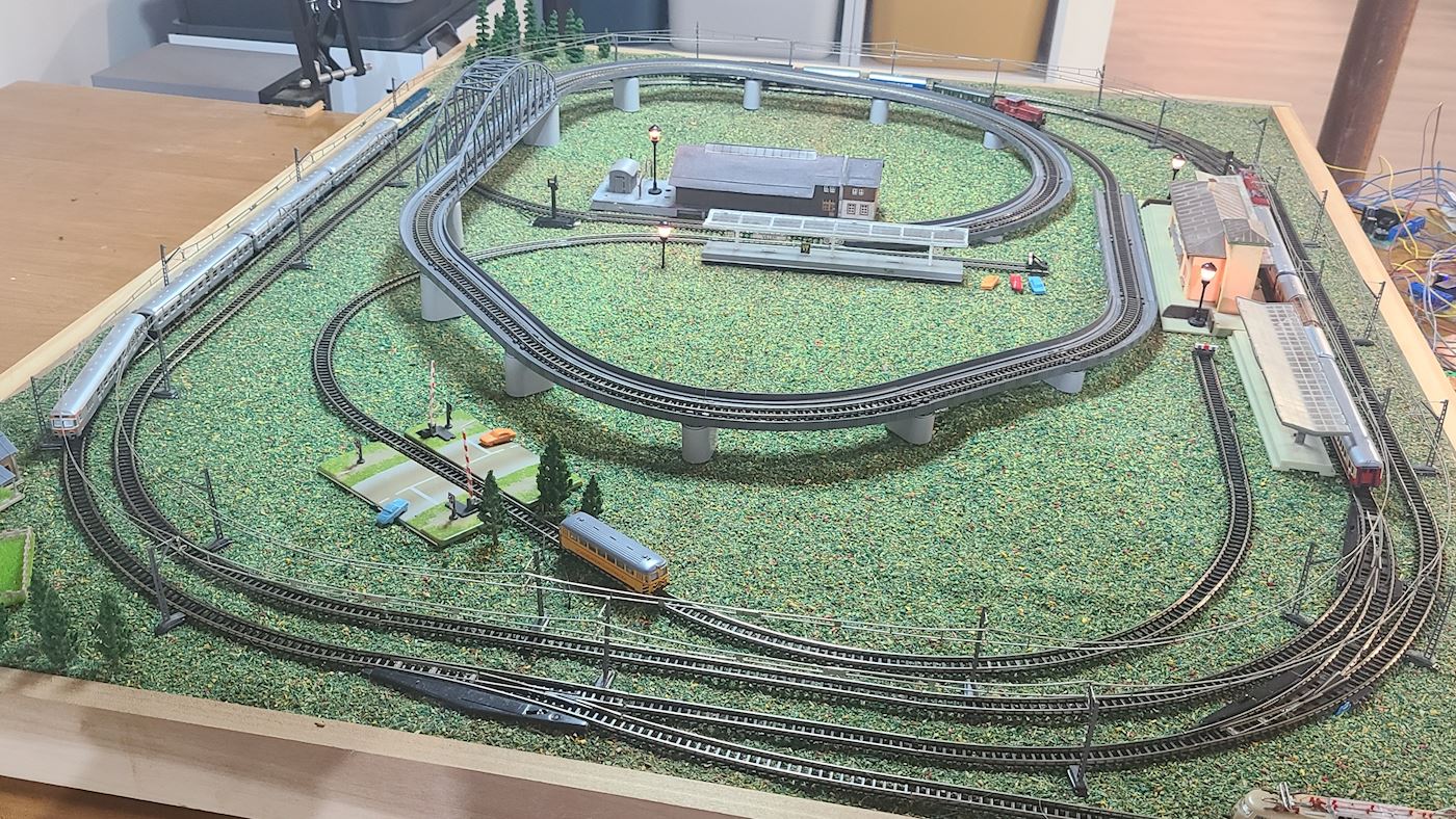

Progress with layout. Added more track, functional catenary and some electronics. Three transformers control motion. Shuttle bus works with a power module. Next is the final crossover track (changed parts to 8510 for tighter curves). Still need signals and then ... scenery. Dreading the latter, as I am not good at that.
Ben
