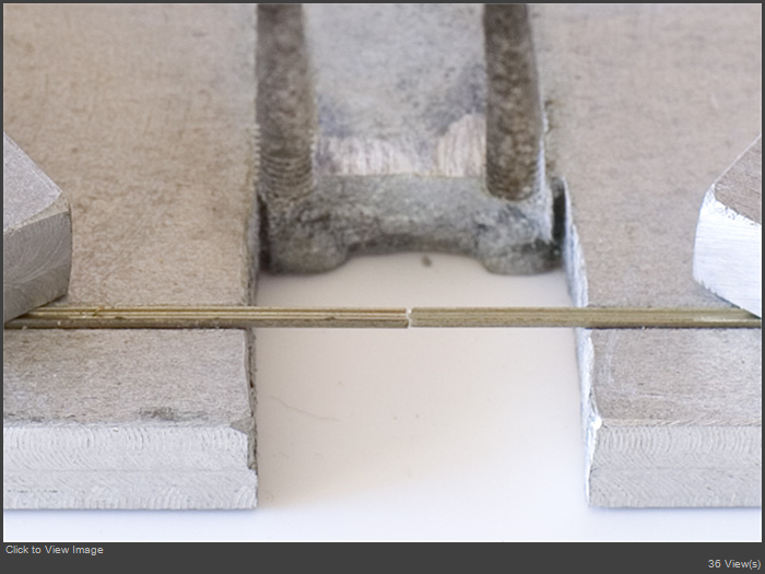

To remove any issues with rail I silver soldered the joints to have continuous "welded" rail. This is handy for uphill spirals in mountains where access is a bit more difficult.
I used a medium temperature silver solder. You need a fine point torch to direct heat and silver solder flux. Once the joint is cleaned up with a needle file you wouldn't know the joint was there.
The most painful bit is feeding the sleepers back onto the rail, but it's not that bad.
I made up a tool to hold the rail in the exact position. This is the key to making the job easy. Both ends are actually butted up together (a bit apart just for the photo). If you have done a bit of silver soldering this is a piece of cake.

It is the speed bumps. Some carriages are ok, some aren't, remove the problem.
I have regular electrical connections as nickel has 4 times the resistance of copper.
