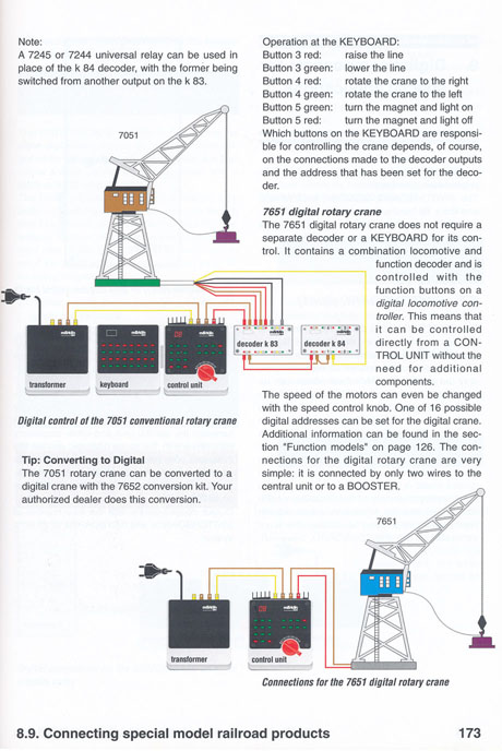

Some advice please on setting up the 7651 crane. I know that it will not work with the Mobile system , as only the light function and magnet work. The manual states that it will only work through a Central Unit/ Central Control Unit with the Control 80f as the crane controller.
I will buy the old Central Units just to run the crane but need advice on how much of the old system is required.
The manual shows a transformer, a central unit and the 80f but the 80f appears only to be an add-on. I would prefer to buy a transformer and either a 6029 or a 6021,both of which seem to have the necessary function buttons without the need for the 6020 central unit. The transformer, central unit and 6029 are available on eBay . I am not sure how the components are connected, hopefully by the usual Marklin black/red/yellow/grey connectors at the back of the controls. I presume that the multi pin sockets on the side are only for connecting boosters, which I do not need
Grateful for your thoughts.

Yes, a transformer and 6021 would work. Although I must ask why it won’t work with a mobile station?

The decoder uses an odd flavor of the Motorola protocol that is not supported anymore afaik on most recent controllers. I have a 7051 that was converted to digital using the same decoder as your crane (7652). My ecos(1) supports a specific protocol for it, 'motorola fx 14'.
The same protocol is also used on the old panoramacar 4999 with the moving waiter.
Maybe someone with a more recent controller like CS3 or MS2 can say whether it supports this legacy protocol and what settings need to be set? In any case I would not spend money on old controllers like a 6021. An ecos1/2 will definitely support it.
I do recall you need to set a certain DIP setting on the 6021 for it to output the required protocol, should you still want to go with a 6021 and your original decoder.

The transformer 6002 has the brown and yellow connectors which are wired to the corresponding brown and yellow on the control unit 6021. The 6021 has the red and brown connectors usually used to supply power to the track.
The 6021 has the plug in facility on both sides. Connection to the right is for control 80 and or 80f. Connection to the left is to the 6040 keyboard for points and signals.
John, I have a boxed 6021 here. I am helping another Marklin fan dismantle his layout because he can no longer use it through illness. Would £18.00 plus postage work for you?

You should be able to substitute the 6021 for the 6020 / 6035.
Here's some info on how to control a 7051 crane with a 6021. Other controllers should work also. I say this because you might be able to remove the decoder board from your crane and use it as a 7051 analog crane.
The picture also shows the 7651 crane being used with a 6021.

Many thanks to those of you , who offered advice on my difficulties with the crane operation. I sought advice from Marklin and their solution below works after some more lubrication and checking the seating of the brushes. It would not work on the earlier grey MS and I changed the address back to the factory setting of 30, as advised:
Dear Mr. Kelly,
the crane can be operated with any item producing a MM track signal. Please give your MS2 a try.
I think, address 80 is not the best choice as it is the last address. Please use the default address 30.
You only need F0, F1, F2 and the speed knob to control the crane. Please follow the advices in the manual.
