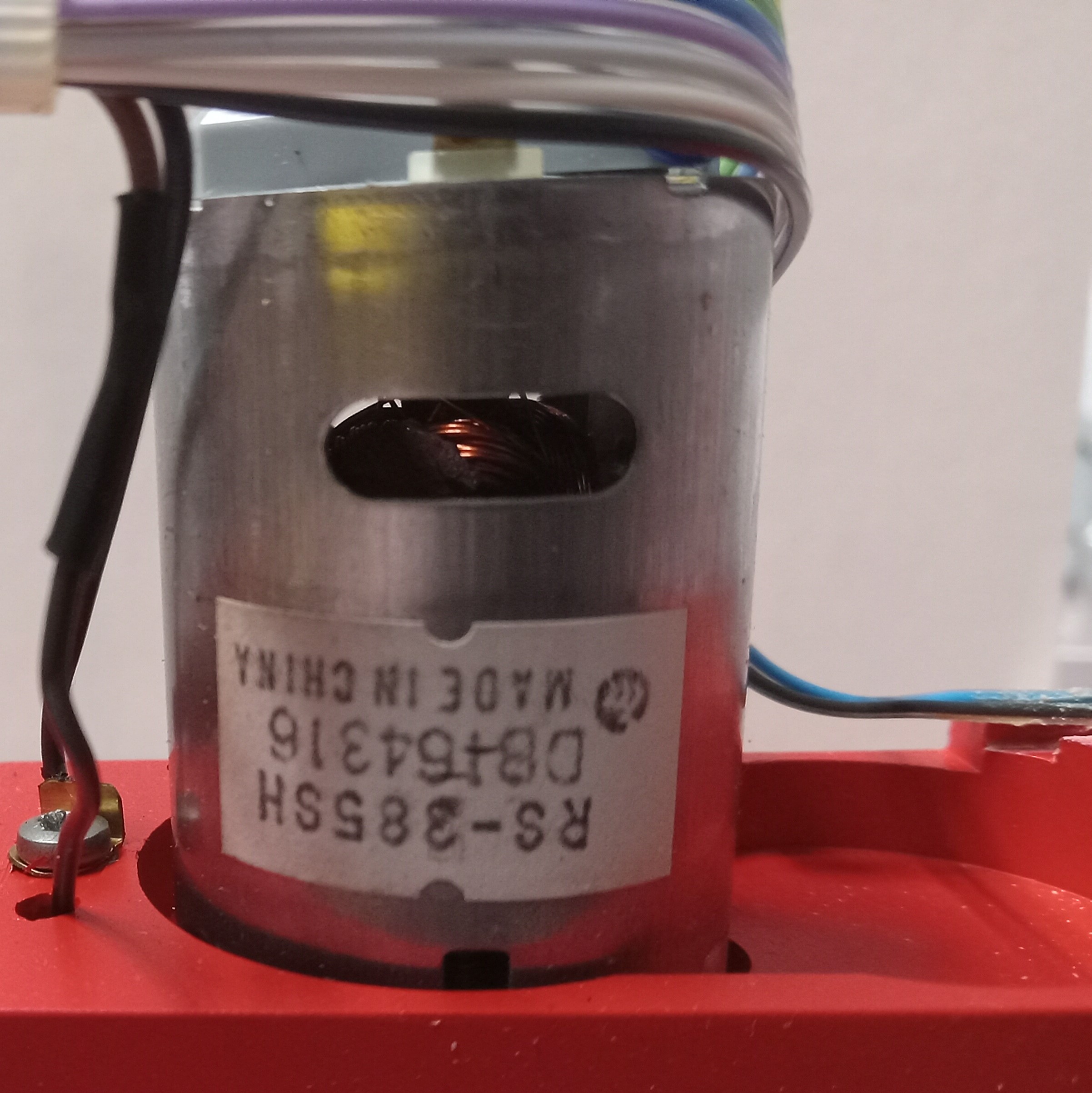

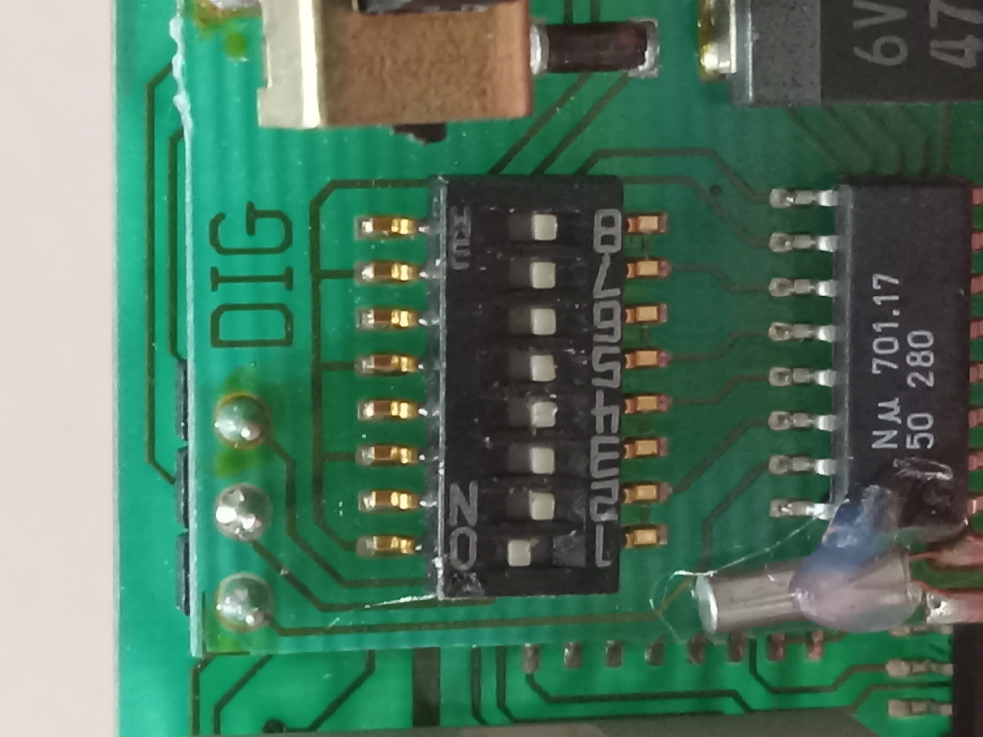

*First picture- there is a 3 position switch as shown in the positioned to the left. I can move it to the middle position or all the way to the right position.
Not sure what it does or what position it needs to be left into?
*Second picture- There is the decoder with 8 dip switches, currently set with switch 1 in the "on" position and all others in the "off" position.
Not sure how to set this.
*Third picture is of the motor in case you need to see it.

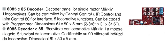

#9 Posted : 06 July 2024 19:00:45(UTC)
Posts: 3,684
Hi Todd
It looks like this decoder 6085 or C85 (here extracted from the 1993 Catalogue) but apparently it is not exactly the same
This decoder 6085 DOES NOT work on normal Märklin (MM2, MFX, MFX+).
It says it works with a specifically developped Central Control 1 an d its address can be changed by a special.
Searching how close this "old" protocol is from DCC I cannot find any valid result

If it has the dip switches you should be able to select an address per the table and then find that address with your controller. Or am I missing something?
Chris
Offline Paul59
#13 Posted : 07 July 2024 18:46:51(UTC)
Paul59
Joined: 25/08/2012(UTC)
Posts: 255
Location: South East
If you're missing something Chris then so am I.
Switch one being on and all the others off = code 78 doesn't it?
I assume Todd must have tried this but if not just create a locomotive with code 78 and see what happens.
That is also the switch position code for Delta locomotive number 1 when using a delta controller but I don't think that applies in this case.
Paul
Offline Wolfram_Stn
#14 Posted : 09 July 2024 19:34:59(UTC)
Wolfram_Stn
Joined: 14/02/2024(UTC)
Posts: 59
Location: Grand-Est, Alsace
Concerning the 6085 I found this:
https://www.marklin-user...-5501-T3-Decoder-Problem
Seems that 6085 is an early DCC decoder with register programmation...
and this makes me think that your decoder is NOT a 6085.
After a little research I found this :
http://www.web-hgh.de/in...h.de/p03_maedig_c95x.htm
I think yours is the second photo - clearly a 6095, which is commanded in MM2
So if your decoder is ok you should be able to command it on address 78, since you activated just the switch n°1.
