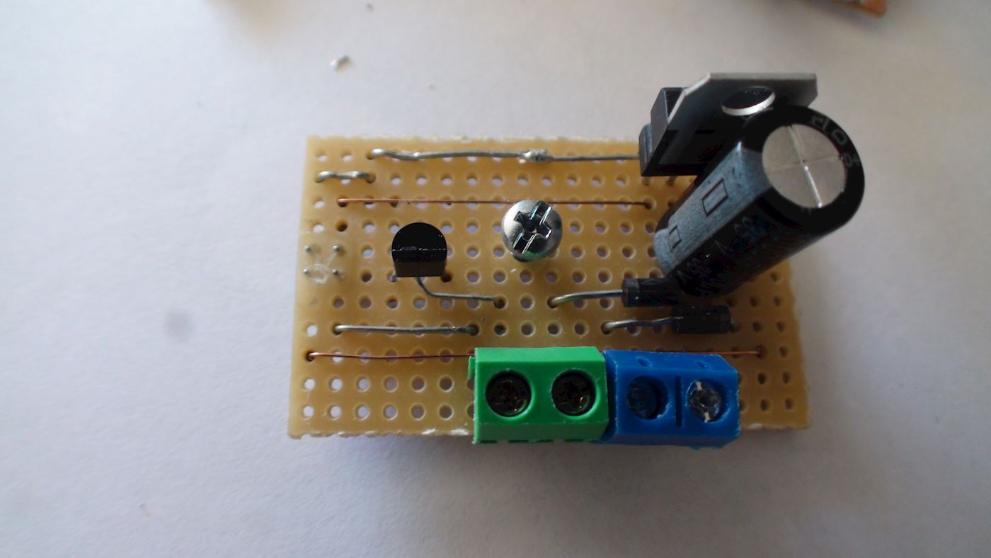

Unfortunately I can't help you with your question but I'm using reflective opto couplers, which fit between sleepers (especially suitable for K-track) and the opto coupler is activated by the slider or pick up shoe, the set up is to create a circuit board and the moment that is done its a save and reliable detection method and speed hasn't got an issue with., the height of the opto coupler can also be increased by adding more 4 pin sockets to it, I've used it all over my layout (13m x 5m) never had a failure, you could activate signals (switching from red to green), turnouts, station platform lights etc. etc.
