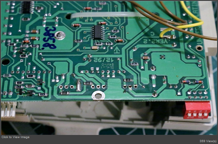

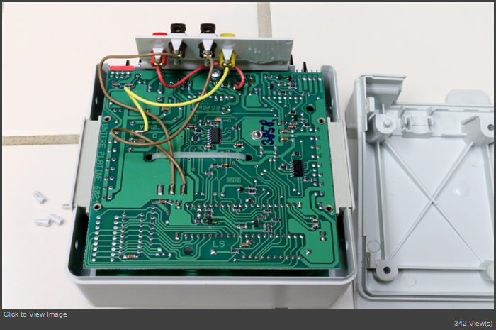

Hello All,
Recently one of my customers gave me the opportunity to repair some 6021's that were shorting out when power was supplied. I believe they may have been damaged by an improper transformer connection to the output terminals, or just failed from old age, not exactly sure, but felt it would be worth a try to fix them. Thankfully I was able to get some guidance on how to get started from here: Reparaturen. It is short and in German, so I thought for the forum I could explain and expand on it in English for those that may be interested in reviving their 6021's.
The first step is to remove the external case screws from the heat sink and the plugs that hold the case together, the two screws are easy, the four plugs, a bit more complicated:
Drilling a small hole in the center of the plug allows a screw to be attached.
Once attached, a gentle pull on the screw with a set of pliers is all that is needed to remove it.
With the controller face down, the base may lifted off. The lower circuit board can then be litfed out and flipped over into the base to access the remaining heat sink screws and transistors.
There are two black screws in the heatsink that go into the case that need to be removed before the lower circuit board can be lifted out /BDNZ
Here the challenge is getting the transistor screws removed, the circuit board in front of them prevents easy access with a screwdriver, I used pliers to loosen them. Once they are removed there is one more screw holding the heatsink to the board that needs to be removed and heat sink is off.
Now the transistors may be desoldered, take note of the values and their position for the installation back on to the heat sink. the desoldering is probably the most difficult part, take care not to damage the board or any of the other surface components when removing the transistors and solder, the thru-holes must have all excess solder removed before reassembly.
Install the new transistors in the correct orientation on the heat sink.
Solder new transistors to the board and replace bottom heat sink screw.
Reassemble Control Unit and test...
All three 6021 units I received for repair had a least one bad transistor, I replaced all three in each with new ones and each worked well upon completion.
Parts used on each: 1 x BDW93CFP, 2 x BDW94CFP, STMicroelectronics brand. Other brands and types are compatible, just be sure they are of the correct values and insulated from the heat sink.
Tools used: 1.8 mm drill and pin vise, 2 mm self tapping screw, small serrated jaw pliers, phillips head screwdriver, solder station, solder wick, solder and flux.
Good desoldering and soldering skills plus knowledge of integrated circuits are required for this repair, please do not attempt if not proficient.

#2 Posted : 13 February 2016 10:24:22(UTC)
Posts: 8,364
In my case, the buttons do not react when pushed. I figure there is a plastic form underneath the buttons which holds the buttons in place and presses down on the circuit board at the appropriate place. There may be some dust or other contaminant interfering with pressing a button or it may just be that the plastic form is not sitting properly in place.
Did you have any luck accessing that part of the unit and what would I need to do to repair it?
When I have seen similar issues on TV and VCR remotes, they were usually done for.
Offline 3rail4life
#3 Posted : 13 February 2016 18:21:48(UTC)
3rail4life
Joined: 23/12/2011(UTC)
Posts: 426
Location: Northern California
The controls are on a second board which attaches to the top of the case, it is accessible when the case is open but I did not wish to disturb any of the buttons, I left that part of the unit in place and can not advise on the disassembly.
Interestingly, the article I referenced for the case disassembly, Reparaturen , also shows how to repair a TV remotes keys, not sure if the trick works with the 6021 though.
Gordon
thanks 1 user liked this useful post by 3rail4life

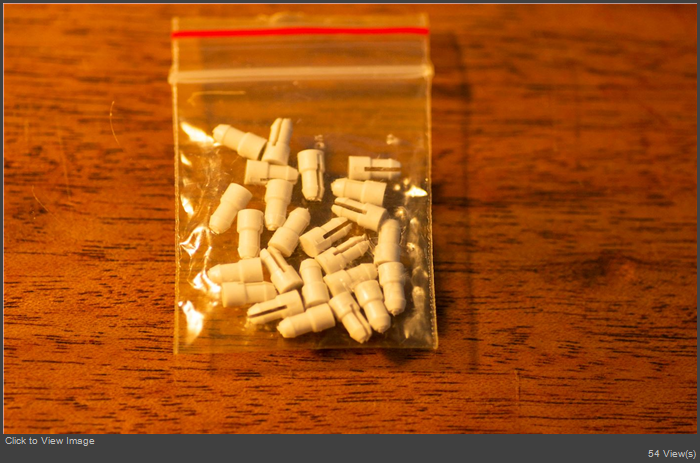

A bit more information about the repair of the 6021.
The replacement 6021 housing pegs are available from Marklin.
Do we have a part number??
However you may need a Marklin customer id to obtain them.
The 6021's I get in for repair can be finished off nicely with these, back to original.
The graphic is attached which will also help in what is actually being extracted.
This would apply to the current analogue controller dismantling as well.
David

You don't have to replace the pegs if you only make a small hole in the pegs (and don't destroy them). The Intellibox is using a similar construction to lock the casing.
I drilled a 2mm hole, just deep enough to to get a thin screw just a bit in it. After pulling out the pegs you then can reuse the peg.

Yes, and white plastic sprues from model kits also fit the holes. Just cut off the ends after reassembly.
