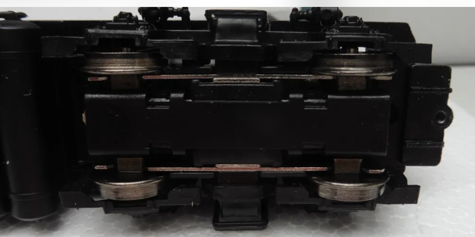

With the GP9 I discovered that there is no reason to unpower the other axle on the pickup shoe bogie. The pickup shoe can be installed in the middle so that the knuckles at the ends will go over the ends and work like a magic. And they must, because othervise the depth will not be enough. This job involves a hobby knife, a little piece of sheet styrene (to make a floor for the pickup shoe) and superglue. And of course the pucnup shoe. Choose 206370 for the extra flatness. It’s about an hour of job to do it…. Maybe more on the first time around.
Look for a model that has a bogie that looks like this:
With this discovery I came to realize that the DC wheels do not need to be changed to Märklin wheels. Changing to Märklin wheels made the GP40-2 axles eccentric, which led to bangging/rattling running noise. The GP9 runs very well on C track with the DC wheels and does negotiate all turnouts and R1 curves. Also on straight K track. I’m going to change back the DC wheels to the GP40-2. Just make sure to narrow the inner flange distance to 13,8 - 13,9mm. It’s important!
Also these things have massive tractive power as they are so heavy. With four axles at least. Three ain’t quite enough. So no traction tires required.
I’ll be making more videos when my Loksounds 5s and 21 MTC boards arrive.
