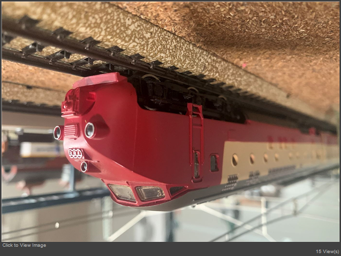

Hi all
I have run my 3071 before - but that was over 4 years ago!
Today i took it out of the box and eventually got it all connected. First issue I noticed was the shield for the connector on the power car was too low and catching the puko on points. - Sorted. ThumpUp
But then I noticed no front white light on the power car and it will not reverse.ThumbDown The dummy power car has a red light on all the time.
I checked to make sure the connections are the same throughout, in my cae making sure the red wire was on the top of each connector. Still no front light or reverse.Confused
Are any of you learned marklinists able to give me some idea as to why please.
I am running it with with a 4071 car.
Many thanks

Well, right off the top, it looks like you are running it upside down ;)
