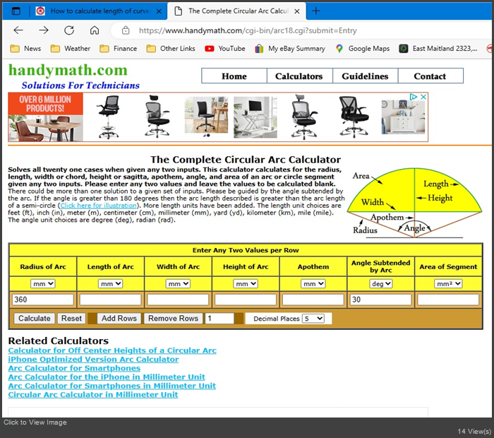

I use online calculators like the one below when designing 3D bits for my layout.
Load up the radius of the curve and the angle and hit calculate. This one defaults to measurements in feet but it is easy to select mm.
https://www.handymath.co...n/arc18.cgi?submit=Entry
Answer looks like this -
thanks 1 user liked this useful post by revmox
Oh great, I will check these out.
Thanks revmax!
