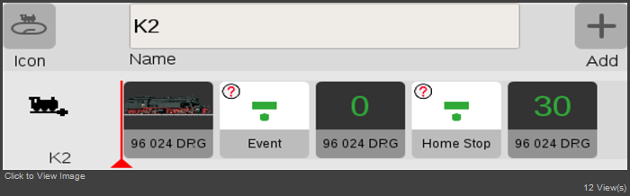

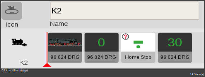

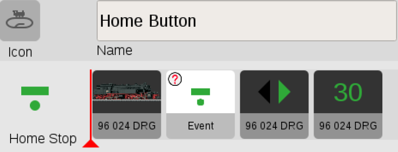

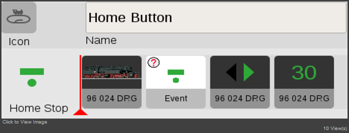

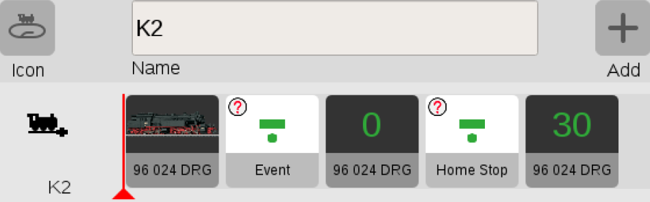

Hi Greg,
Assume there are Contact Track K1 at midway stop and Contact Track K2 at home stop. Also create virtual Article "Home Stop Button".
Create event "K1": when train arrive K1, its speed changes to 0 and delay 10 seconds, then resume speed 30 to move.
Create event "K2": when train arrive K2, its speed changes to 0 and delay 10 seconds, on condition that "Home Stop Button" is green, train will resume its speed 30 to move; if before train arrive K2, "Home Stop Button" pressed and changed to red, train will not resume moving and stay at home stop.
Create event "Home Button": when "Home Stop Button" pressed and changed to green, train will resume its speed at 30 and departure from home stop.
Above are simple events to achieve your work, you may enrich and make them much better.

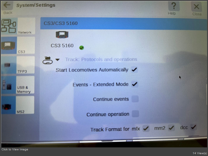

Hi again,92BF2AC3-1299-4E65-8CBA-77408065BDC4.jpeg78662A4C-EFC5-4661-AA3B-5FD1828BDCF4.jpegCAE26053-6ECE-4A07-9149-C02A640DE381.jpeg
Just in case… to provide some more of detail:
In settings I have this set:
So events will run only once if trigger.
Here also an example of one of small umbrella event, with the light (virtual direction) as trigger. And to finish the view of the track plan, where you can see the ‘lights’ as well.
