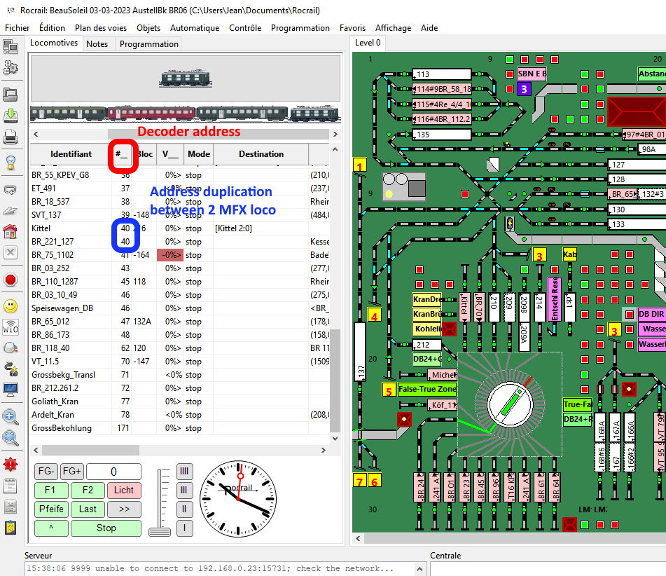

@rhphil, Miguel: agreed it does not happen very often but it happened to me with a CS3 3 days ago. I have more than 30 MFX locos and the MFX registration starts at 5 and uses almost consecutive numbers with the highest being 47.
I have this registration on close surveillance because of my connection with Rocrail (must declare the protocol and the # for each loco) and a number change does go un-noticed.
Evidence of this is all my numbers being contiguous with 2 address gaps (of 1 address and another of 5 addresses)
I recently added a new loco (digitalized Kittel while another was in the box (BR221), used rarely, so the Kittel was given the address of the BR_221_227 because it was absent
This this additional to what happend to me 3 days ago for which I have no picture.
When this duplication happens (one older loco remaining in its box) then both locos show on the CS3 the same address BUT the newer loco can be used (fresh address) while the older one is "frozen" (inhibited) and a lost MFX loco must be started with all locos on line to be successful and the "old" loco being assigned a new number.
So, not so rare after all.

This is your opinion that I respect. What I have is what I observe and can demonstrate.
The simple fact that all addresses are starting from address 5 and are almost perfectly contiguous (in my case with some new additions and some destructions of decoders) demonstrates the fact that the algorithm assigns a number to the lower values and sometimes REPLACING older addresses of destructed decoders or locos remaining in boxes (I have 2 obvious occurrences). Assigned numbers could have expanded without trying to reuse existing addresses. After all the available number go up to 4096 I think.
I have juggled MFX registrations between my two CS2 (60215) one of which is now failing, my CS3, my MS1 and its special rail and PSU, my MS2 and its trackbox. I seldom use my CS1 (60212) which has never received any update since 2007 or so.

Hi Jean. I do not doubt what you say but as you are using software other than Marklin would this not make a difference.
I can have a loco unused for a while and even after adding new locos the old loco runs with no problem with the same address as before.
Could it be there are different decoders which may cause a problem. Also with mfx turnout decoders I have not known any duplicate address even when replacing turnouts and decoders.
Maybe others have a similar problem and if Peter is on he would probably explain why this is happening to you.
