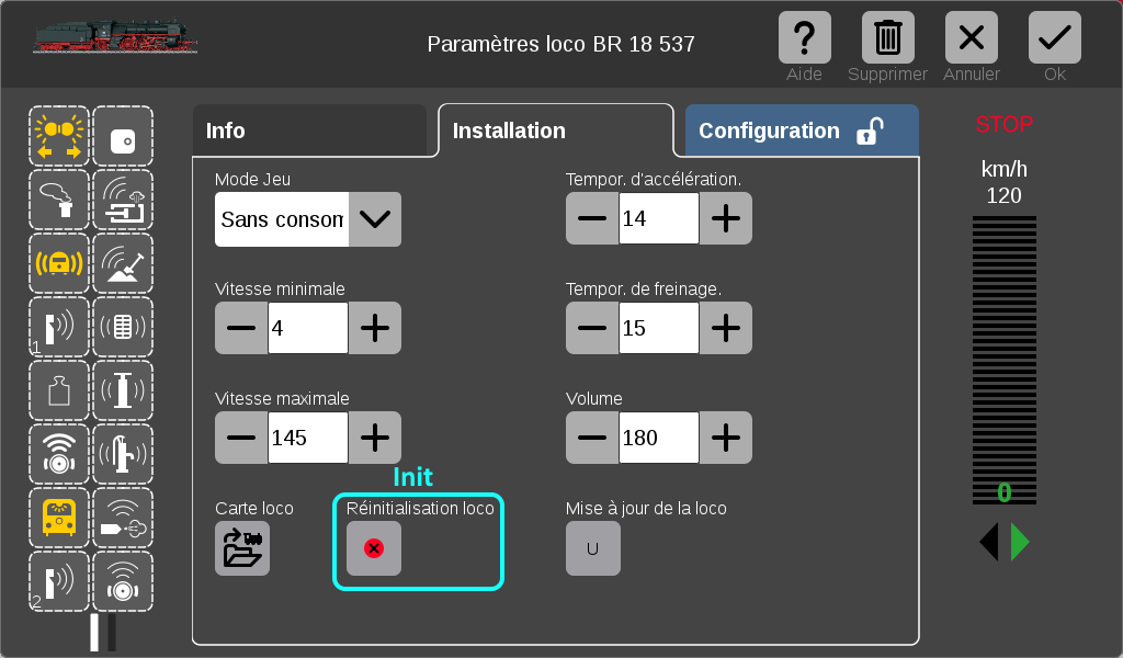

Hi Eddie
When in doubt on a Märklin loco then perform a factory reset (CV8=8)
ATTENTION: to perform the reset, the loco must be powered by the program track AND must be alone on this track
On the CS3 it gets even simpler
1 - edit locos
2 - Select the loco
3 - on the middle tab, select the Init (or Reset) button while the power is on (the STOP bar is off)
4 - wait until finished
Indeed using the mapping fonction on a MFX loco, you may assign to one key (F5?) a lot of function together and a Reset clears this
What is the risk of reseting an MFX loco? None really but:
- the sound may come back in full force as per the factory adjustment
- the speed curve and maximum curve may be changed as per the factory adjustment
- fonctions may be changed to the factory status
One thing you write bothers me is "Unfortunately I’ve had 2 other locomotoves do the same thing except they went a bit crazy".
One possibility is one piece of track in your layout is causing problems (e.g.: an RF noise suppressor module like the 74046) that may distort the digital signal.
In this case take a couple of tracks connected directly to the CS3+ while the layout is not powered and see if the same happens

I belove JohnjeanB is right.
the reset probably resets the decoder back to the last programming. and a full programming writes over everything. (if i remember correctly)
However, when a decoder is programmed from a PC through a cs3, it seems like a temporary copy of the project is stored in the cs3. and if something fails during the transfer/programming the "original" project is restored.
this happened to me when I did a reprogramming of a factory decoder. checked the decoder and it was ok with the original sounds and settings etc. and the next attempt was successful.

I would be extremely surprised to find a sound file replaced by a CV8 reset. For one, the downloaded sound file REPLACES whatever sound file is already in the decoder. It then proceeds to set up a dose of CVs related to the sound file, and I would expect, like the current default action for Loksound decoders, that these CV values would become the defaults for those CVs.
It sounds to me like you had a decoder which had motor CVs changed after a sound file was loaded, perhaps by doing an autotune (which would be how I would attempt to reinstate them if this happened to me).
