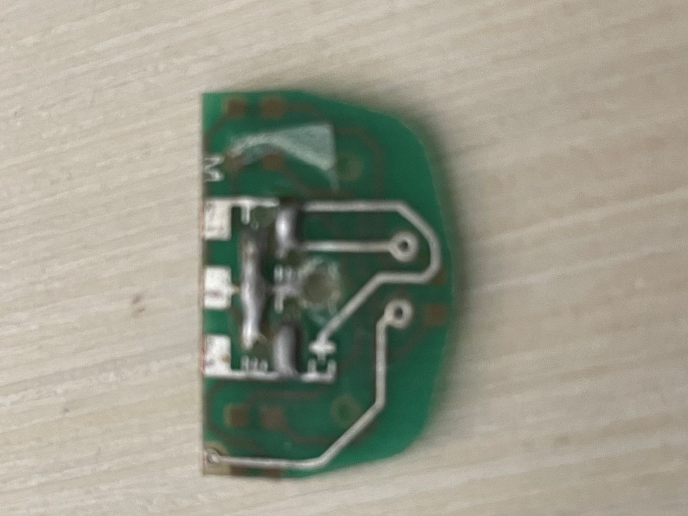

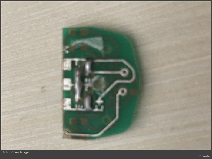

A 36xx loco would have left the factory with a 6080 decoder, but if (as you state) it has LED lights then I would suggest you check the decoder hasn't been updated by someone. If it has factory fitted LED lights then the required resistors may well be on the LED circuit board.
Just checked that. See the pics (sorry for the one blurry one.
They are led’s indeed. But now I have an issue. The lights don’t work anymore when I put it back together. Fun project for a cold Sunday afternoon. I assume that the contacts don’t touch the frame contacts anymore. But just a guess. Any suggestion on how to test that easily before I put it all together again? First a cup of coffee though before I start looking at this.
Yes, those are definitely LEDs. I suspect that they may be what I would term '12V LEDs' that have an internal current limit resistor. This may well be why the solder blobs on the back of the PCB exist, it is hard to tell because it is blurry, but I think they are jumpering pads where SMD resistors could be mounted.

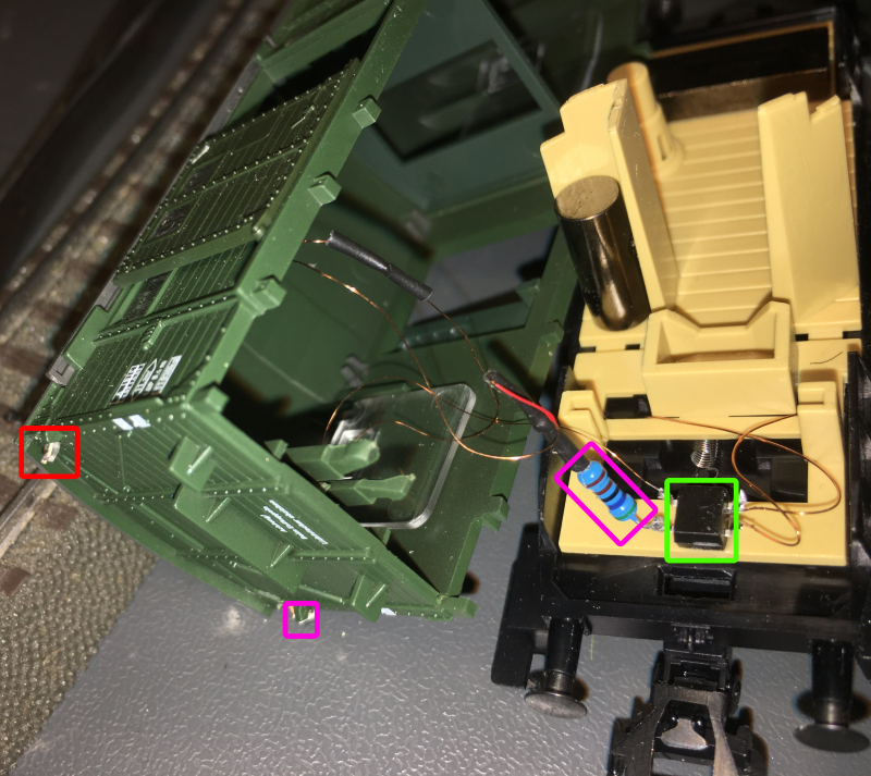

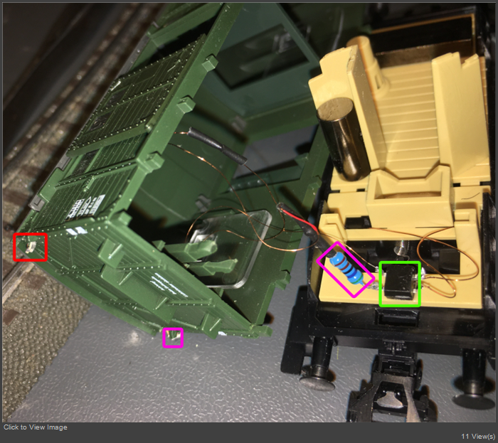

Originally Posted by: MarcelV Go to Quoted Post
I know higher wattage doesn’t do any harm but they are just larger in size, taking up more space.
Hi Marcel
More and more I use less than 1/4 watt resistors because sometimes there is simply no space.
One example: this BR 98 with a very small cabin that host the motor, the weight, the gears, the decoder, the reistors, the loudspeaker and 2 bi-color LEDs
So it was very cramped
Here is another example of small space in a "Begleitwagen" to add interior lighting and rear red lights
In this example
- circled in green the SMC full wave rectifier
- circled in red: the red LEDs
- circled in pink: the huge 1/4 W resistor
So I am starting to use surface mounted resistors
