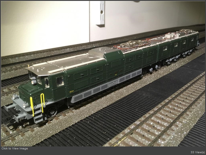

In 2006, I purchased a Märklin 37593 SBB Ae 8/14 as 2nd hand on eBay.de. A great and heavy engine, but I was never happy running it on my M track layout, as it was derailing on some turnouts. Now, on C track, I don't have these problems, but the two motors didn't sound very nice, and the decoder was loosing memory from time to time, as it didn't remember the last engine direction. I thought this should be a Märklin 6090 decoder problem only, but googling the issue, of course this is also a problem with the custom Märklin decoder in the 37593... Confused
However, there is always a solution on the Net: Change the decosder! Crying

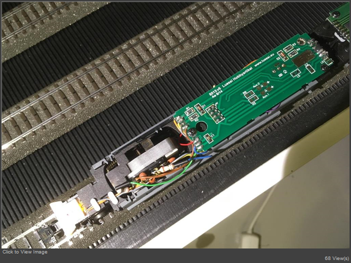

This isn't that easy (for me), as the engine has two motors, LED:s and of course Swiss lightning. Finally, I found a circuit board on Luessi.ch - having the same size as the old decoder - that solved this challenge! Adding an ESU Lokpilot V4, now also the two motors are in sync, and the Ae 8/14 is running much smoother. Cool

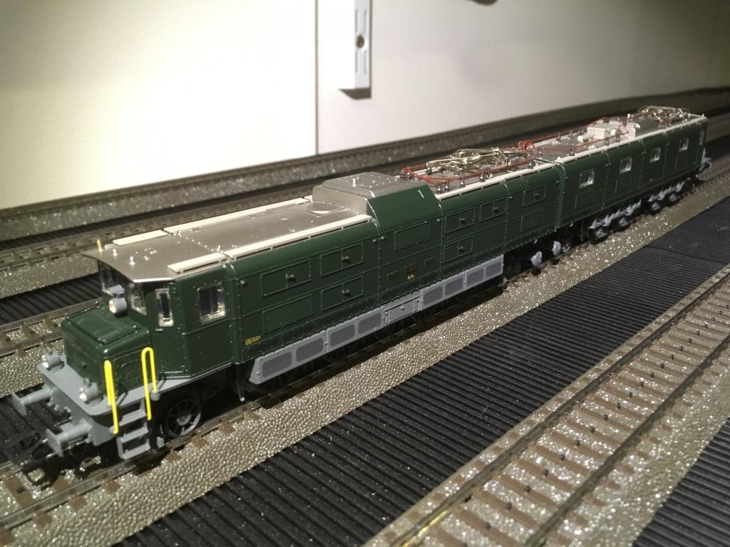

See below pictures of the newborn and proud SBB Ae 8/14!

Your item shows the 8015v6 in the photo but the 8015v2 looks more like what you installed due to additional items attached to the board. Did you add the additional items to the v6 board?
Could you please supply details of you installation, I have never installed any decoders other than those available from Märklin. Also due you need to do anything special after installation other than having it be recognized by the Märklin CS3+?
