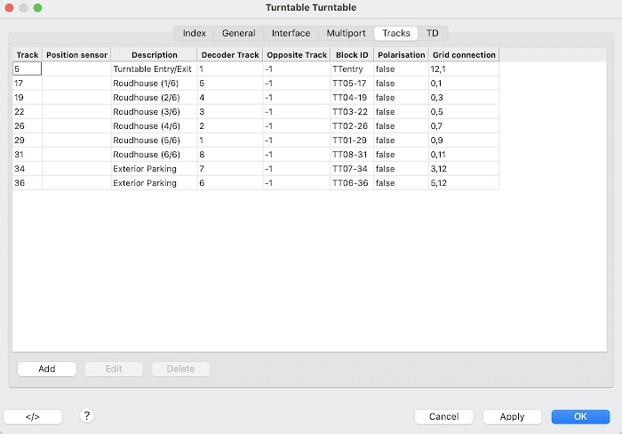

- the TT track definition looks like this
The key is to decide where is your Track 0 on your TT (this will be the reference for RR). RR order in COUNTERCLOCKWISE
Also key is, for each line to make a correspondance between the track # (from 0 to 47) and the order to be sent to your decoder 7687
The position sensor can be skipped with a simplified decoder

I have already the TT working with the 7687 in my layout with a CS1 (programmed in a 6021/6040 before, however i think that i should be able to program it on the CS1 with some work.
I'm now trying to make a correct Rocrail configuration.
In Rocrail you have to decide or set:
- if the bridge block is embedded or not (not in my case). This means that somewhere on your plan, you need to add a block named DS1 with its one sensor in your case
I'm not understanding exactly what this means. The wiki is not very clear also. If i use the bridge with a s88 (connected to one of the B of the decoder) that means ia have an embebed block, am i right?
One important thing to remember is that the command is incremental. Meaning: for the first use the position must be manually set on the bridge (pushing the black lever towards the center of the bridge and rotating the bridge to its RR position.
This is the little I know about using a 7286 TT with Rocrail
In the TT i have the tracks programmed, now in rocrail i have to adjust those memories to the position of the tracks in the track layout by using the TT -> Tracks and them fill in the "decoder track" for each track?
Thanks Jean.
Pedro.

#21 Posted : 05 June 2022 00:14:48(UTC)
Posts: 3,580
Hi Pedro
Embedded block (in the TT)
When you right click on your TT symbol, in "general" tab on center left you don't click on "embedded block"
RR wiki says "The turntable itself act like a block object and does not need an external bridge block."
So I selected to have a block represented separately with its sensors.
You wrote "in the TT i have the tracks programmed, now in rocrail i have to adjust those memories to the position of the tracks in the track layout by using the TT -> Tracks and them fill in the "decoder track" for each track?"
I don't know much your decoder but what is key is:
- to pick a track 0 (your choice) and then going counter clock wise, you have tracks from 0 to 47
- what RR wants to know is what code your TT decoder is expecting for it to drive the TT to T1...T47
- For RR to understand and get this info, you must fill the Track table" and especially the row "decoder track"
Lets take an example track 1 is the first track for your decoder (RR calls it Track 0)
Because you are not using all the tracks the next used track for your decoder is Track 2 but it is located on Track6 of you physical TT , so you write on line 6, in the field "decoder track" the value 2 (it is track 2 for your decoder) and so forth for all tracks you use (generally much less than the 48 positions.
I hope this helps

Hi Pedro
I hope this helps
Yes, that's what i thought, make a "map" beetween the configuration and the Rocrail Turntable symbol.
I think that it's becoming functional (block names temporary, they have the original decoder address and the Rocrail TT position). Sensors still missing.
Configuration:
TT Config #1
TT Config #2
Pedro Rosa.
