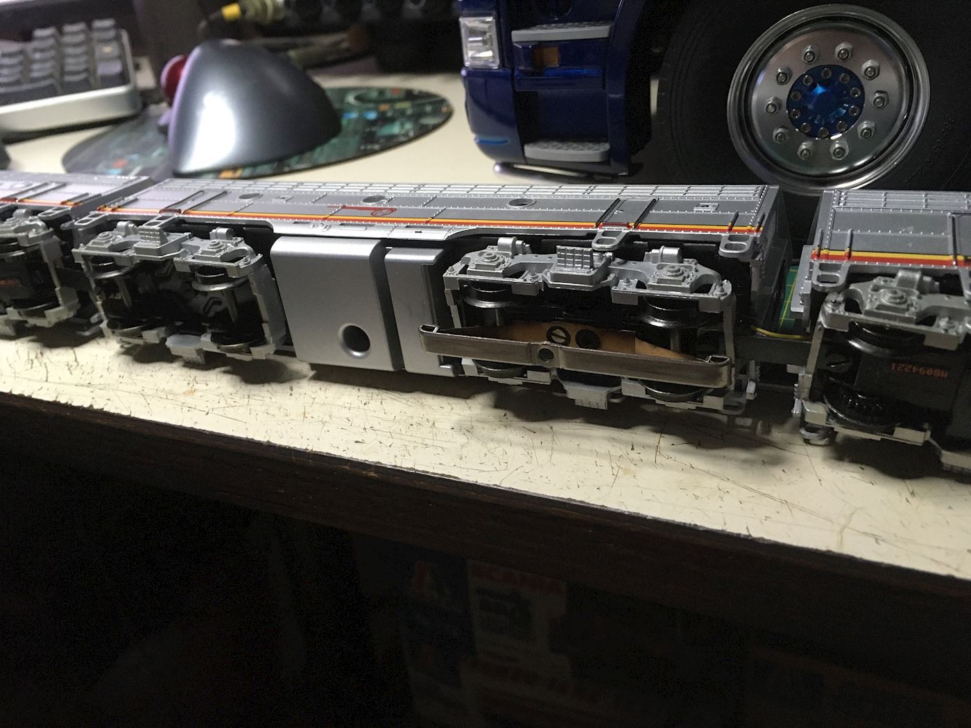

Here you go...
That is a good point!
Looking at pictures i found a Santa Fe #3362 that came with a similar set up as mine (A-B-A and slider on the B unit), but the slider seems to be shorter on that one, the booklet on the # 37622 states the slider should be # 7185, same as on mine.
When i push the slider up i don't think it would touch the axles, but bend edges are very close to the front and rear brace of the wheel boogie.
I am going to try to insulate those edges with insulation tape to confirm this....
Otherwise, a shorter slider would be the solution??
Jean-Pierre

Unfortunately I buried all my F7s somewhere and thus cannot verify the slider positions or lengths. However, according to the Märklin 37622 data sheet, the slider is under the F7A front bogie and not under the F7B. When Märklin equips a F7B with a slider, at least one axle has an insulation around the axle to avoid a short circuit. On your photo it seems as if none of the F7B axles of the truck with the slider is insulated. Therefore I guess you have procured a kit-bashed version. Independent from the slider length you should wrap some electrical insulation around the affected F7B axle(s).

The number in the front lights is "339", so it looks indeed to be a kit-bashed set based on #37622 and a second A-unit.
There is indeed no insulation around the axles of the B-unit and looking closer to the truck with the slider i just found also that the head of the bolt used to connect the permanent coupler is quite long, M*N shoulder bolts #75303 were used (found a bag in the #37622 box), there is also a possibility that this touches the inner corner of the back side of the slider....
So i have some insulation work to do this afternoon to see if i can remedy the fault!

Alright, the short has been repaired.
The shoulder bolt used to make the permanent connection from the A unit to the B unit did not sit right thru the assembly surrounding the truck. I widen the hole a bit so the bolt could pass thru the way it suppose to be. The bolt as high enough now so the slider corner does not touch it any more.....
