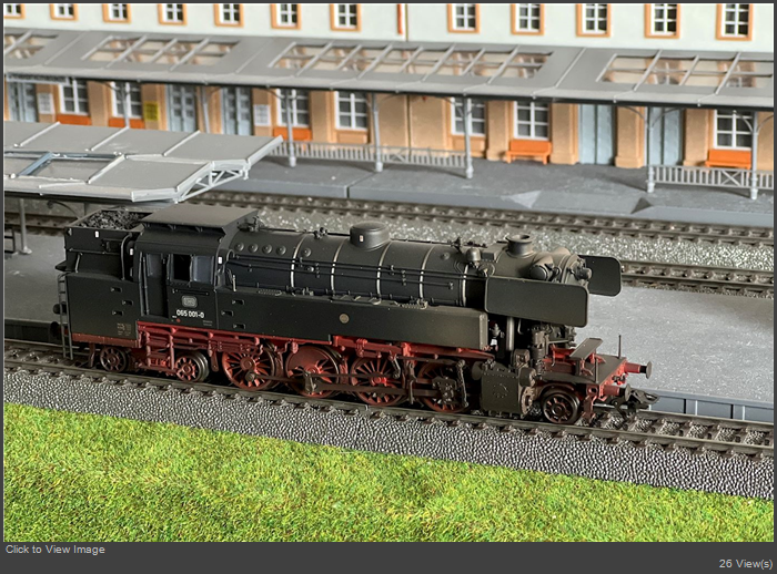

Märklin 39651 first impressions.
The DB class 065 steam locomotive has been weathered from the factory. There is a similar model 39650, which was released as an insider club model in 2018. The main difference is that 39650 was not weathered. The 39650 is an era III model, while 39651 is era IV.

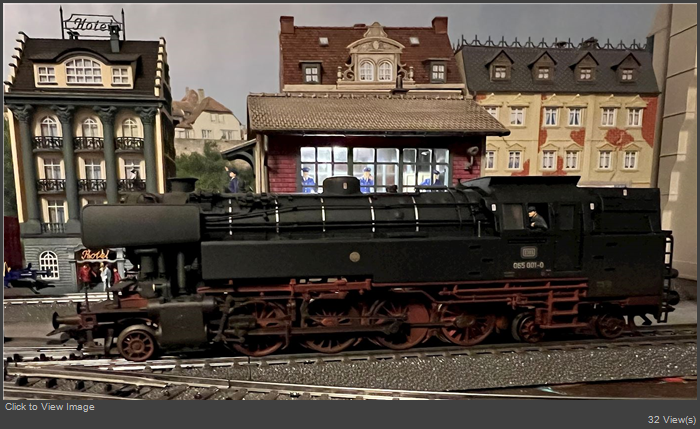

The weathering looks realistic, and is quite good for a series production model. The only real issue was the uneven wheels weathering. This could be improved by applying som Nuln oil though. There is more dirt at the front of the locomotive, and the amount is gradually reduced on the sides going backwards.

There are three headlights, all weathered, and three rear lights. Two of the rear lights can be changed to red marker lights.

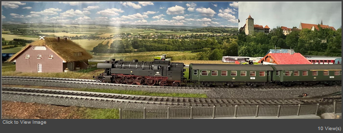

The model performs well after running in the model, and it has no problems pulling the three cars from the set 43990 at 3% uphill slope. The cars are not weathered, but look good together with the locomotive anyways since the weathering of the locomotive is mild towards the rear.

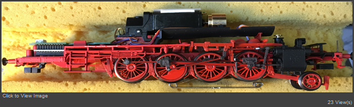

I have the previous insider version 39650 and the running is very quiet. Usually when a loco of this type is noisy, this may be caused by the motor not resting fully in its bracket.
Here it is once opened

Hello. I checked. The motor was sitting tight. But, I pushed down some grease toward the gears. Now it is more quite, but I don’t know if it was due to the grease, or simply running it in.
