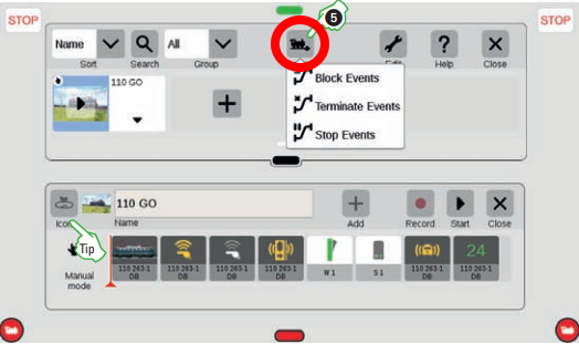

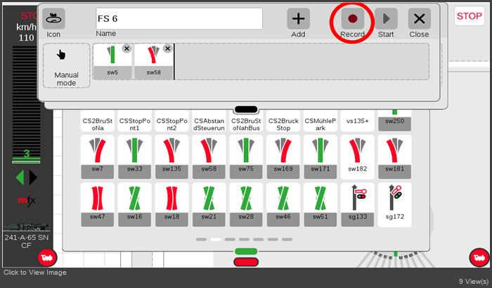

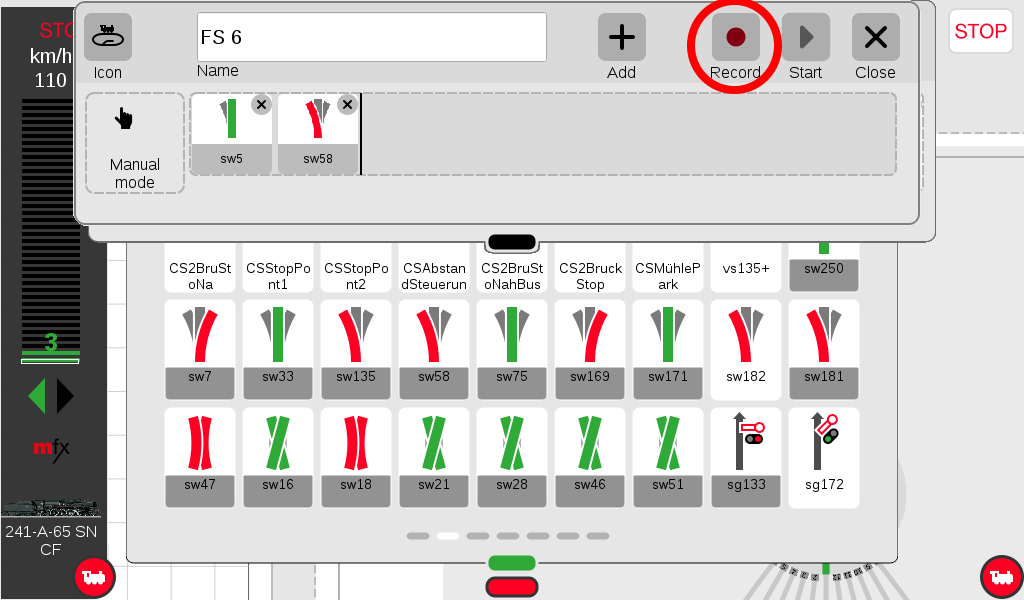

- on CS3 events, you may create a content either by drag and drop or by starting to record a sequence of manual commands and when you stop recording, the event record will reflect the commands with the delay (the time you took to go from one command to the next
- when you edit an event, clicking on a command, in extended mode (I think) allows you to see a timer you may set as you wish for the next command
