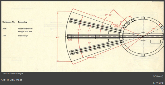

Märklin Br53's lenght is 31,4-35,5cm depending on which variant we are talking about.
Here are 7028 and 7186 dimensions.
I haven't got a Br53 so I can't check it. At least you can use the "drive through" track, but I guess that the shed doors can't be closed.
