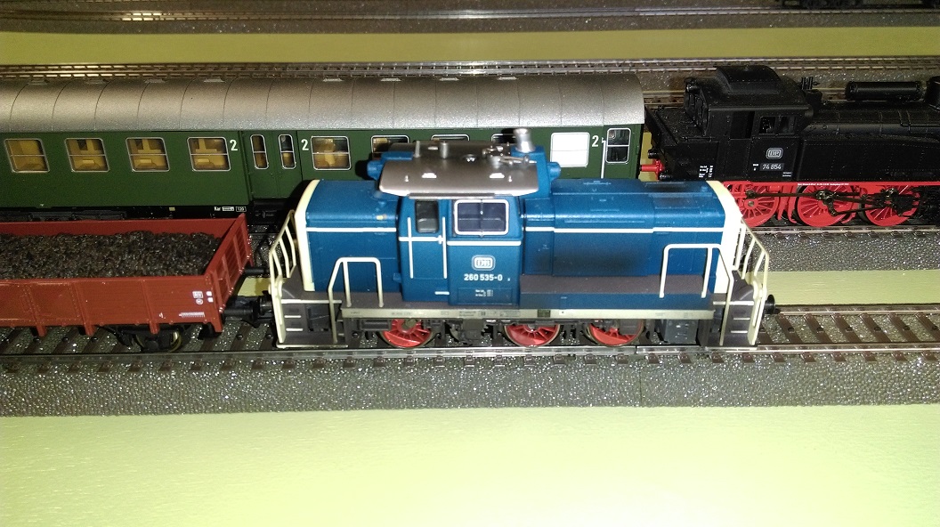

I bought a little class 260 diesel shunter a few months ago and have had some serious grief with it.

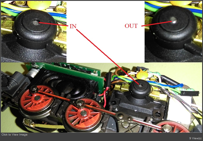

Eventually worked out the motor was locking up solid. I noticed that when the motor shaft was "out" the motor could not be turned (see picture for what that means). Pushing it "in" with a small screwdriver fixed it and shaking it around achieved the same thing.
I assume that some part of the armature was fouling the brushes or surrounds.
Fitted a 0.5mm washer to end of the motor shaft to keep it 'in" and it now seems cured (old VCRs are a great source of small bits).

Initial suspicion would be a slight manufacturing issue. Either the armature is defective, ie axle length or the gear length, or possibly chassis or bearing plate slightly out of tolerance. Gotta be something mechanical.
Only way you could determine 100%?would be comparison with another identical but non-failing unit and measure all the possible dimensions.
If we had others reporting the same thing it could be interesting to do.
But I think your work-around is an easy and probably long-term solution.
Well done and good diagnosis
