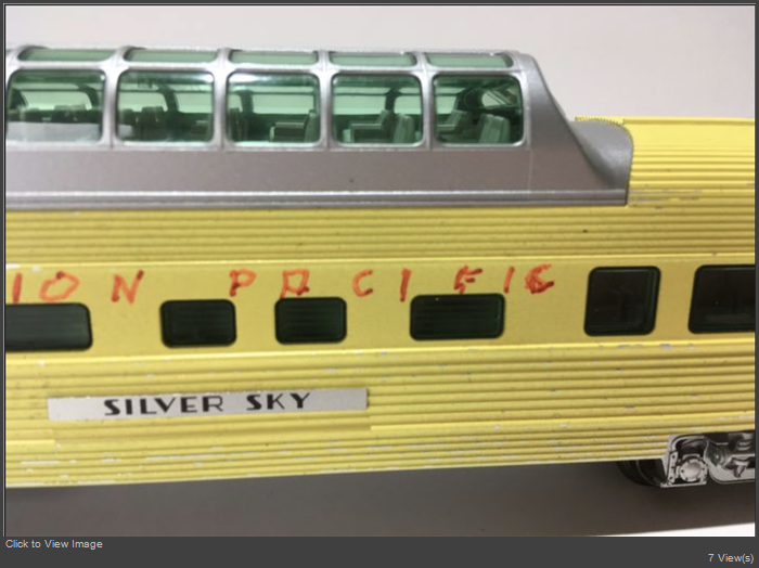

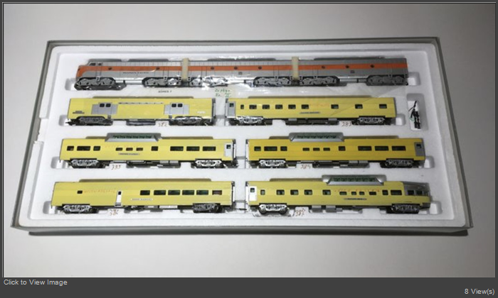

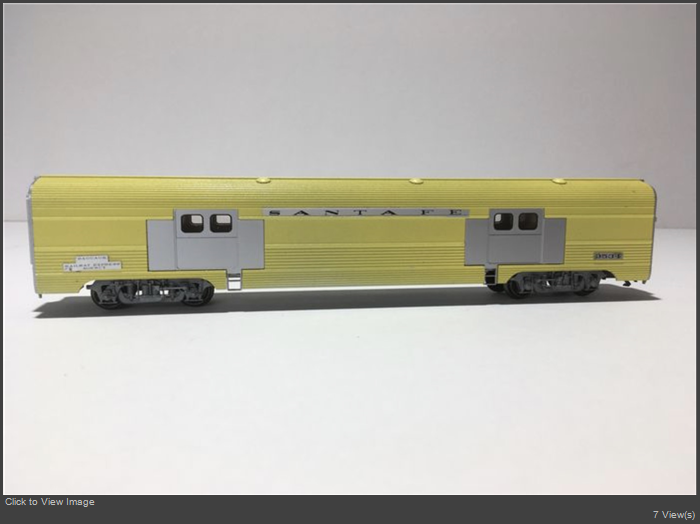

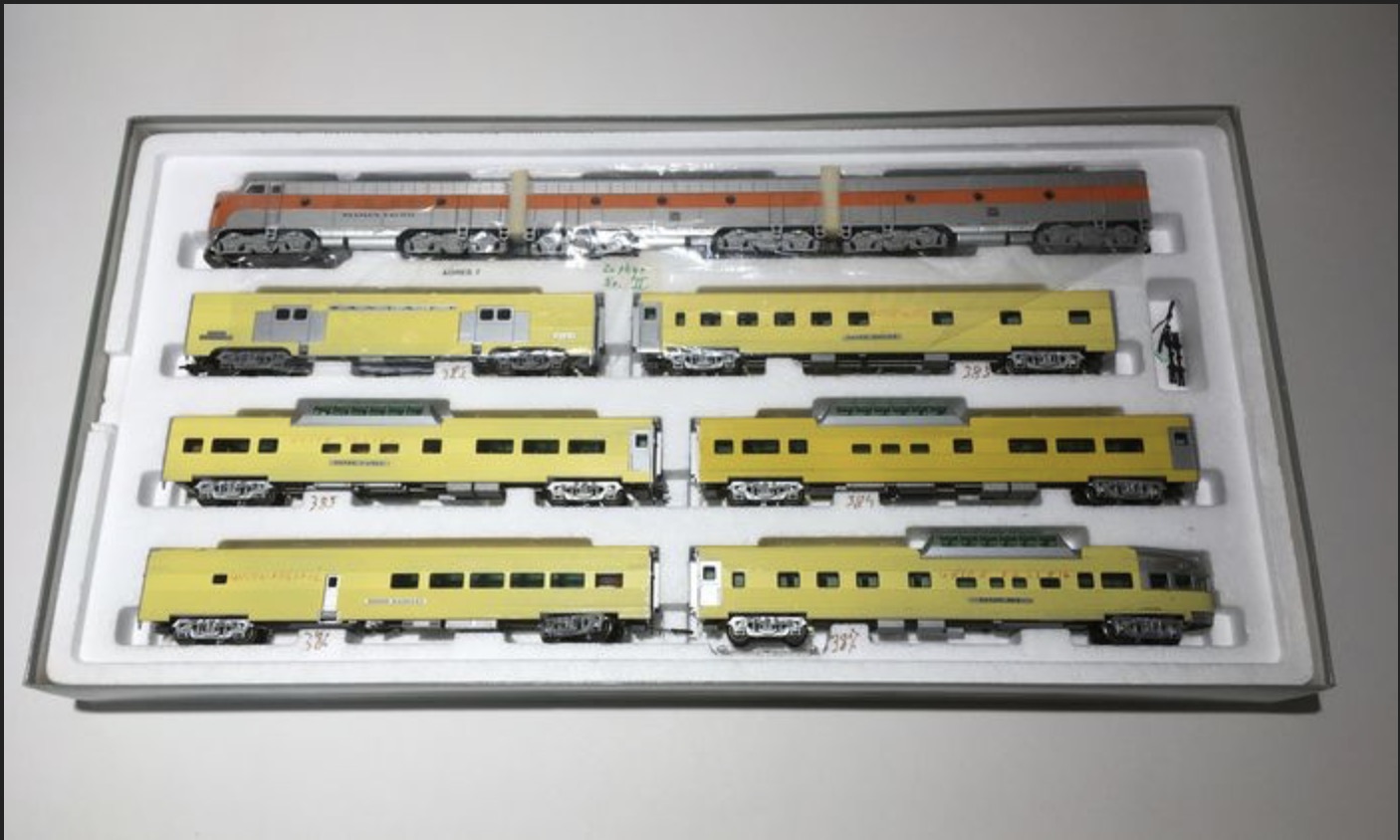

And for an example of what I was talking about with the start of this thread, maybe some of you also came across this recently:
Screen Shot 2021-05-06 at 9.32.06 PM.jpgScreen Shot 2021-05-08 at 11.50.21 AM.jpgScreen Shot 2021-05-08 at 11.52.01 AM.jpg
Someone clearly wanted a UP set in the days before M* made one, so they went and made their own!
