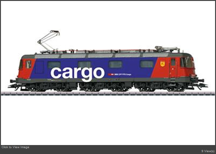

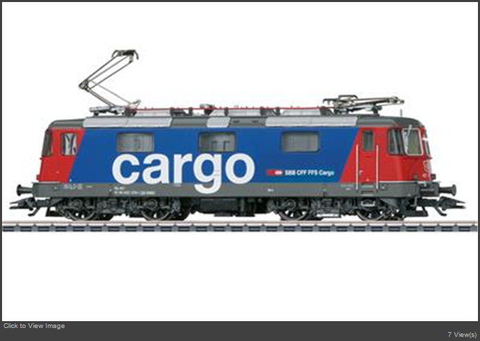

After taking advice from the group I have now bought a SBB 421 CARGO 37340 BigGrin , I decided to use it in a combination with my SBB 620 CARGO 37327 to make A 10/10 . So I created the MU on my CS3. Chaos, the locomotives did not go the same direction or one did not go and the other did.
maerklin-sbb-cargo-re-421-378.O4W_eXzJNt7F23_xE5kdHw.AIK.B.jpgmaerklin-sbb-re-620-011-7-cargo-rueti-neuheit.hWmTVbSZM-LN_JGK0mI-1g.AIK.B.jpg
I have a linked CS2. The MU was passed to the CS2 on setup, and I tried using the MU on that. Worked perfectly.
I have done something wrong on the CS3? Does anybody have an explanation ? Is this a general problem ?
Confused
Tim
