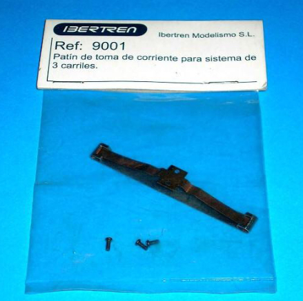

Yesterday I received my first Van Biervliet loco, a 'reeks 62' diesel (VB-9118.05) to go with the M2 pushpull carriages I ordered (Marklin 43542). This is a typical consist I could see often where I live until 20 years ago.
Now there is a problem with this loco, the slider does not seem to have enough playroom, and on switches and decoupler track it has a tendancy to lift the bogey up. When running extremely slow the loco can get stuck on elevated contact studs, and when running fast it jumps up and sometimes derails.
As I really want to keep this loco, I would rather want to fix this issue than send it back. For this purpuse I am looking for an extremely thin slider to replace the existing slider with. The replacement needs to be ~40mm in length. The mounting of the original slider in integrated into the bogey cover so some improvisation to mount it will be required.
Any ideas/tips/order codes?

Posts: 5,969
Ibertren art. 9001 is very thin. However, I neither have exact dimensions nor do I know if it is still in production.
