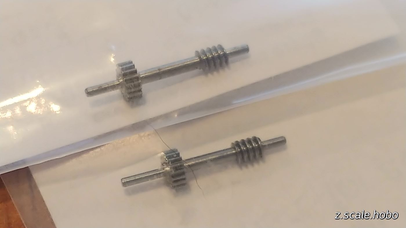

Offline zscalehobo
#10 Posted : 28 March 2021 18:29:51(UTC)
zscalehobo
Joined: 22/01/2014(UTC)
Posts: 186
Location: CALIFORNIA, Irvine
I've heard that 226940 / e226940 might be the replacement part. Search "antriebswelle" ...

Offline angiea
#11 Posted : 28 March 2021 18:56:07(UTC)
angiea
Joined: 24/03/2021(UTC)
Posts: 12
Location: England, Cheshire
https://www.ersatzteile-...-mit-schnecke-br-50.html
Thank you for this information. It certainly looks the same. Unfortunately, they do not post to the UK, but I've sent a message begging them to let me buy one ( and asking if it is definitely the same part.)
Angie.

Offline zscalehobo
#19 Posted : 29 March 2021 21:00:19(UTC)
zscalehobo
Posts: 186
Yes. A few things about the part numbering system.... 26187 is now 261870 ... When the main offerings went to 5 digits (locos etc - 8816 old rail bus - 88167 new railbus) the spares went from 5 digits to 6.
The E sometimes appears in front ... It's an abbreviation for the German word "ersatzteile" (spare parts in English) ... So be sure to search e261870 and also 261870 - smart retailers will use both numbers in their listings (ahem) ... 😇👍 otherwise your searches can be hindered by adding or removing the "E" depending on the retailer's mood when they developed their product pages. 🙂
I'm presently bringing in the two parts as i had ordered them back in 17 but i never received them ... Will follow up with a post showing dimensions for both e261460 / 261460 & e226940 / 226940).
Thank you for this information. I have managed to order the part from Italy. Hopefully, it will be fairly easy to fit and will solve the problem. Thanks to everyone who has offered advice to help me with my running issue.
Angie

Offline zscalehobo
#22 Posted : 04 April 2021 04:38:30(UTC)
zscalehobo
Posts: 186
I appreciate your bringing up this subject. Finally got the two in stock 261640 & 226940 and up on my spares site. They appear to be identical. Photo attached.

Offline angiea
#23 Posted : 04 April 2021 09:14:05(UTC)
angiea
Posts: 12
Sorry I didn't wait to get them from you, after all your help. I didn't think you'd get them so quickly. It's very expensive and slow to get items from America though. I got very cheap postage from Italy and it should hopefully arrive in less than a week.
Angie.
