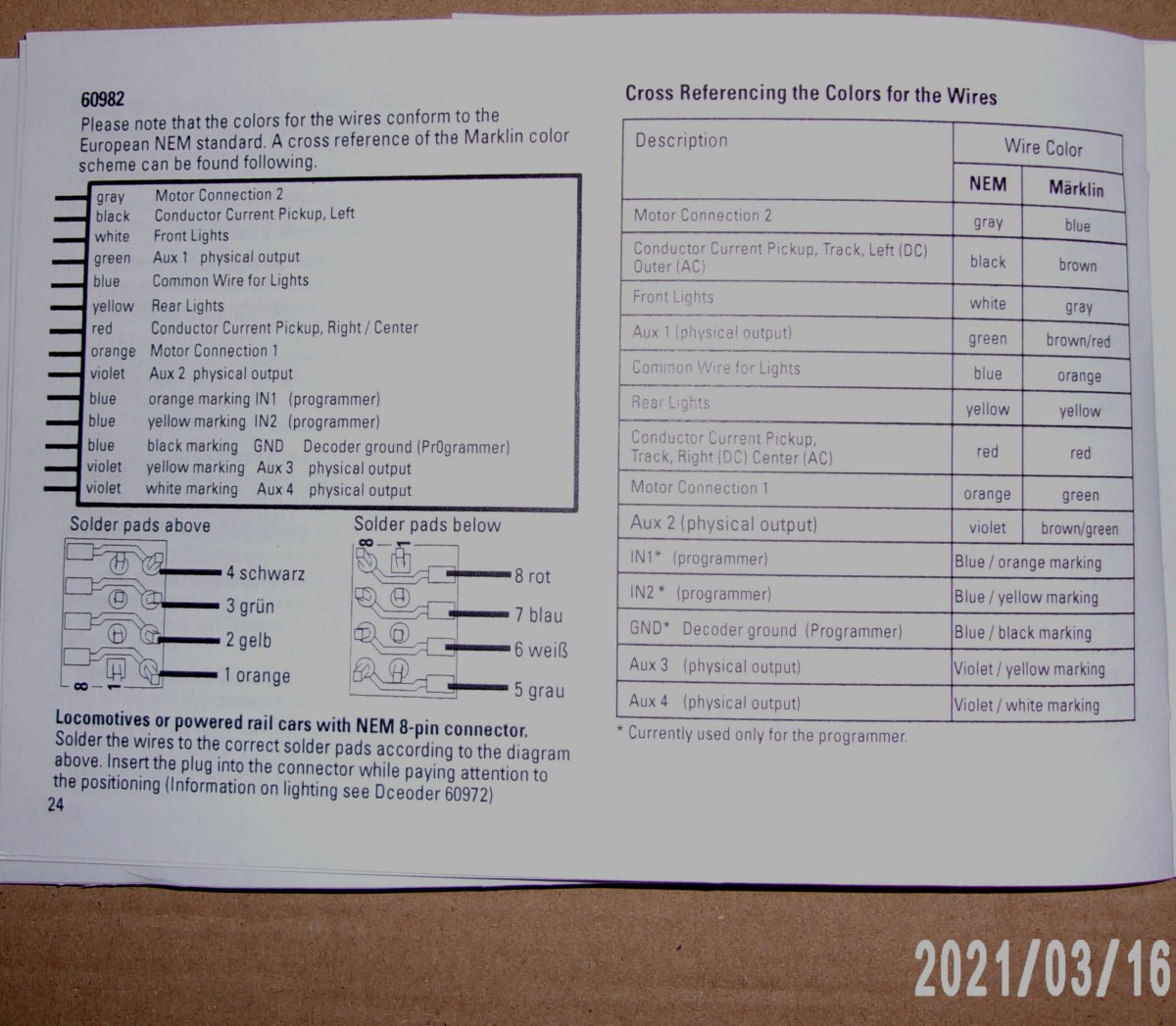

the 60982 come in NEM colours, the chart in the instructions give you the marklin comparison.
"Please note that the colors for the wires conform to the Europen NEM standard"
page 24 of the manual gives you that guidance :)
https://static.maerklin....2e44f7c0851604051046.pdf
ref: https://www.maerklin.de/...ts/details/article/60982

The table shows motor connection two is: NEM gray MARKLIN blue
So I would solder the grey wire of the decoder to the blue wire in the loco (better to just solder the grey to where the blue was)

yes grey and orange are the NEM colours for the motor connections. Directly attach them to the pads on the new motor cover in the same way as it appears now.
You will probably need an isolated bulb holder E276770 lamp socket (incl cables) or E604180 (no cables and much cheaper) and new marklin E610080 bulb if you don't have a 2-pin bulb in place already (probably unlikely with it originally being DELTA) - this isolates the bulb from returning in the chassis ground. The decoder has a return for light bulbs to use (Blue in NEM standard, Common wire for lights)

Thanks for the help..one last question: what do I do with any unused wires, just roll them up or snip them off?

Roll them up and or snip them off to a length that you could reuse at a later date if required.
I’d recommend cutting them at an offset and heat shrink them together or heat shrink each and tape together. Whatever you do You don’t want anything to ground and some of them you definitely wouldn’t want to touch each other else the decoder could be ruined.
