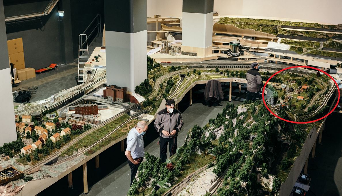

The new Marklin Museum layout is K track and there's an awful lot of it that layout. Take a look at some of the pictures in the New York Times article about Marklin, there's a few of this layout.
https://www.nytimes.com/...del-trains-pandemic.html
#25 Posted : 19 March 2021 11:21:10(UTC)
Posts: 3,667
Hum... Actually... It looks like C-track to me!
Definitely the first part, with the camera-lok, is C-track!!!
On another overview you see some kind of "sweeping" lines, but not QUITE the same sweep as you see with K-track. They might have mixed with K, and/or tweaked stock C-track.
#26 Posted : 19 March 2021 11:50:26(UTC)
That's definitely K track, although the roadbed has been painted and partially ballasted in this picture I took in 2019.
#27 Posted : 19 March 2021 22:45:52(UTC)
This is the area where the video was taken (red circle) and you can see that area wasn't developed when I viewed the layout in 2019. It may well have been done with C track, as Henrik points out it certainly looks like C track in the video.
