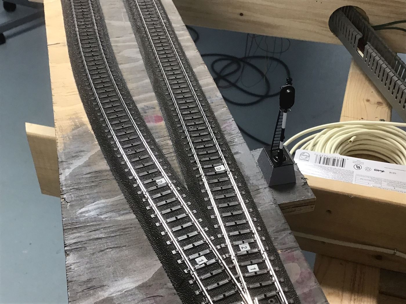

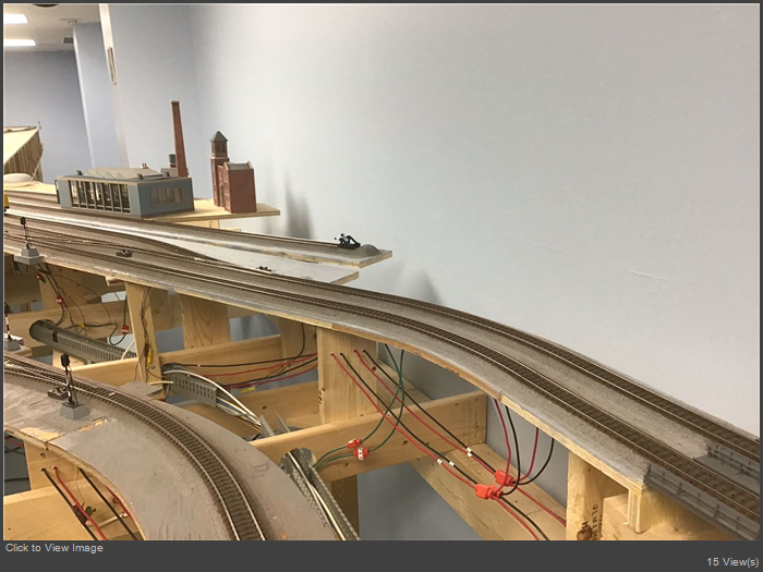

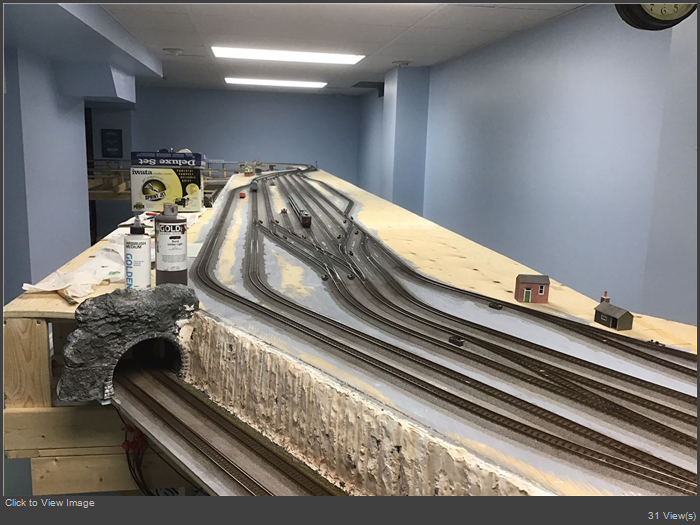

Hello fellow modellers,
May I introduce to you the metamorphosis of a small section of Märklin’s C track in three different pictures.
To achieve this work of art in two simple steps all you need is;
1. Ballast - Wooland Scenics - Fine Grey.
2. Paint- Golden Artist Coulor Inc. - Burnt Unber.
May the pictures speak of the beauty!

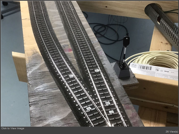

Looks really good! I am guessing the Burnt Umber is an oil based wash you used on the track? Did you do anything special to colour the sides of the rails? Curious about the technique you used for applying it. Thanks

Thanks! With this monumental task I need all the accolades I can get to keep me focused on completing this! I’ve been working on painting the tracks for the last three days (4-6 hours each day) on my layout, what a big job!
The Burnt Unber “Light” Blushing is GOLDEN’s Fluid Acrylic which is formulated from a 100% water-based acrylic emulsion. I mix that with equal parts of Golden Airbrush Medium which is then airbrushed on to the side of the tracks.
I guess the only thing that is special is that it takes me four applications with the airbrush to get that perfect rust colour effect!
Today I’m finally beginning to paint the tracks entering Hamburg station on my layout!
The pictures from my iPad really don’t do it any justice as it really looks quite fabulous. Definitely worth the time and effort!

Yes a lot of airbrushing and to be honest this is my first time airbrushing tracks! I airbrushed mountains on my previous K track layout. But I was not comfortable using the airbrush so I used a brush instead and that took me more than forty hours to do! After I finished with the brush I did go over the ballast lightly using the airbrush to get the that look of washed rust on the ballast.
I should be downstairs doing some more but I decided to give it a break today. One thing I would like to mention is that I position the airbrush about 2” / 5 centimetres from the track and I hold the airbrush straight at a right angle 📐 while I spray. The spray pattern is very narrow maybe two full turns on the needle valve. Slow and precise strokes, a foot / 30cm at a time.

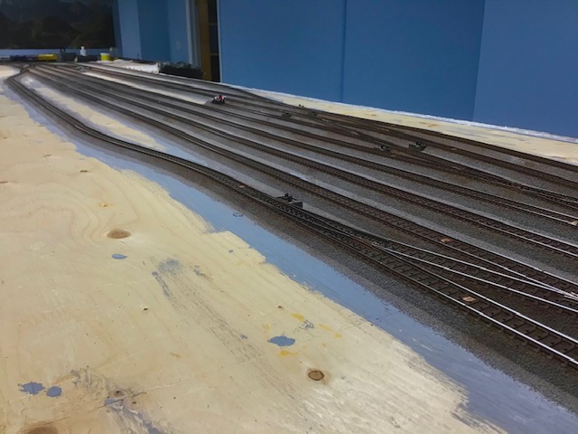

Here’s a picture I just took from my IPad. That little bit of overspray really makes the scene and it’s actually nicer looking on the grey ballast versus the brown ballast on K track, in my opinion.
As mentioned earlier the pictures from the iPad are not representing the true colours that you actually see! You have to see it in person, it really knocks my socks off!

The painting of my C tracks has now been completed. On to the next step.........
