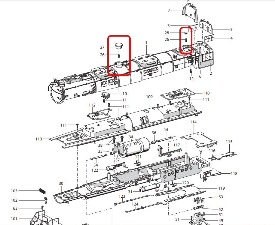

#4 Posted : 01 March 2021 14:38:21(UTC)
Posts: 3,689
Hi Thom
To open the Big boy is rather simple
It all takes place in the red frames above:
* remove the decoration plastic part
* remove the screw
Then you have access to the motor.
Check if:
* the mechanism is seized
* the motor rotates freely
* no wires are cut
If for any reason you remove the motor, be sure, when placing it back that there is the same play on transmission rods on both sides.

Hi Thom
* remove the screw
Check if:
* no wires are cut
Thank you Jean. This really helps.
