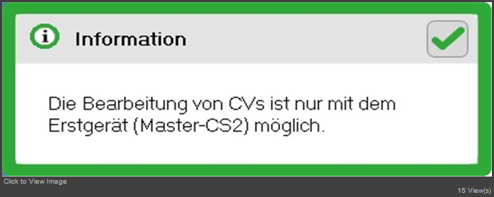

On the update page, I noted the info of the free "Computer Interface for the Central Station 2". I haven't noted this earlier, has it been around for a while? The user interface is nice and fast (compared to the CS2 itself). However, saying that "The complete functionality of the Central Station can be called up on a PC" isn't really true... Trying to acccess the CV configuration utility of the CS2, the software immediately responded as follows:
Well, maybe later... RollEyes

It is acting as another (Slave/Demo) CS2 so I really do not understand your expectation that it can get to your locos CVs from your PC
#10 Posted : 03 March 2021 09:22:28(UTC)
Posts: 15,542
He was referring to Märklin's claim on their site:
"The complete functionality of the Central Station can be called up on a PC. The PC software enables remote control of locomotives, working models, turnouts, signals, routes, and much more from a PC, Netbook, Notebook, or Tablet computer."
So "complete functionality" has some limitations because "remote control of locomotives" is not possible when it comes to changing CVs.
Not a big issue, just a claim proofed wrong.
