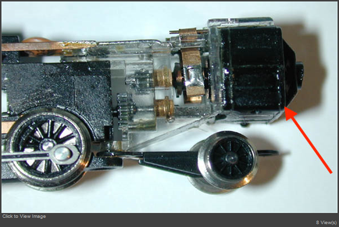

So this problem is fixed, now I have a question that maybe you can help.
I have a complete motor, except for the magnetic case:
I am tempted to assume that - in order to have simplified production pipelines - all magnetic cases of the big Steam locomotives are equal. So a magnetic case from another "horizontal motor" would fit. What do you think? I do not find very amusing having to pay 80USD (plus postage) for a new complete motor.
Best Regards and please stay safe.
Ricardo

#5 Posted : 12 January 2021 01:18:10(UTC)
Zme
Joined: 02/10/2013(UTC)
Posts: 903
Location: West Texas
Hello
Great to hear you made progress on your locomotive.
I have not seen that magnetic cage for sale for those models. I have seen it for the BR 89 or V260, but not that model. I expect you are right and parts are shared across many model, it just makes sense to do it that way. Where the cage may be identical, it is possible it has attachment points which may interfere with using it on a different model. I don’t have experience with this, to be honest. Which model motor is that?
If I notice that part someplace, will let you know, or maybe someone here will let you know.
Best wishes, take good care.
Dwight

Offline Rickmann
#6 Posted : 12 January 2021 01:51:00(UTC)
Rickmann
Joined: 22/10/2020(UTC)
Posts: 49
Location: Guarda, Guarda
Dwight
The replacement motor is Marklin 268850. It is available as a spare, but it is very expensive (90€+20€ for shiping). The BR50 can be purchased complete with that money.
I will disassemble my other BR50 (purchased for 80€) and check if the case can be removed and reattached.
I’ll keep you informed.
Stay safe and take the vaccine. I am due to take mine this week. My hospital is at 120% capacity...it’s a chaos out here.
Ricardo

Offline Rickmann
#9 Posted : 12 January 2021 15:24:36(UTC)
Rickmann
Posts: 49
Hello Dwight
This last post of yours was like sunshine in a winter day.
However i've been looking for more info about this coreless engine and how to install it, but so far no luck whatsoever.
Got equal luck in what concerns the indication of what coreless engine to use for each locomotive model.
Can you help? where do i did for more info?
Thank you
Best Regards
Ricardo

Offline Rickmann
#12 Posted : 31 January 2021 03:35:07(UTC)
Rickmann
Posts: 49
Hello Dwight
Thanks a lot, i will try it, seems very simple.
Today i found that the magnetic cases are standard, i tried a box from another horizontal motor and it works like a charm. So if anyone has that doubt, it works.
