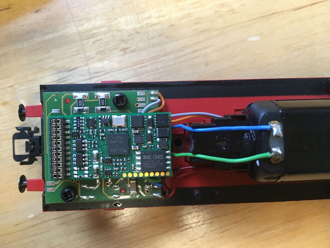

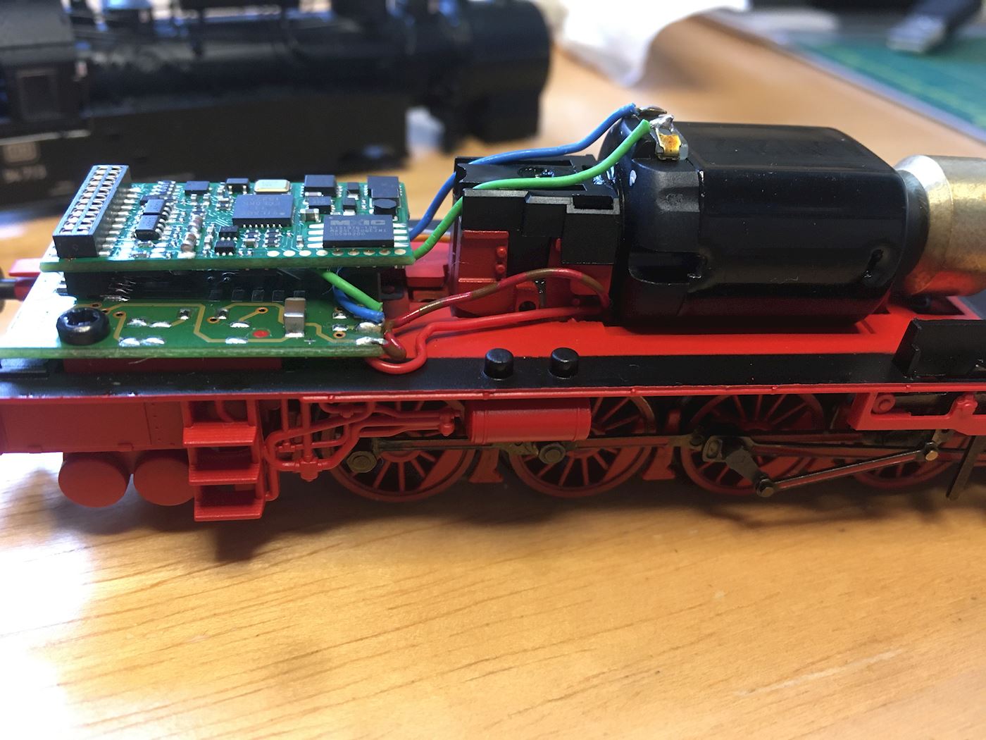

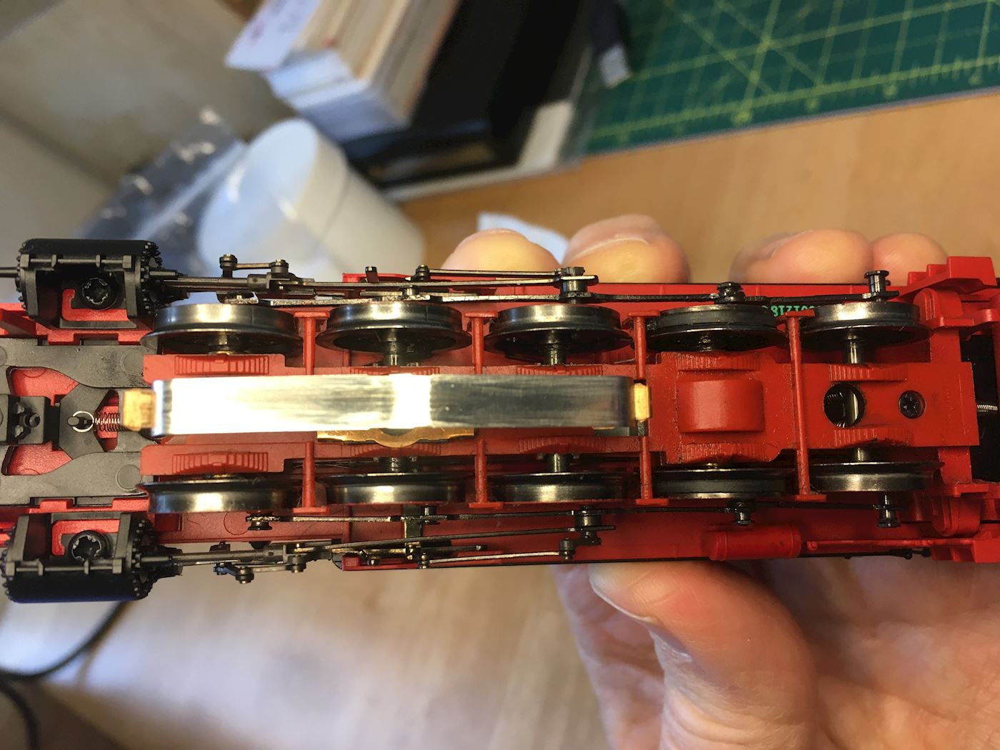

I have an unfortunate Christmas-time quandary. In 2018 I bought a used Marklin Br 94 digital locomotive as part of the 29721 starter set. This became the basis of a collapsible Christmas layout we set up (see photo). While the loco worked when I tested it, upon returning home it would occasionally fail to run. I had it repaired and it turned out there was a problem with the wheelset, which needed some maintenance and adjustment. After the repair the gentlemen who did the work said the wheelset seemed a bit worn and "could go out of alignment if the loco is pushed by hand or pulls a heavy load."
The loco worked well after that, through Christmas of 2018 and 2019, and was fine this year from December 13th up until December 24th (poor timing!). On the 24th I noticed that while the lights and sound effects all worked, the engine would either not run, or would run intermittently, at a limited top speed and with significantly delayed response to inputs on the mobile controller. At this point the engine basically does not run at all. The problem seems to be with the loco itself rather than the power supply to the track, as not only did the loco lights/effects work, but the lighting on three passenger carriages also illuminates.
Having read comments from the knowledgeable group on this forum, I'm wondering if the problem lies with either the decoder or the wheelset. But I confess I don't have the experience to diagnose this on my own. If anyone here has the time to help me figure out the problem I'd greatly appreciate it. Although this loco has caused some problems, my wife and I both really love it and don't want to give up on it. (Of course replacing it would also be quite expensive - €385 on the Marklin site!)
I've attached photos of the wheelset and the engine/circuit board, in case that is of any help. Of course I can take and upload additional photos as needed.

I don't know if this is the source of the problem, but the power pickup shoe seems to be strongly bent out of shape. It should be as straight as possible. You can test this by bringing track power directly to the shoe with a cable.
- Martti M.

Posts: 171
Yes you need your slider as straight as possible. This will be the quietest it can get, but that isn't your problem. Most likely (in my experience), it is your motor that is failing. If you have another 21 pin loco that runs good, you can swap the decoders and see how it runs. If the decoder runs fine in another locomotive, then it is the most likely the motor in the troubled loco.

Just briefly, thanks for the helpful responses. Am celebrating Boxing Day, but tomorrow will try straightening the pickup (though its shape was borne of an effort two years ago to increase speed performance), review the thread on over-greasing. I have a sinking feeling that Rick may be correct about the motor, as this would also explain some of the problems I had in 2018. In addition to this post, I today ordered a new Marklin 21-pin loco which will be delivered Tuesday, so can carry out the test you suggested Rick. Will update this thread once I know more. And thanks again for responding so quickly, and during this holiday period as well.

You are most welcome & good luck with the repair. I would just order a new slider if i were you. To get it perfectly straight again would be quite a performance. #17 Schleifer part No. E144 133

Hi all. Quick update. I ordered another locomotive which enabled me to test both the track and the decoder (the latter by placing a brand-new 21-pin decoder into my BR 94 and my BR94 decoder into the new loco). Both track and decoder worked fine, so I know can now be fairly certain the problem lies with the motor.
At least a replacement motor is not expensive (€25) but as I noted in my original post, my experience falls fairly short of what appears to be fairly precise soldering work required to switch out motors, and Marklin repairs are not the easiest to arrange. Also, I do wonder if the motor burned out due excess strain from previous problems with the wheelset coming out of alignment and whether that might be a risk again in future.
In any case, thanks to all of you, I know what the issue is and what my options are. My appreciation again for everyone's time and consideration in helping me with this issue.
