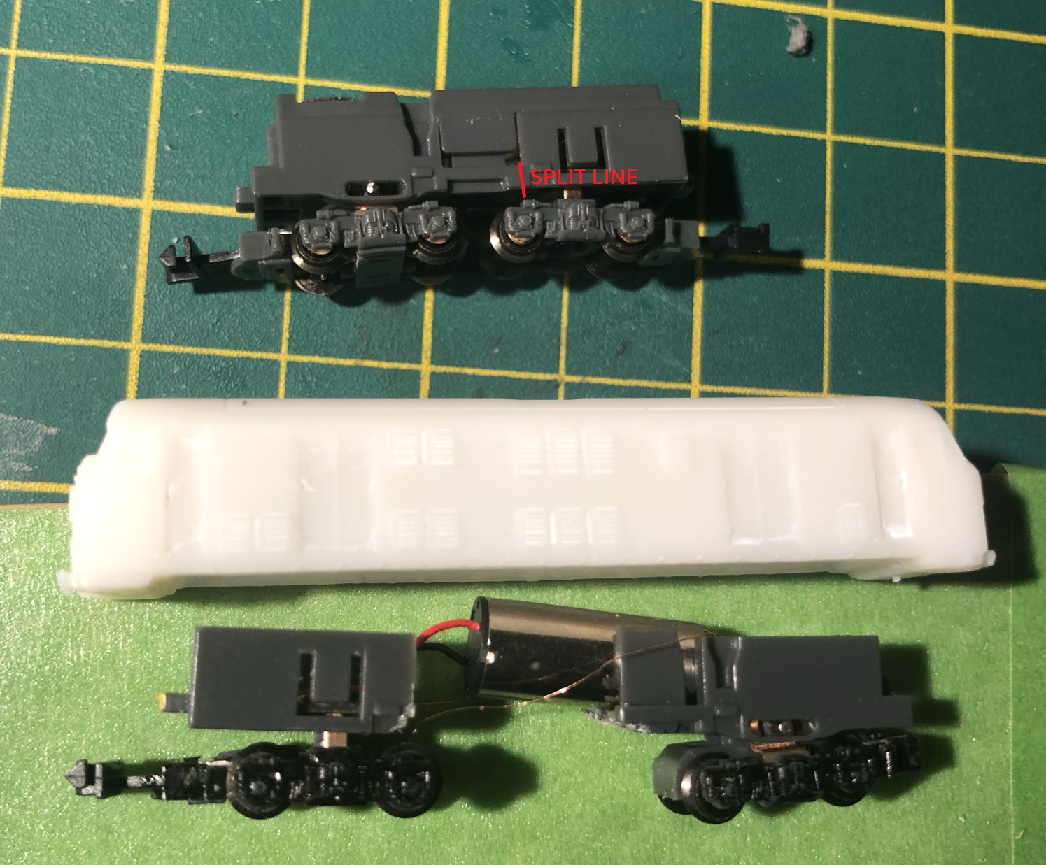

The third print came out beautifully although it is very hard to tell from this potato quality image. White resin also obscures surface detail in photos because it turns into a white blur.
You will have to take my word for it the model came out perfectly. Every detail you see in the CAD model is represented in surface detail. The white dusty reside is from the evaporated Isopropanol but this has been cleaned off after this photo was taken earlier.
In this photo you can see a split and an unsplit Rokuhan chassis.
I have marked the split line in red. I also removed the top cover on the Rokuhan chassis.
It is Z Scale and it is correctly scaled and proportioned. The finished model is 62 mm in length, buffer to buffer. Each one of those squares on my cutting mat is 10mm
It ran pretty good on a bit of Marklin test track with a Maplins 9V PP9 battery until I broke the fine bare copper wire taking the chassis back out without paying due attention. I will replace those wires with some insulated wire later.
I have also designed a fuel tank that goes between the split bogeys which will reunite both parts of the chassis but I have not yet printed this.
I am very happy and it should paint up really well.

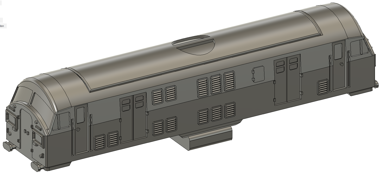

This is the finished CAD model and fuel tank as a separate piece.

#6 Posted : 17 November 2020 01:18:33(UTC)
Posts: 4,055
looks excellent! What CAD software are you using?
That is a lot of work!

Thanks Dale, using Autodesk Fusion 360 for stuff like this, but I also use Blender and Meshmixer for other types of projects. It's about 8 hours of work so far just for the CAD.
Often I will do the hard surface modelling in Fusion 360, then export to Blender, remesh the tris to quads and do some sculpting or other detail that is not hard surface per se.

The printed body looks very good (I blew up the pic for a closer look). The tricky bit for me, would be painting it well, perhaps a simple design would work best.
Thanks for the pics of the Rokuhan chassis. The motor is surprisingly big, compared to a Marklin motor. I may get one myself, as I would like to have a shunter loco, but they are so expensive even secondhand on ebay. It would have to have a wooden body though, as I don't have a 3D printer. I'm pretty good with wood though :)

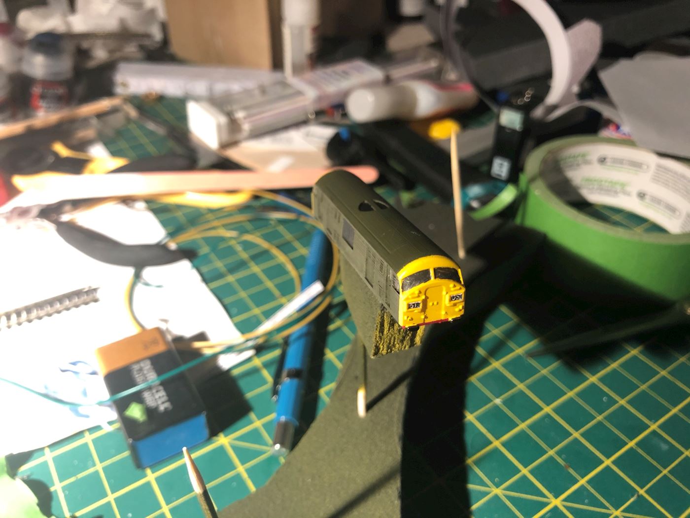

Painting begins...
The little numbers are just laser printed on regular copy paper. Cut and applied to the model with some ModPodge on the end of a cocktail stick.
I might use this method for the other "decals" as this gives me the ability to print white.
thanks 4 users liked this useful post by Big AL

Shaky hand painting complete

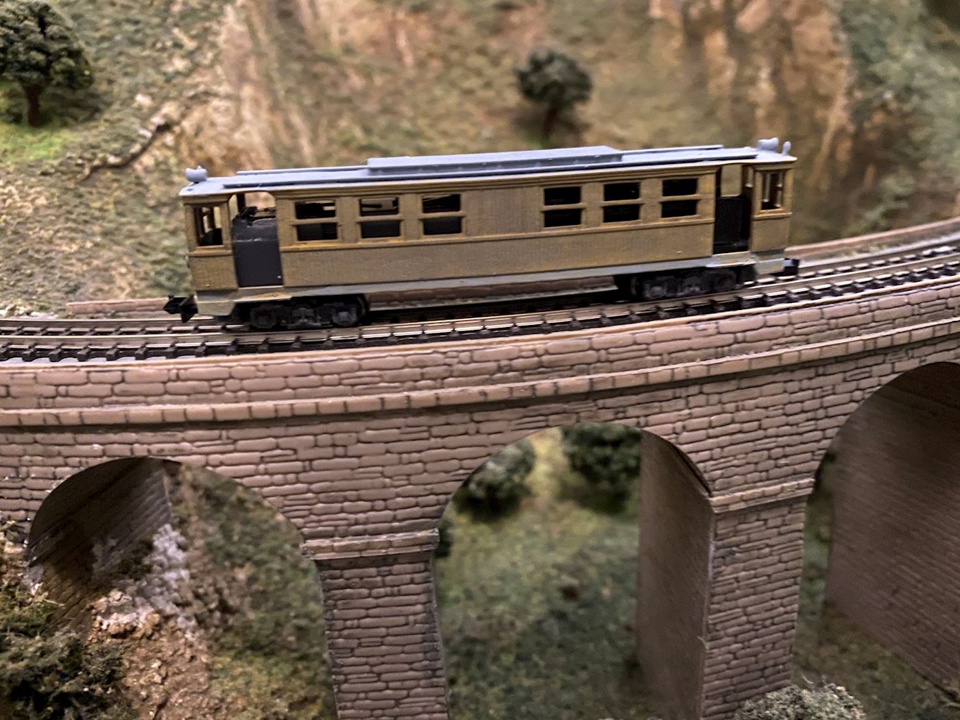

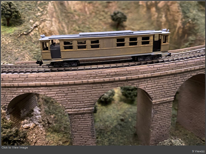

Offline Poor Skeleton
#18 Posted : 20 February 2021 19:55:28(UTC)
Poor Skeleton
Joined: 09/10/2015(UTC)
Posts: 604
Location: England, Cambridge

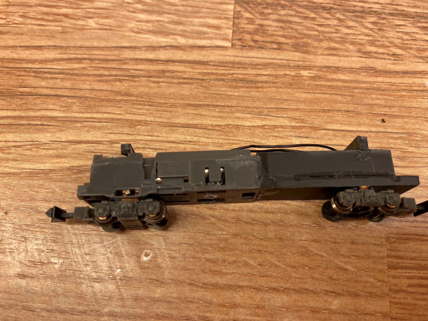

I’ve been engaged in a similar endeavour, but have approached extending the chassis somewhat differently - leaving the original chassis intact, but remounting the unpowered bogie on the extended chassis, which I made from 2mm plasticard.
Hope this is of interest.
Chris
Nice one Chris, I think yours is the better approach. Splitting makes it difficult to maintain structural viability. One note for anybody attempting this you need very thin and flexible wire. I used 28AWG silicone wrapped. Anything PVC wrapped will be stiff although the longer the extension the less important this will be.

On this model, how is the motorized front attached to the non-motorized rear section? Is it glued, it would seem a great deal of stability would be provided by the shell. it may not be a serious issue.
Hi Dwight! The additional section is glued using plastic weld to the original motor block and, as the chassis extension is made from 2mm plastic, it’s actually quite sturdy. With hindsight, I wish I had made the chassis extension in an inverted “T” shape rather than a “U” as this would have worked better with the pick-up wires of the trailing bogie/truck, but it seems to be OK as it is.
Will this be added to the 3d printed shell displayed earlier. I expect either method would be a good solution. I would be nervous just making that first cut.
Yes, that’s the idea! I slapped some paint on a body shell last night to see what the finished thing would look like and here is the result. (Painting is not a skill I possess and it’s even worse than usual here, but you get the general idea!)
I do need to work on the underframe, so that will be the next part of the project!
Hope things are alright where you are - I hear things are pretty grim in Texas at the moment. All the best
Chris
Thanks Al. Fortunately, I had some very fine wire that came with some phosphor bronze strip I bought for another project, so that’s what I used here.
