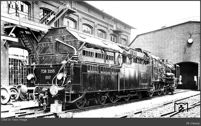

Calling all DRG experts and fans. Recently when browsing web I came across quite interesting and rare photograph of German DRG Steam Locomotives taken during the WW2.
The best-known and the most produced German war locomotive , or Kriegslokomotive was DRG Class 52 and 42.
Germans equipped them with special condensation tenders to cope with water shortages in vast Russian steppes.
But on the photo is Ex Prussian P8 - BR38 with Condensation Tender! Quite unusual and rare sight I guess.
Gentlemen, have anyone of you seen BR 38 with such tender or any other steam locomotive class besides above mentioned BR 42 and BR 52 ?
[ BR53 is a pure Märklin fiction ]
So having large tenders that would condense exhaust steam back into water only caught on in the Soviet Union and South Africa.
Well but I do not understand why they did not catch on in the US Southwest desert or down under in Aussie country.
Any comments or stories ( perhaps photos) will be truly impressive and appreciated.

nice catch. Don't tell Märklin though, otherwise we will have a new must-have combination out soon...
#3 Posted : 02 December 2020 13:13:53(UTC)
Posts: 8,616
ThumpUp ThumpUp ThumpUp
Although I wonder if that is really Stalingrad as the caption purports it to be. I didn't think the Germans actually managed to capture the city.

Here's a link to a youtube video (jump to 00:45) which could be the source of the photo shown here:
?t=46
Not pure fiction. The loco existed on blueprints only. MEB and MIBA published the blueprints, people started making freelance models - and Märklin saw a chance to make money.
Hallo Gentlemen,
Any one ?
Märklineisenbahn
Judging by the condition of the buildings in the photo, I think that this lok is just a fluke of the war. Maybe it was cobbled together from anything laying around that could be made to run. I did however, find a photo of a turbine P8. I believe that the wheels of the tender were turbine driven and the lok ran in conventional steam mode. A far more interesting lok to model given the driving wheel arrangement, rods etc. of the tender.

Apparently there was once a kit to convert a Märlkin BR38 to the turbine type above:
https://picclick.de/Baua...tml#&gid=1&pid=1

For those understanding German, have a look at Wikipedia. The article is about a T 38 steamer with an additional steam turbine combined with a condenser.
https://de.wikipedia.org/wiki/DR_T_38_3255
The product from Maerklin was a BR 38 art# 3098
http://maerklin-sammler-...iven/03098/03098_m_m.htm
