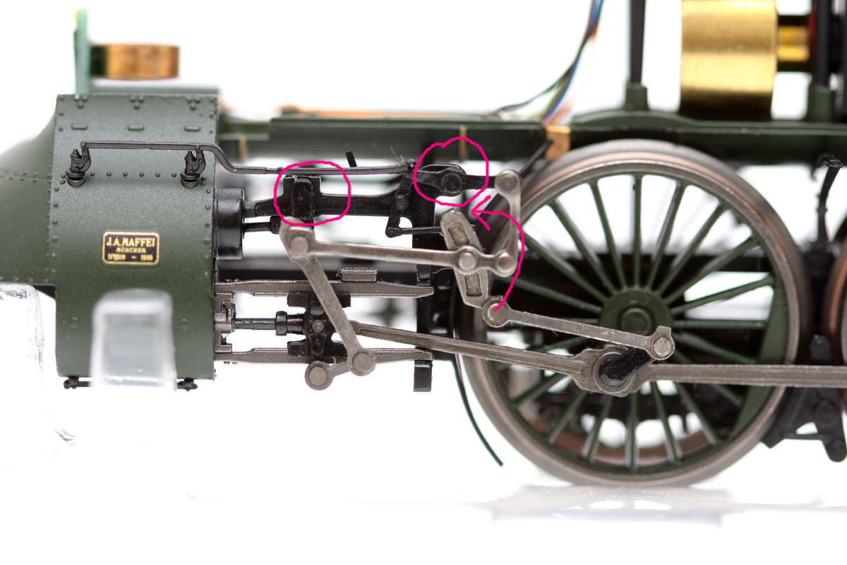

I was running my 37015 (S2/6) and at one point it came to a stop. Motor sounded like it was bound up. Started tearing it down and noticed that part of the running gear on the left side was hanging loose. I circled the two plastic parts in the picture that were loose. When they came loose the metal part (that looks like a banana) below the circled part on the right did a 180 degree flip and was binding up against the other rod! I pulled the rivet on the smaller connecting rod and got the ‘banana’ part re-orientated. It’s running and all seems well.
My question is this; the two plastic parts in the red circles are just pressure fitted. I’m concerned that they may dislodge themselves again over time. Would I be foolish to add a drop of plastic cement to hold those parts?

As to your question about gluing the pressure fitted pieces, I glue them if they come loose and they do not need removed for any future reason.
I find that Märklin pressure fitted pieces don't always stay in place well and over the years I have glued many of them in place for good and all.
That may be the best solution in the long run.
