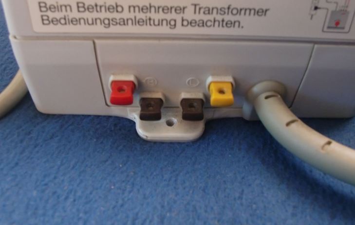

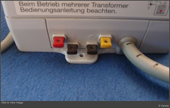

Ok, I'll have a look at the white transformers. How are they plugged to the rails? simple wires that I can solder or screw to a pin?

#9 Posted : 15 August 2020 00:08:27(UTC)
Posts: 3,618
Are the blue plastic transformers not ok?
They have certain problems. I'm no expert, but here goes;
They have a problems with microspikes and the reverse-pulse, which can damage modern decoders.
If you are absolutely certain that you will ONLY be running old style analogue locos, the blue trafo should be OK.
They have a problem with transforming to 230V, in case of 2 trafos wrongly connected (f.x. the red connection bridged by a slider, or by a erroneous cabling), AND one of the trafos NOT plugged into the outlet; In that case you can have 230V live on the plug! (I suppose there is a technical word for this situation, but right now I don't remember...)
This problem exists regardless of what type of locos you are trying to run.
#10 Posted : 15 August 2020 00:09:11(UTC)
They have lugs on the back into which a bare wire can be connected.
#11 Posted : 15 August 2020 00:17:28(UTC)
Commonly known as 'Back Transformering', where as Henrik states two transformers are connected together via their brown / yellow connections or their brown / red connections. If one of those transformers is plugged into the mains, mains voltage will appear on the mains plug of the 2nd transformer - not ideal Neil! The newer white transformers have inbuilt protection against this.
One other issue with blue transformers is that they were often rated for 220v mains input. If they are plugged into 230v or 240v mains they will give a slightly higher voltage output, especially when the reverse pulse is engaged. It is this higher reverse pulse that can destroy some of the early digital decoders. Not so much of a problem if you have analog only.
With the 10va blue transformer you have, there isn't much power output from them to run more than one large loco or two small ones, and certainly no power free to power any lights you might have. So if you are going to get a 32va transformer you might as well get a used 6647 32va white transformer off ebay or suchlike.
The rule of thumb always was that one large loco consumes 10va, a single light consumes 1va and smaller locos consume about 6 or 7 va.
