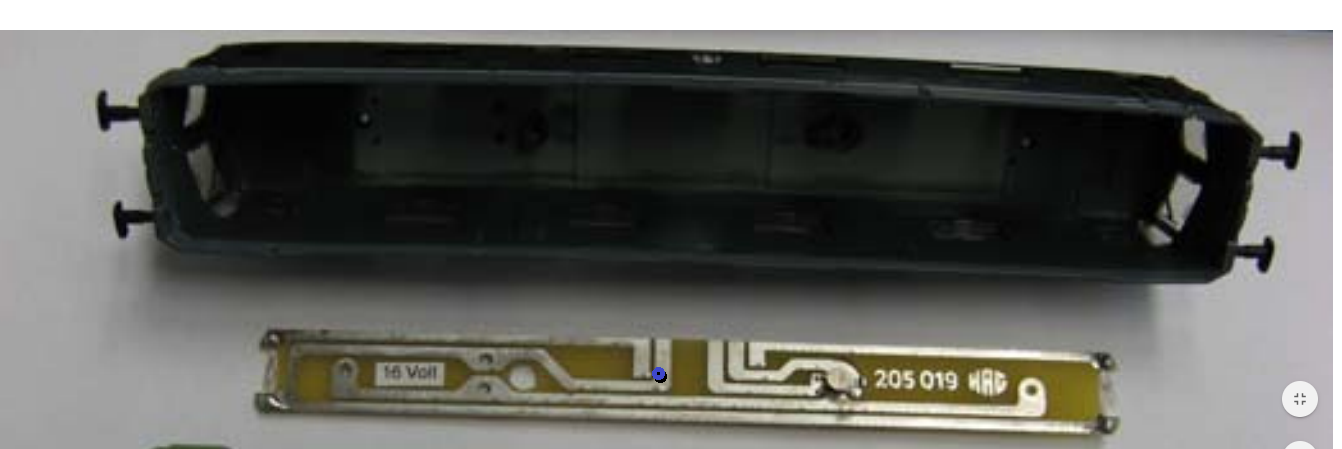

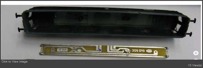

#9 Posted : 09 April 2020 14:56:35(UTC)
lok151
Joined: 17/02/2010(UTC)
Posts: 26
second tab is function ground on top for lights, on bottom is chassis and decoder ground
Is this the same as your roof? This picture from the HAG website is a Re 6/6 roof circuit .
The position of the blue dot is the second tab of the fingers. I have soldered the blue wire (orange wire for Märklin 6090) here.
Then I put a piece of heat shrink tube over the finger to stop it contacting the printed circuit. Lights shine without flickering. I have used a small plug and socket so as to be able to remove roof for maintenance of loco or just unsolder the wire to remove roof.
Bernard

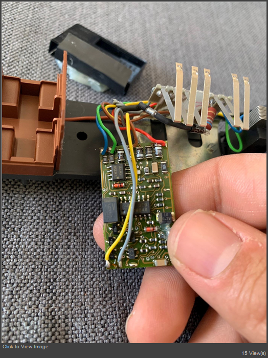

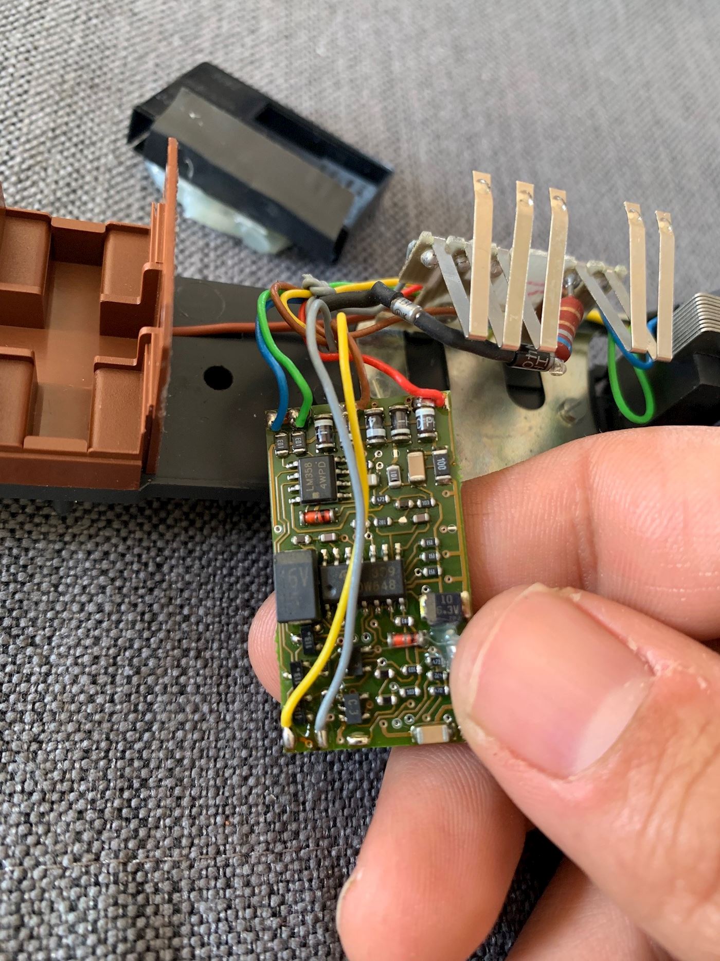

#10 Posted : 09 April 2020 16:51:28(UTC)
Posts: 3,043
Hi Bernard- correct! Thank you for confirming this. My board is slightly different, but same principal.
One question though- why isolate the finger and solder straight to the board? It is isolated on its own, with only a jumper from the finger wire to the main chassis ground. (at least on my 2 HAGs like this). I just pulled the jumper wire which leaves an empty terminal for the blue/orange wire.
The wire I pulled is the brown one with shrink tubing/diode in these images:

#11 Posted : 10 April 2020 03:58:56(UTC)
lok151
Posts: 26
On the Re 6/6 the board holding the 5 fingers is riveted to 2 supports which are part of the chassis. The second finger is attached to the chassis via a metal strip in the board through one of the rivets.

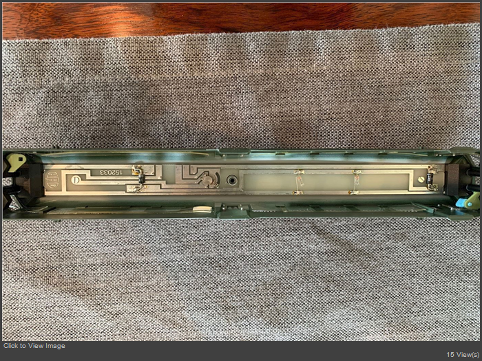

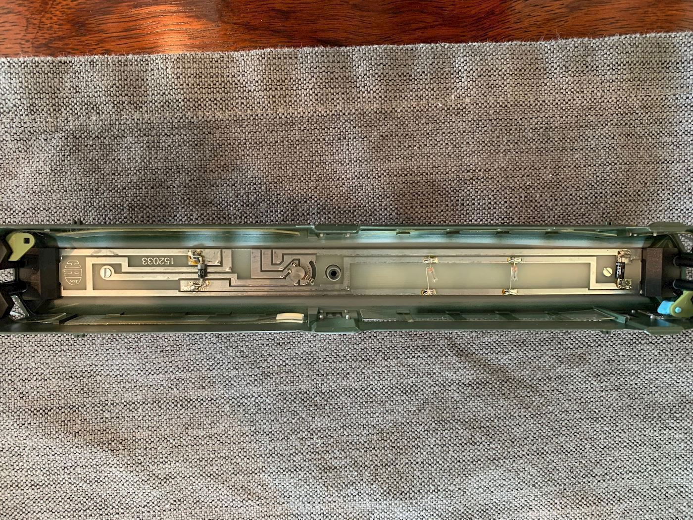

#12 Posted : 10 April 2020 20:08:14(UTC)
Posts: 3,043
Hi all, some updates as I did not solve it. First of course is an image of the roof.
Yesterday I ran a separate ground wire and that eliminated flicker, but there is a major feedback impacting running of the locomotive/motor when ever the lighting is turned on. No running issues with the F0 lighting "off". I suspect it has to do with these diodes in the shell. Thoughts?
I can pull the diodes, but eliminating them would lose the interior lighting. (assuming that even fixes the headlight/motor feedback problem)
Thoughts? I have two of these. On one the fix is quite easy via an additional function lead similar to bernard above. The other has a 6090 with no function output, so I maybe stuck. But better no cab lights and everything else working than the current situation. I don't need them anyways

They are jumpers, providing power to the interior lights. One pulls off the forward headlight circuit, and the other the reverse lead. I'm going to test pulling them later tonight just to see. More to follow...
#17 Posted : 11 April 2020 06:20:03(UTC)
Posts: 3,043
An update: pulling the two resistors/diodes did the trick! Runs perfectly, with directional lighting.
Unfortunately I no longer have interior lights, but thats ok for now. I'll confirm the wiring arrangement works otherwise once the replacement lokpilot for the one I toasted arrives. And now of course I know to pull diodes and run F1 for the interior lighting...
