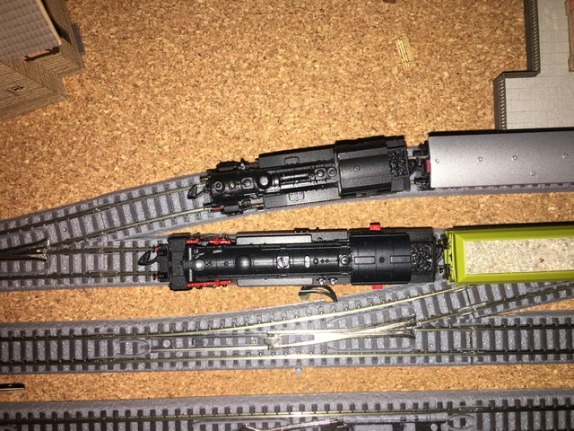

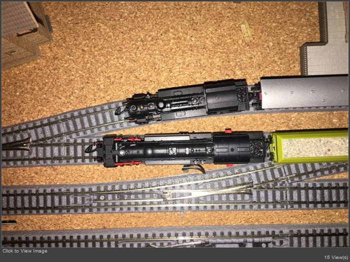

Well, I'm not Chris, so i have no hilly terrain, but I do have an 88294. I can't remember who I got it from probably fleabay. I saw it and had to have it. A mallet! Mine is new and runs well. It is a very impressive loco! So as for running it runs well in either direction but it does not like to run very slowly. I think there is a lot of drag in the gearing so it sort of lurches along at a crawl. I put it on my 195r track and loaded it up with 14 cars, 3 4 axle the rest 2 axle. It's pulling or pushing them well, stopped and spun on a turnout after a minute so I went one step faster and it is fine now at 120 out of 200 on my Marklin Mini club throttle. So i think it is a 5 pole motor but everything else looks like a new modern motor Marklin. The lights are very bright, whiteish, and change with direction of travel. Note that the picture of the Marklin 88294 shows it with bright silver running gear but mine has a darker finish like blackened wheels, it looks terrific. There is no issue with the sand pipes dragging like I have with some of the small steam engines that have them. (Bubikopf, grrr)
Here is a nice link if you haven't seen it:
http://ztrainsweekly.com...allet-locos-88290-88294/

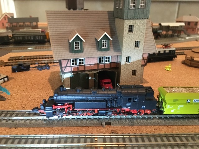

Hi That is a beauty!
I have heard it makes wide turns and cannot be used with catenary because the wheels stick out so far. I have been slow to pursue this one for this reason. Do you think this is true?
Thanks for sharing.
Dwight
Offline husafreak
#38 Posted : 09 September 2020 05:56:35(UTC)
husafreak
Joined: 09/04/2019(UTC)
Posts: 565
I don’t think it hangs out around turns, but as you can see the red steps on either side of the engineer station protrude quite far. My tightest track is 195r. My layout is just test loops.
