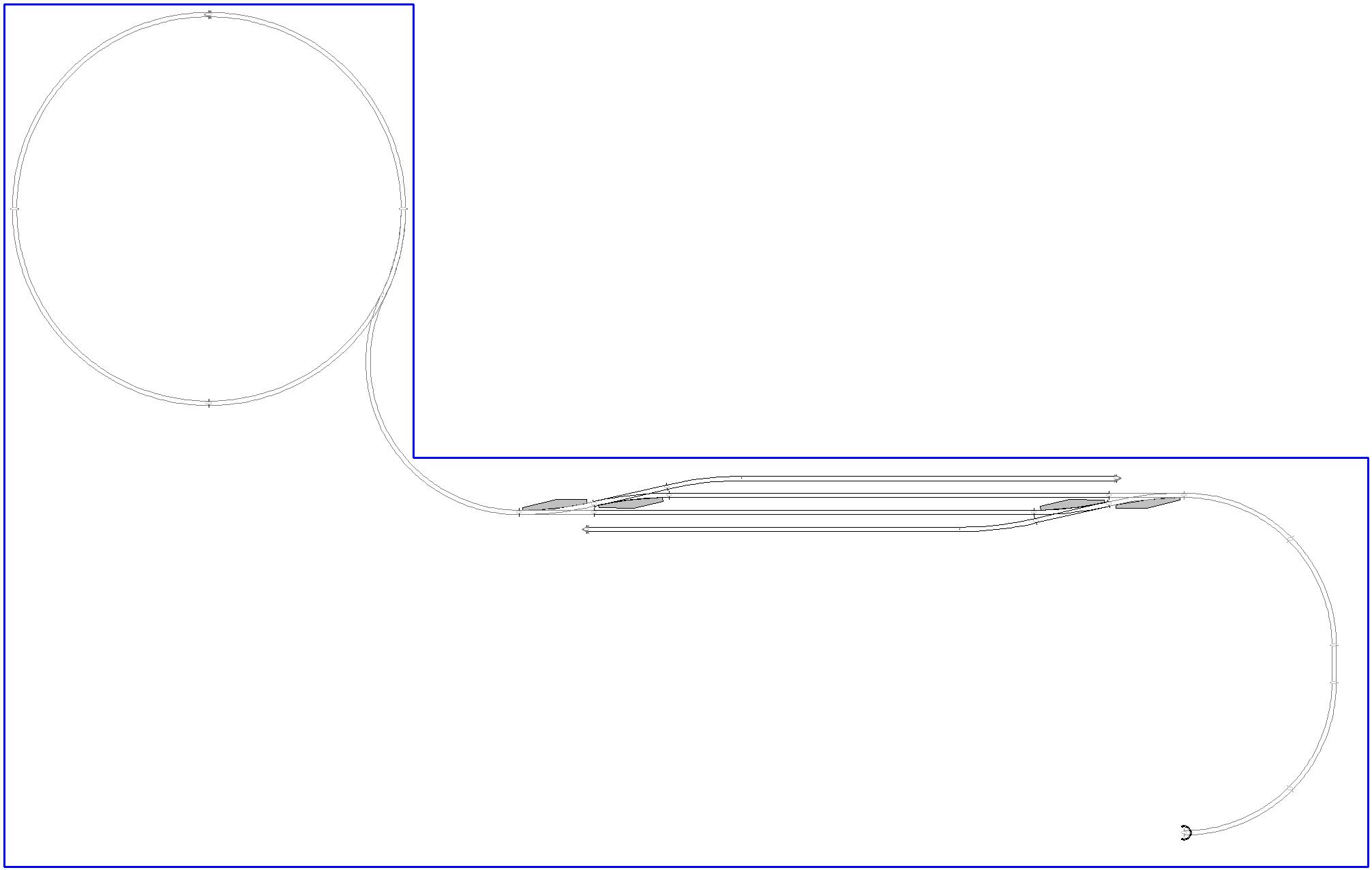

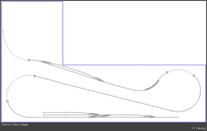

There's not much precision in the building of the layout, let me assure you, but I did plan the gradients quite carefully, having determined that anything more than 3% was going to present a problem, even with the fairly short trains I was planning on running.
Track plan is below - I've separated out the visible and hidden sections for the sake of clarity.
The layout was inspired by the Ferrocarril de Sóller on the Mediterranean Island of Mallorca, which really does double-back on itself as it climbs the mountainside.
Hope this is of interest
Chris
