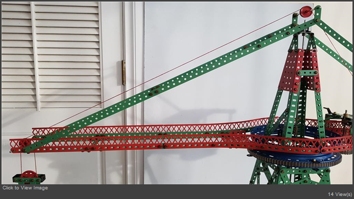

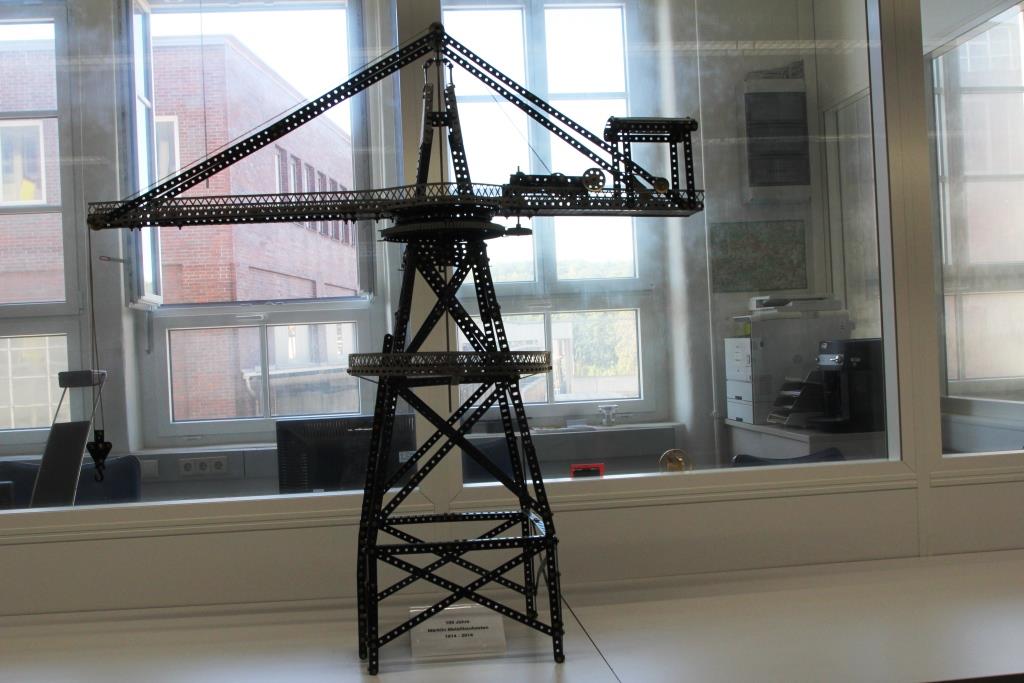

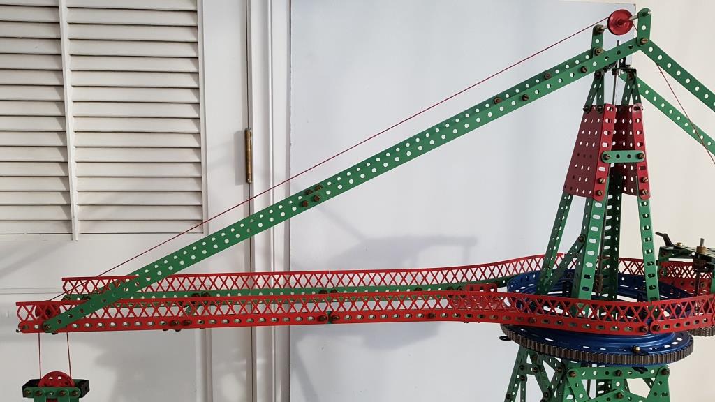

I'm having an attempt at building the Märklin Tower Crane from the booklet that came with the 10891 kit, but using parts from my 1014 / 1034 / 1080 Märklin Metall kits.
However, the 10891 booklet isn't so specific with some of the details such as construction of the tower, mounting of the platform to the tower, etc - it's hard to make out some of the detail from the photos in the book.
For example, there's no details as to what bits are required to build the A frame of the crane as seen in this picture.
Does anyone have or know where to find more details of how to build this crane - the model has been around since 1914 so I expect there must be something!
Photo shows a completed crane as seen in the Märklin factory in September last year.
Thanks in advance.

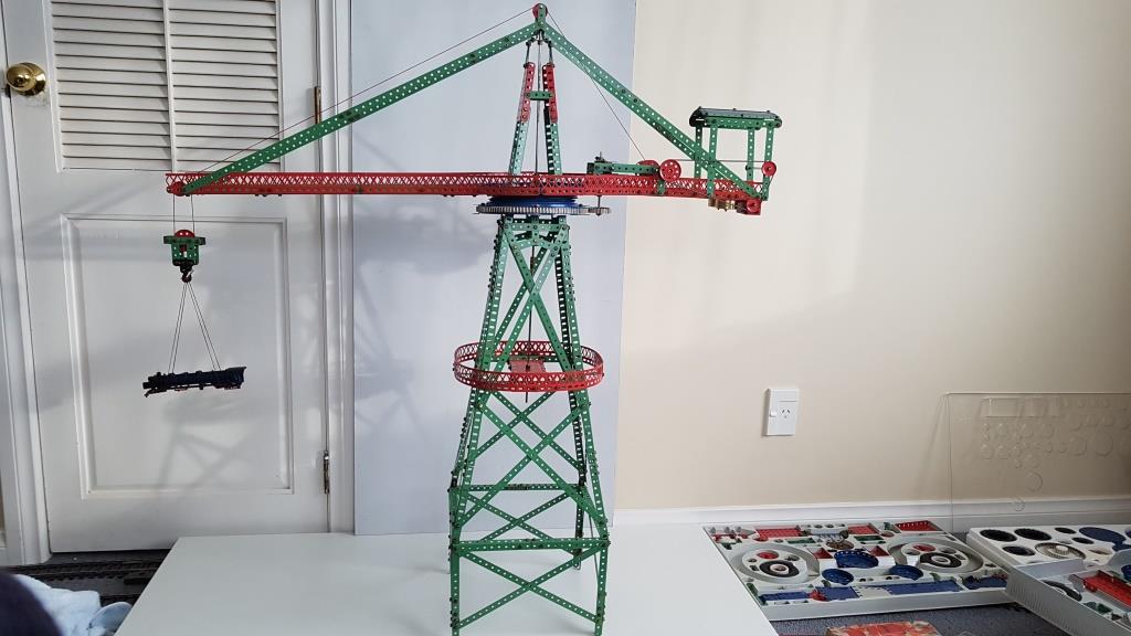

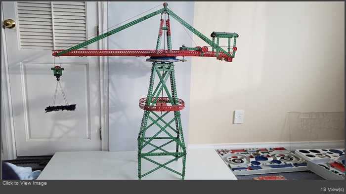

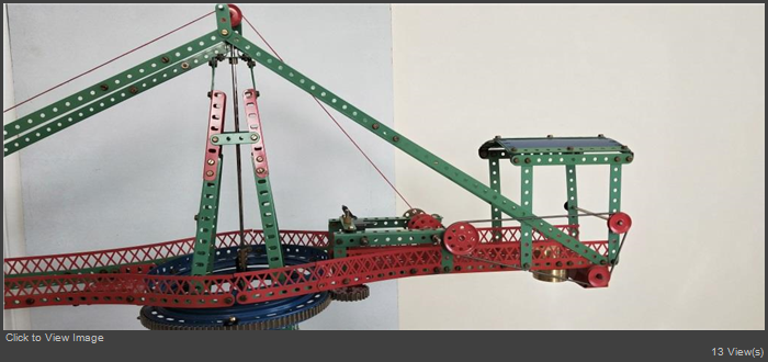

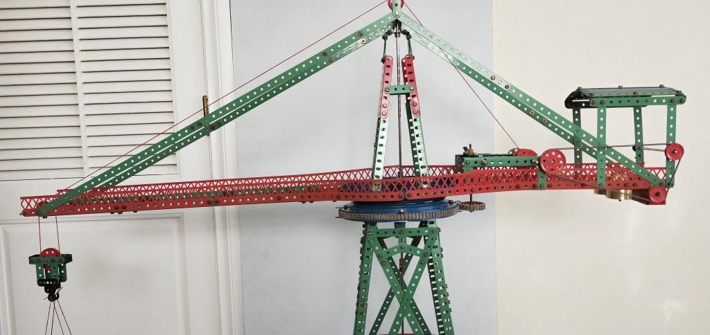

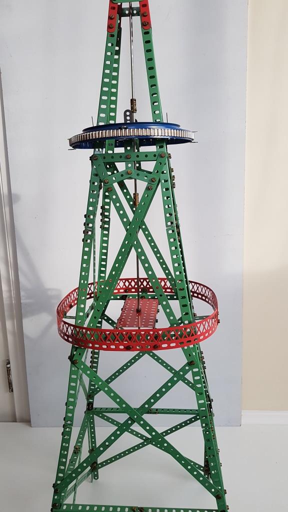

#7 Posted : 02 August 2020 11:09:39(UTC)
Picture of completed crane
thanks 6 users liked this useful post by Bigdaddynz
#8 Posted : 02 August 2020 13:01:18(UTC)
Posts: 8,717
Well done. ThumpUp

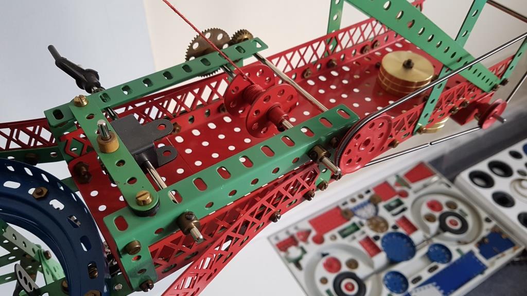

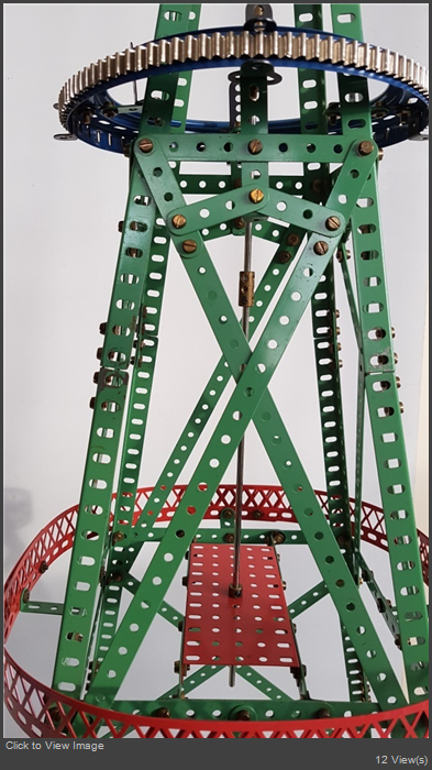

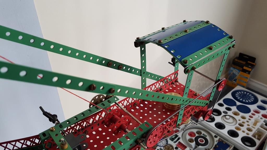

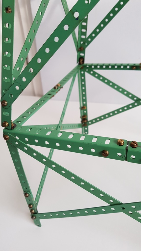

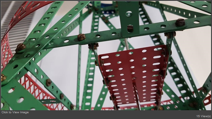

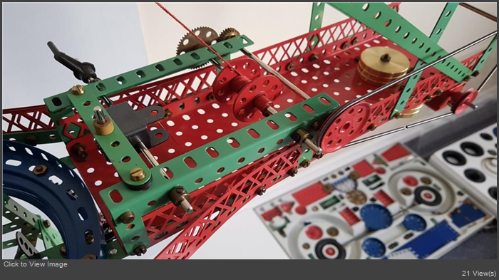

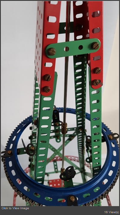

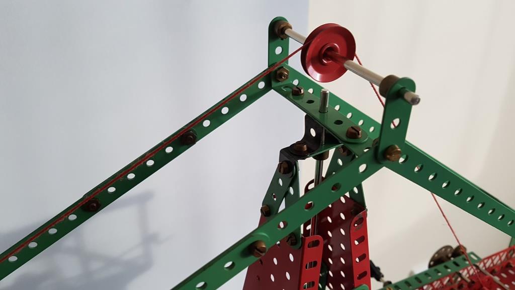

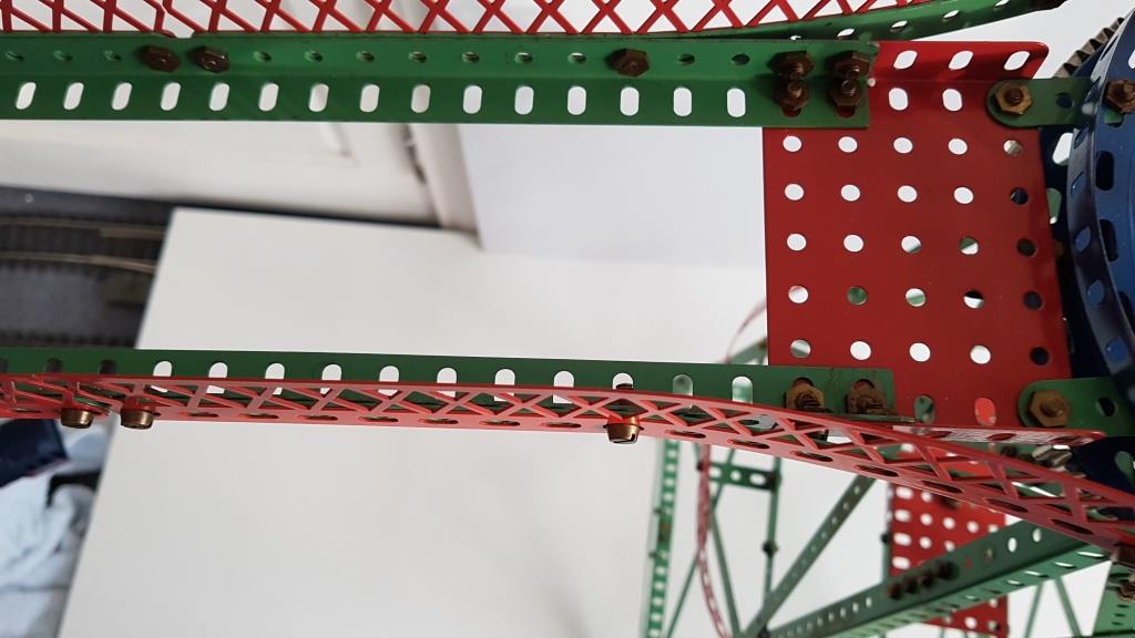

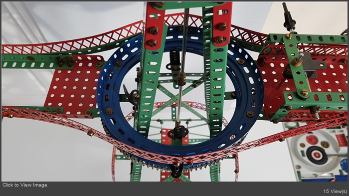

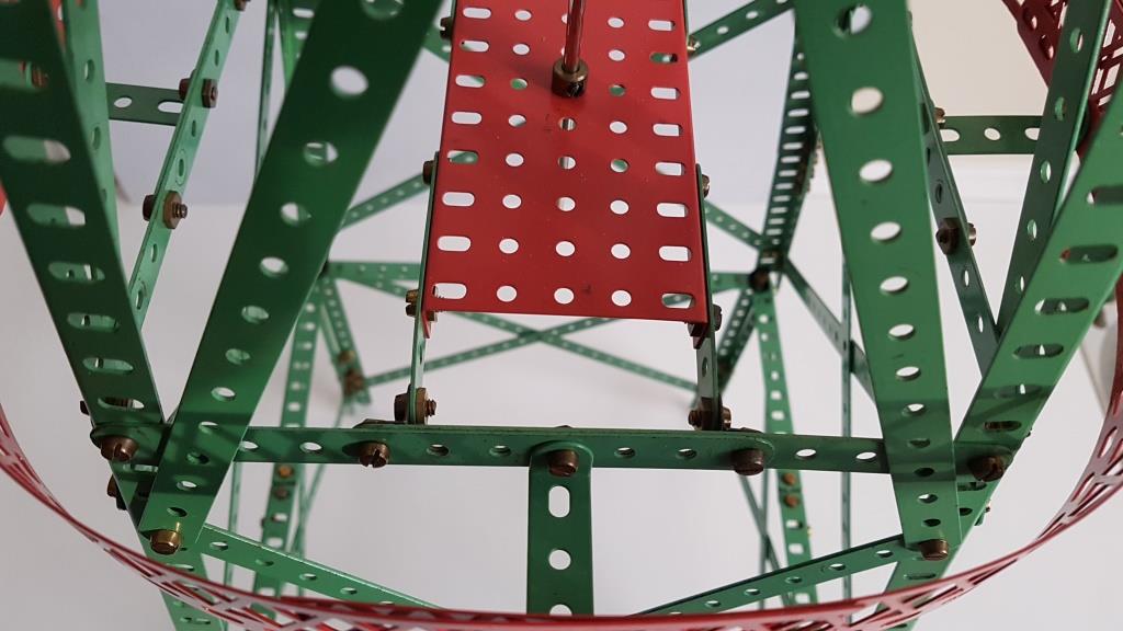

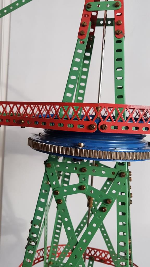

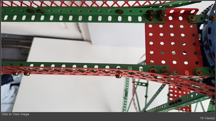

#9 Posted : 04 August 2020 08:06:34(UTC)

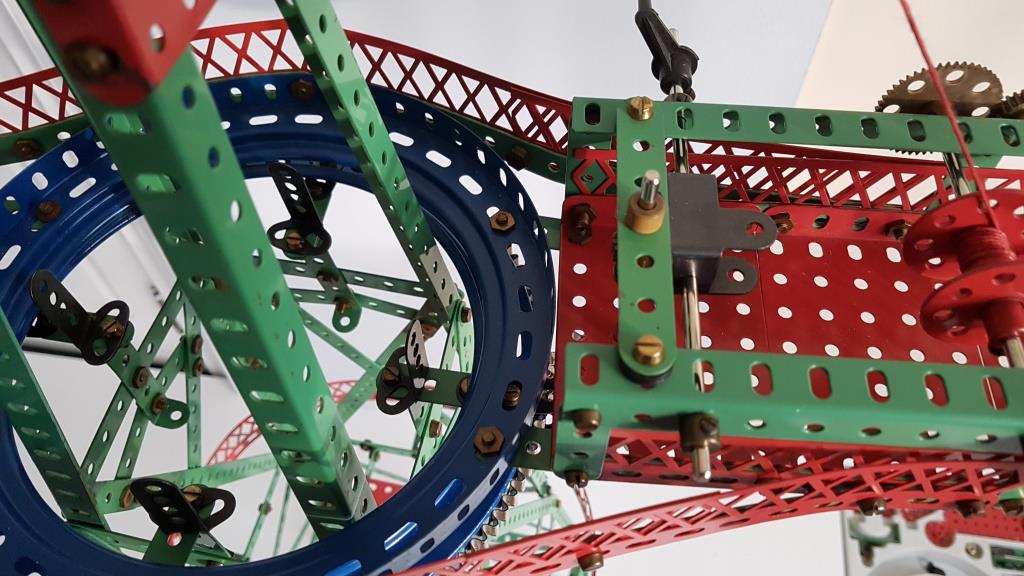

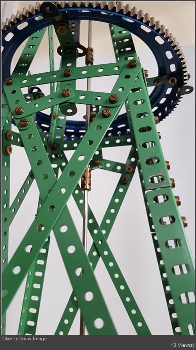

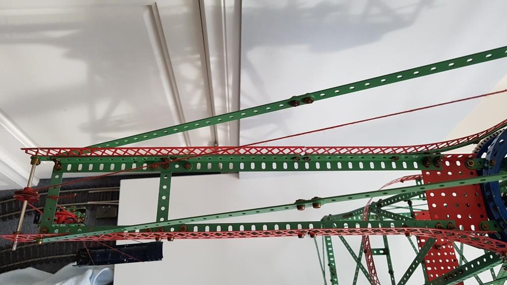

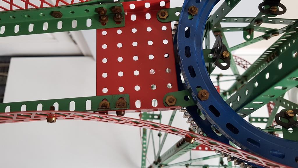

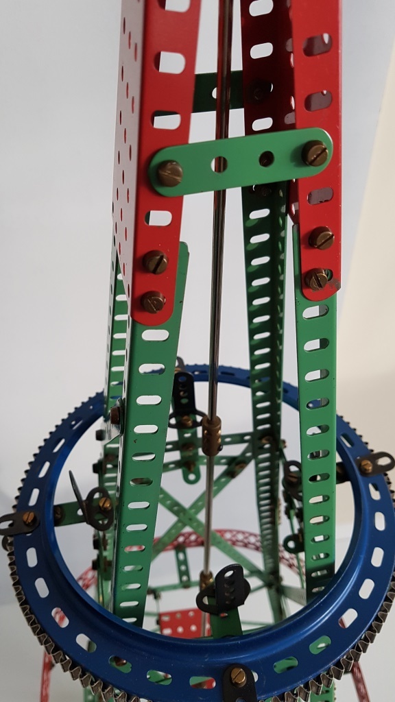

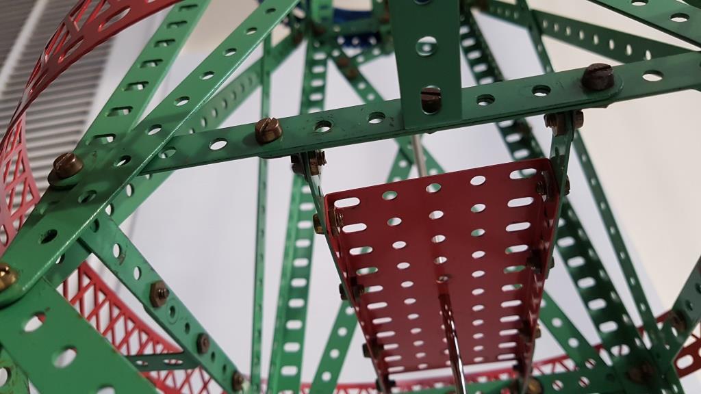

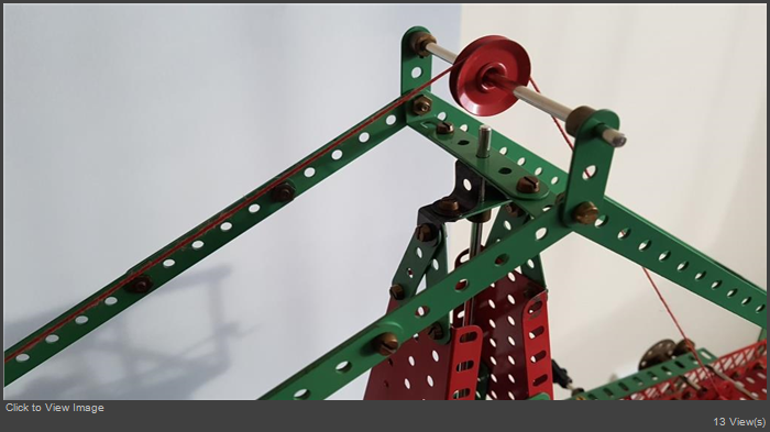

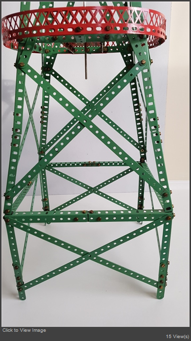

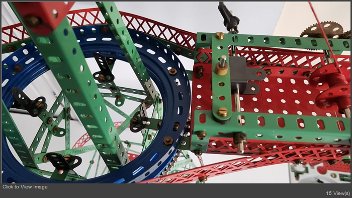

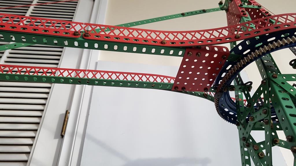

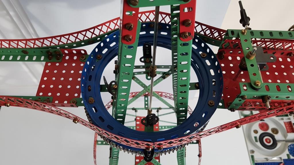

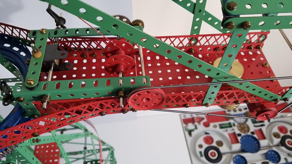

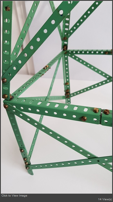

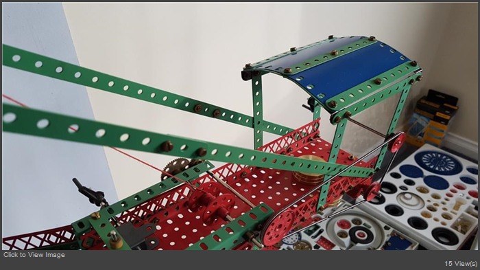

Sorry if these are too many photos here (there are more but I culled them down), but I'm trying to provide as much detail in visual form for anyone trying to build this crane, as there are gaps in the available information.
