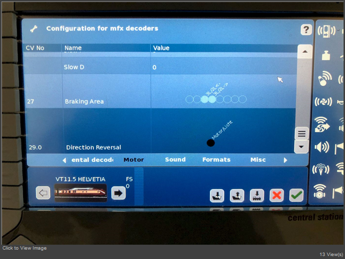

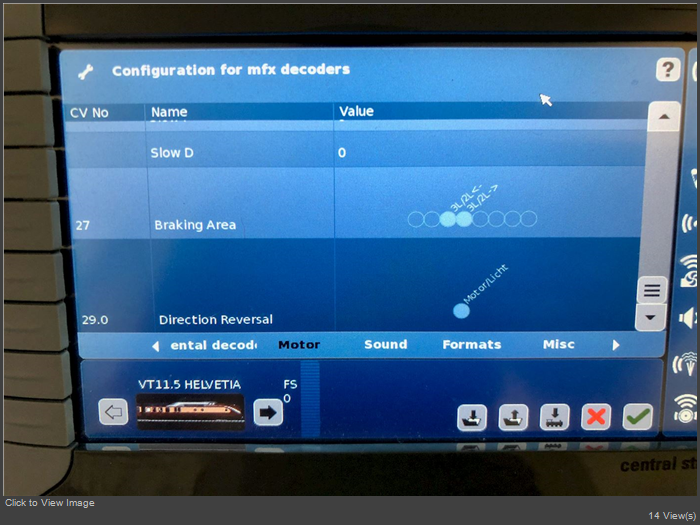

My 37604 VT 11.5 is running in the direction indicated by the gui on my CS2 but the lights and active slider don't match. In other words the forward power car has the inactive slider and red lights, while the rear power car has the active slider and the white lights.
It seems like changing the direction reversal bit might be the answer. In the motor block CV #29 controls this and when I read the CV values I see this, which seems to correspond to the "normal" direction value of '0':
But after I press that bit icon on the CS2 it does change from grey to black, which seems like it is now set.
But I can't figure out how to save it to the loco decoder. I can read/write to a folder and there is a download to loco button but it does nothing. If I close the dialog the change is lost. I'm not sure what I am missing here. Is this possibly part of Märklin's locked decoder bs?

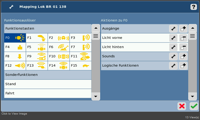

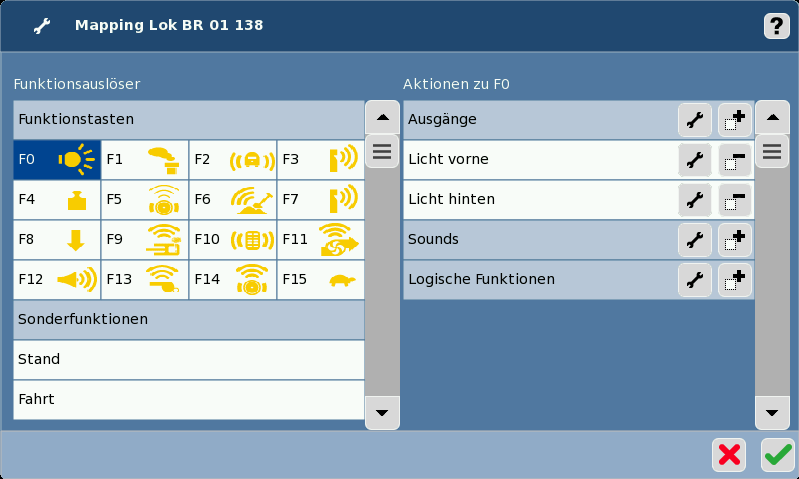

2- change the direction lights and slider
Direction lights change:
- start editing parameters on the train (wrench)
- select CVs
- push the light function key
Select the field Front Light (Licht vorne) and edit it (wrench): front lighting activated only in one direction: reverse or forward. Repeat the procedure for Rear lights (Licht Hinten).
Slider change
The slider selection is made by a bi-stable relay and its position is made by sending a short pulse to AUX3 (forward slider) or to AUX4 (reverse slider) when going forward or reverse.
So after you go to the same screen as before (function change and programming, look into "Logic Functions" to see which one is commanding AUX3 and AUX4 and reverse the direction when each one is triggered.

I have tried to imagine how this problem came about in the first place and a not having all of the couplers fully connected is one thing that I have considered. I would love to know how I broke it so I can avoid breaking it again if I do ever get it working.

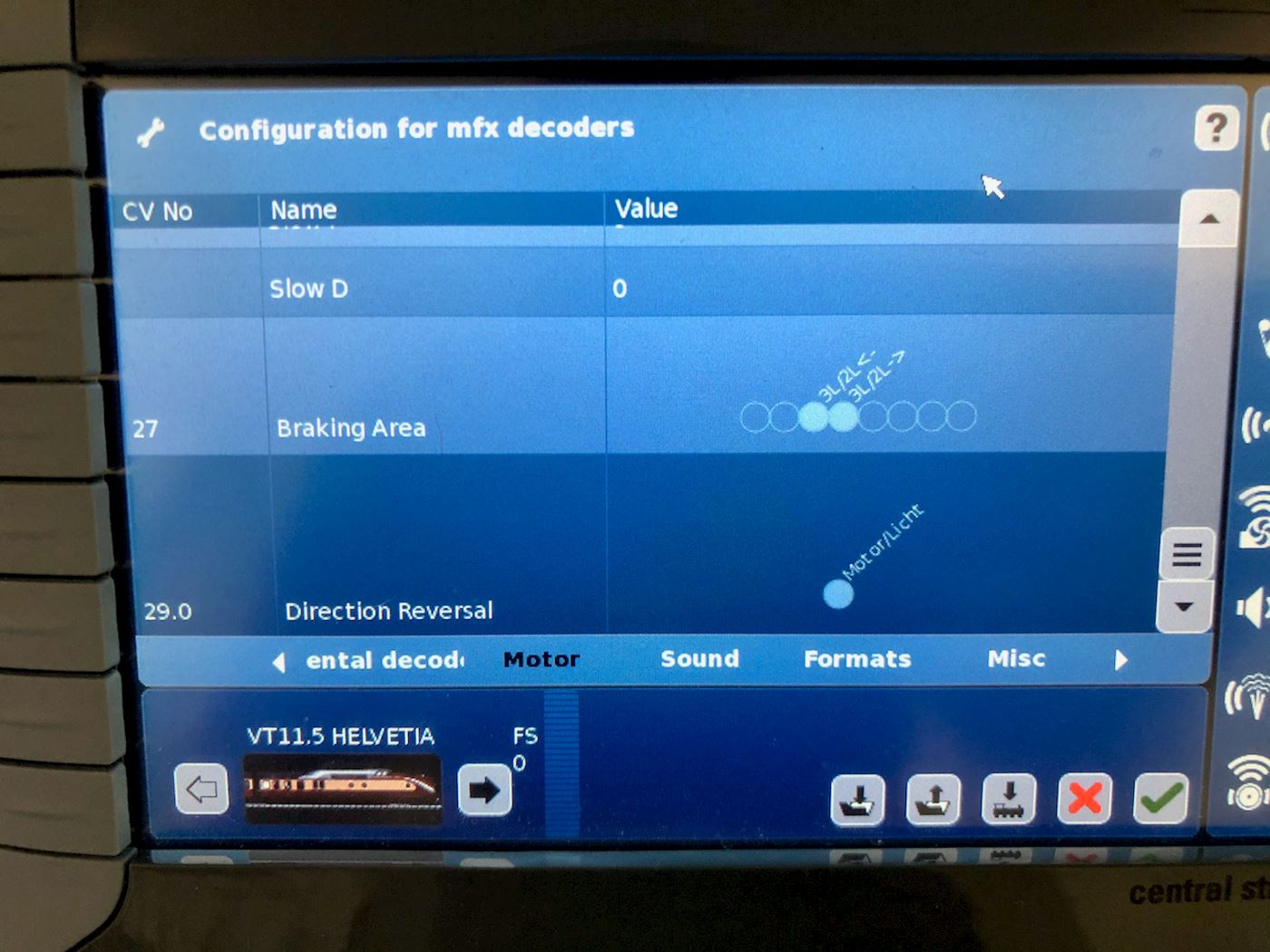

I can't help but think the problem is related to the reverse direction CV that you tried to change initially. The fact that you are unable to change it suggests to me there is a problem with the decoder which has set this bit. I wouldn't have expected it to be set as a factory setting, and having it show as a white dot suggests to me it is set.
Good insights Alan. That does make sense that the white is set while the black is empty or not set. I haven't used that interface recently and could not remember. I also knew 0 was the default and I had done a reset, so I assumed that it was correct without checking. That bit is for direction reversal and the default is 0 for normal operation. When the bit is toggled to 1 the direction is reversed, which fits my case exactly.
Of course that leads me to why I can't change it, how it got flipped in the first place and why a reset didn't fix it? I guess that CV might not be part of the reset image as Jean suggested, and therefore it doesn't get reset. The decoder might be failing and AFAIK I can't save the sounds from this decoder because they have locked that down. That was stupid. ThumbDown
