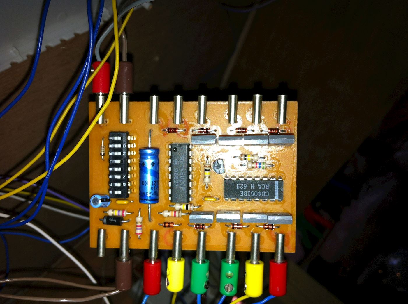

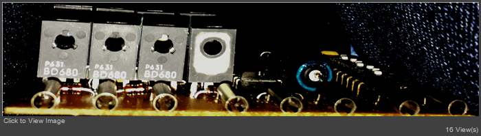

#3 Posted : 05 May 2020 16:47:50(UTC)
Posts: 3,688
Hi Stefano
Here is the inside of the 6083
If the unit is totally dead then I recommend you change it.
If this is only one output which is dead then replace the bipolar transistor (careful to solder it in the proper position as not all transistors are soldered in the same orientation)
They are BD 680. Here is a side view of the 6083
Look here https://fr.farnell.com/stmicroel...;CMP=KNC-GFR-GEN-SKU-MDC
I recommend you not to use more powerful transistors as it will burn elsewhere
Hope this helps

#5 Posted : 06 May 2020 15:11:43(UTC)
Posts: 3,688
Yes Stefano. I repaired one of my 6083 buying a few of these transistors (You better buy a few of them since shipment may be the key cost here

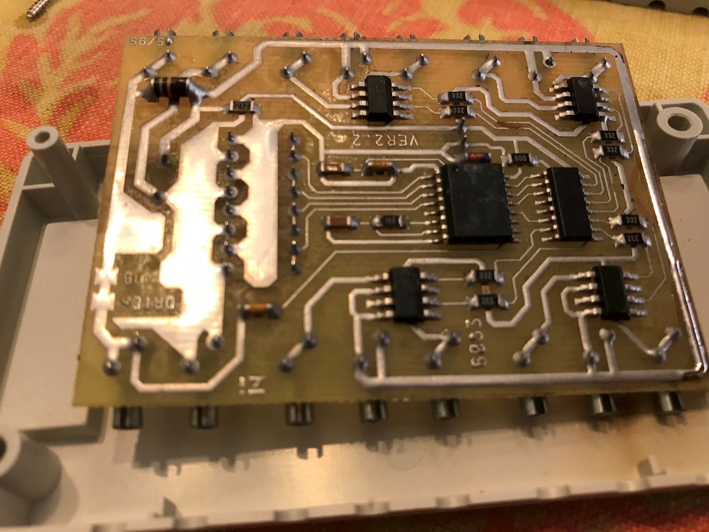

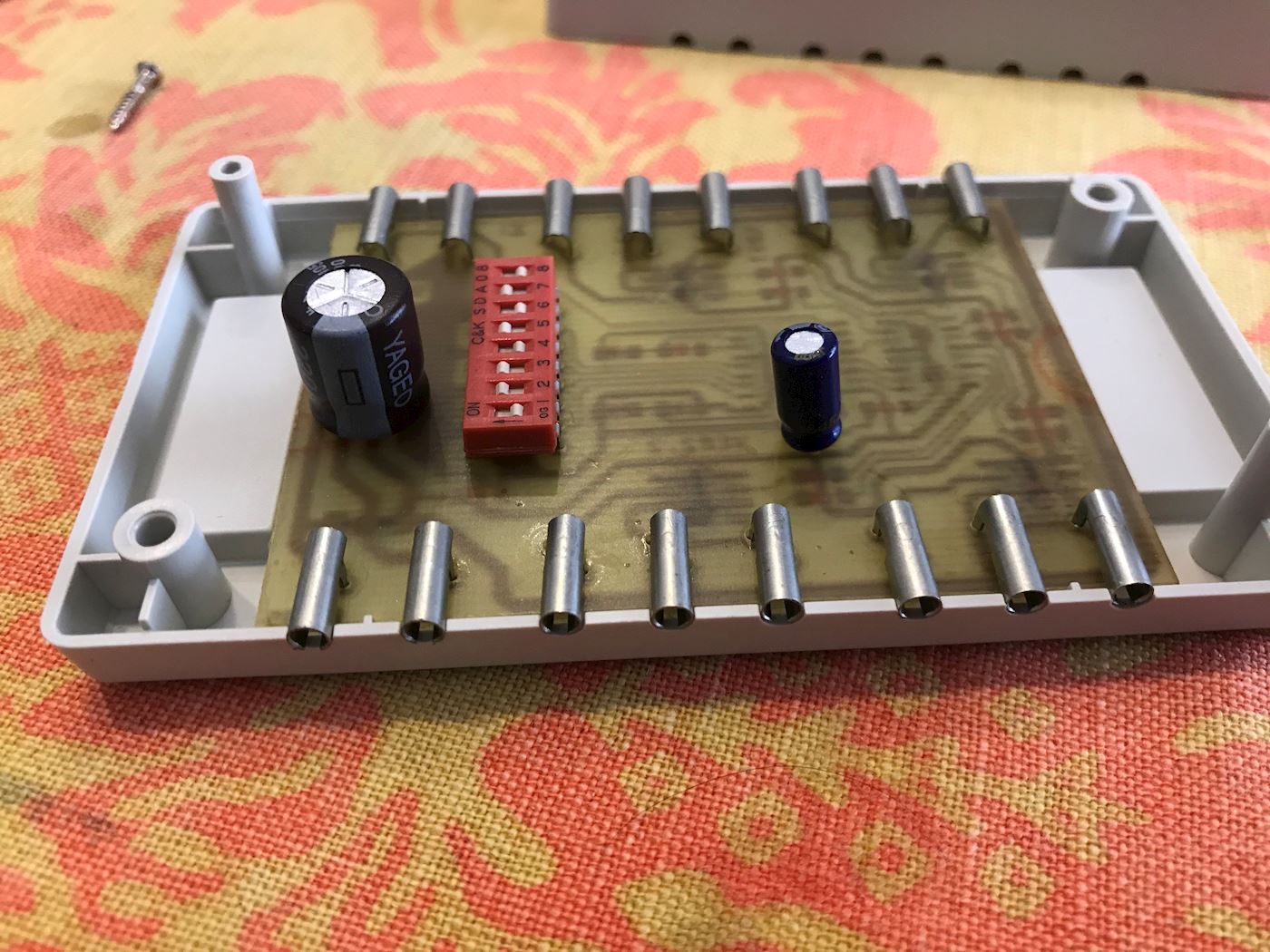

Good afternoon! I need your help again, please! The BD680 are arrived few days ago and today I wanted to fix the decoder. But my 6083 seems totally different from yours. I attach here some pics and maybe you can suggest me what to do.
Stefano

#8 Posted : 22 May 2020 19:17:51(UTC)
Posts: 3,688
Hi Sefano
You have a much later 6083 version than what I have. Yours have surface mounted devices (SMD) likely to be made in late 1990's.
Yes it is probably repairable but (IMO):
- you need to identify and procure the power SMD to replace (one of those 8 pins chips near the connecting plugs.
- you need to have a professional soldering station for replacing SMD.
SMD soldering / un-soldering must be made at the very exact temperature (too low you will tear some conducting tracks- too high: you will damage the PCB-printed circuit board)
I don't have such an equipment (motorised vaccum pump, hot air, chip-specific blades, etc) and personally I wouldn't spend too much on these 6083 devices because -I said this already- they must receive a switch OFF order to disconnect the solenoids (If they don't then both the 6083 AND the solenoid item will be destroyed ). With newer units 60832, if an ON order has been received, the 60832 will locally turn it OFF hence limiting the danger of burning one switch or signal.

#9 Posted : 22 May 2020 20:05:07(UTC)
Rocca
Joined: 28/01/2004(UTC)
Posts: 642
Hi Jean,
I supposed this was the problem :-(. I purchased such 6083 on E-bay and probably it is just my fault, because I didn't ever wonder similar troublshouting. Anyway, I suppose I need to replace them with the new ones. Thank you so much for your help. Repairing them seems out of my technical range...lol
Stefano
