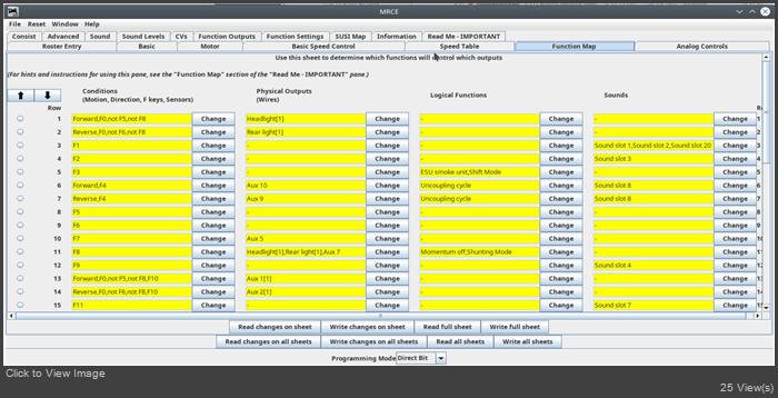

I can recommend JMRI to run on the computer, but then you still need a base station to generate the DCC signal per se. I think you can connect the CS3 to the PC, or you can put yourself together a DCC++ base station for 10 bucks or so (all you need is an arduino and a motor shield).
For an ESU decoder one of the application tabs looks like this. You can still access individual CVs if you want to, but all useful ones are shown in a user friendly way.
JMRI on RPi & DCC++ / C-track / Marklin, Roco, ESU, Bemo locos / Christmas car collector
