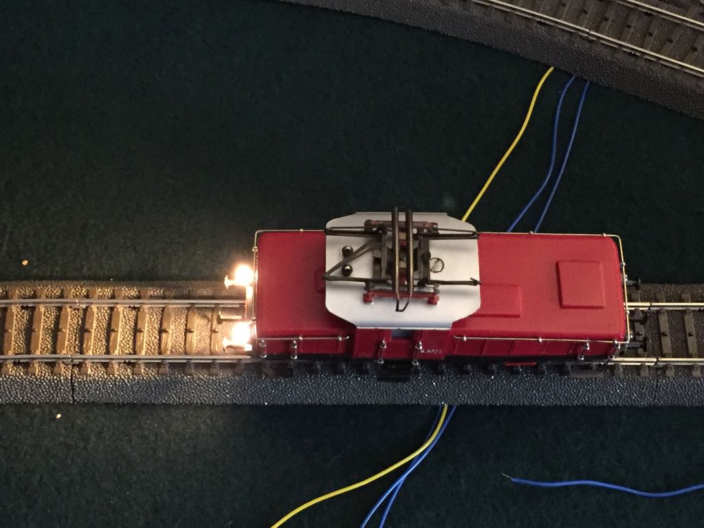

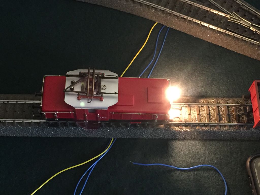

#8 Posted : 20 March 2020 17:52:20(UTC)
ocram63_uk
Joined: 07/01/2015(UTC)
Posts: 740
Location: England, Suffolk
the light bulbs have arrived.
Replaced only two of them to give it a try, especially because I thought that the studs were goign to be a problem, not problem this time.
The brighteness is the same, this LEDs shine like Xenon beams in a car, cold and whitish.
At least the old ones, although bright, are 'warm'.
I could always use a dab of clear brown / yellow color for glass surfaces.
LED on the short end of loco, back for me.
OLD on the long end of the loco, front for me.

Offline ocram63_uk
#10 Posted : 20 March 2020 19:20:41(UTC)
ocram63_uk
Posts: 740
I've always dreamt of the Micheline but although I LOVE Maerklin the pick up shoe sticking out at the back never made me buy one.
I agree with you the 3001 is a nice loco, too bad M has never re-made a 'modern' version at a reasonable price hahaha
I was hoping that with LEDs the light was goign to be less bright.
So I thing I will stick to the old lamps and put resistor. Only problem is, 30 years ago I knew where to go and buy them after speaking with the shop guy, today I have to buy bulk and try them one after the other. I really hate this noline generation :-(
It isn't fun shopping anymore either.
I was in Berline a month ago and I went to this AMAZING shop, now this is what I like doing. Hope to go back to Berlin or other German cities in the future. A colleague went to Goppingen for work and sent me a picture of the Maerklin factory, knowing I am into it. I hated him for not dispatching me there instead :-(
