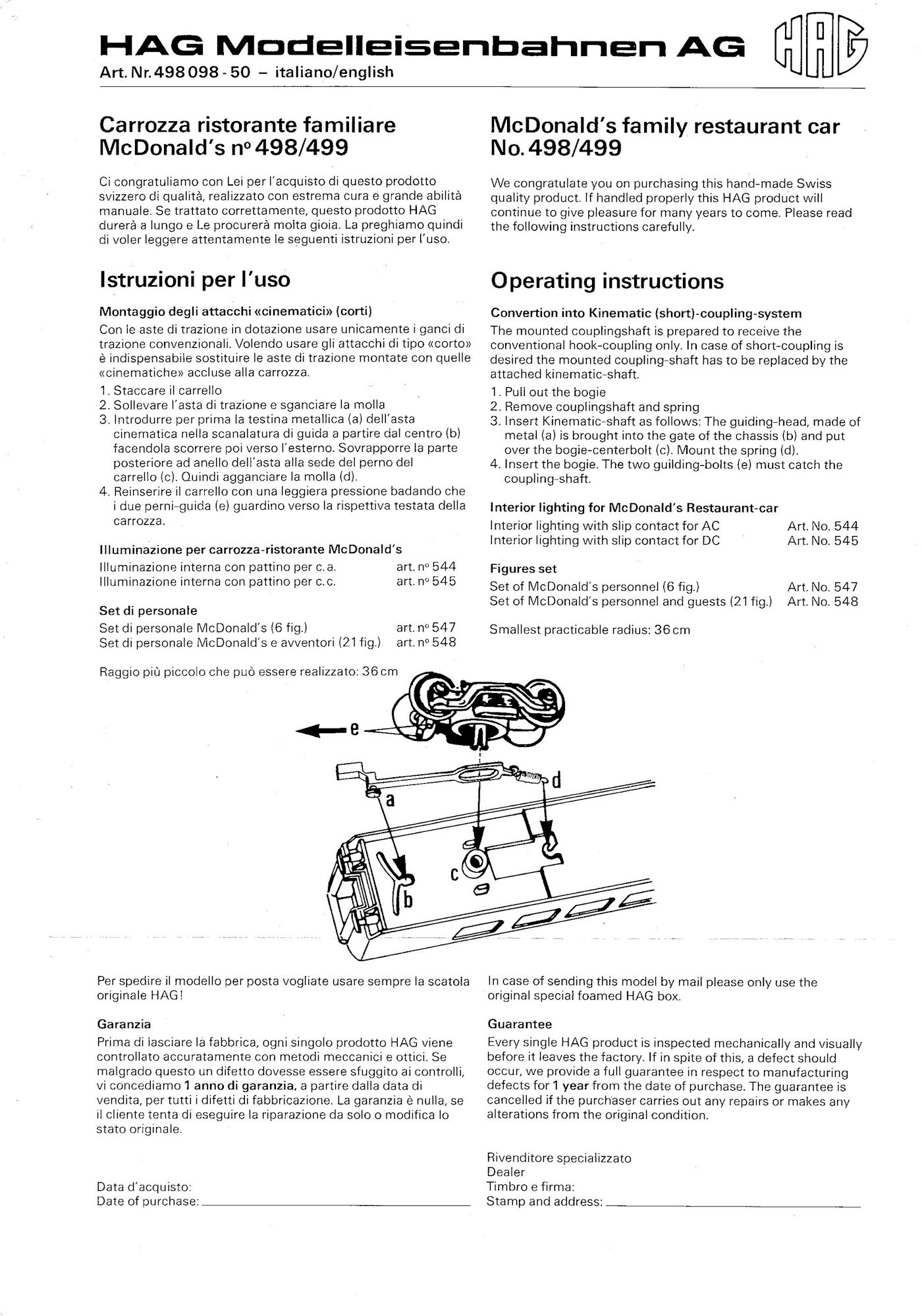

Here is a scan of the English instruction sheet for the McDonald's car. You might want to pry out the entire bogie/truck first for an easier swapping of the wheelsets.
