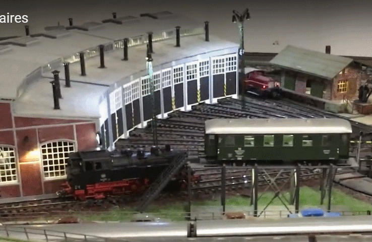

Hi Jim
I have the Brawa tower power light with tiny bulbs that kept burning so I took from my stock of power LEDs ribbons I use to light coaches and enameled wire (from dead switch motors).
The difficult part is to solder the wire with the LED (but feasible with an electronic soldering iron).
Next is to paint the wire the same color as the pylon.
Then attach the wire so that it remains discreet, insert a resistor so to have a 10 to 20 mA. This is 1.5 kOhms to 2.2 kOhms with 12 to 14 VDC
Here is the result (top center of picture):
Note: with those latest LEDs you may have to reduce the current and they are extra flat (.5mm or so)
