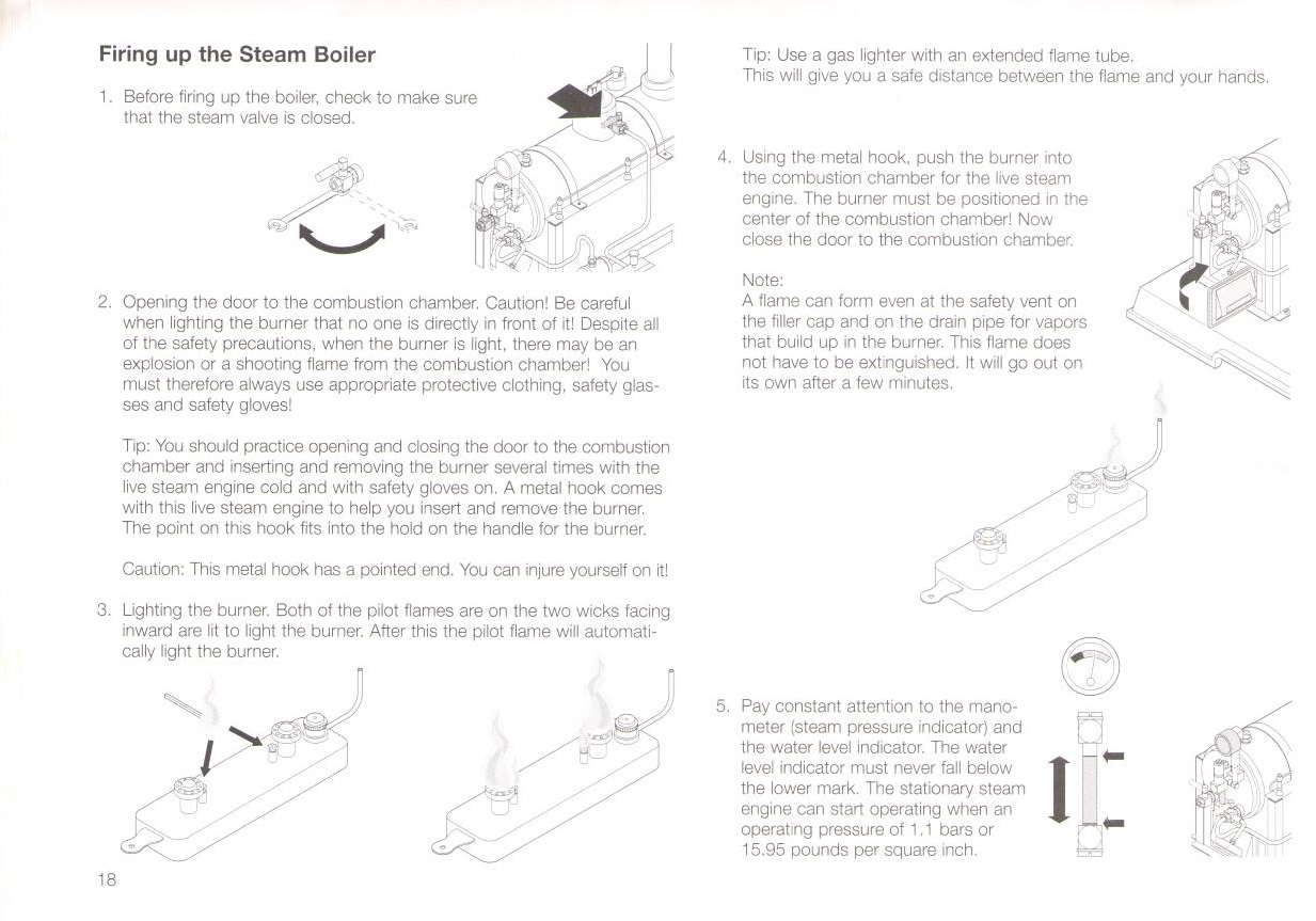

I received an enquiry off-list for instructions for this model and it appears others have also needed to find them from time to time but uploads on others sites have since vanished so I though it a good idea to post them here for posterity.
But first, the original brochure...

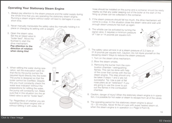

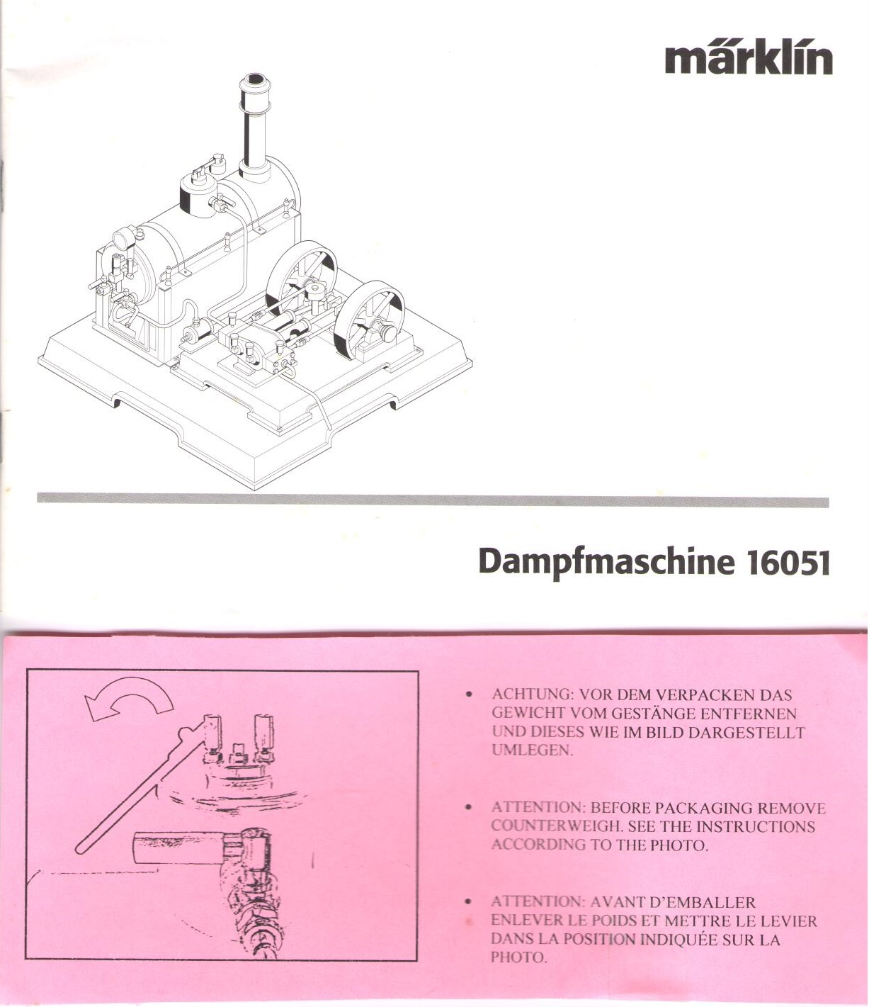

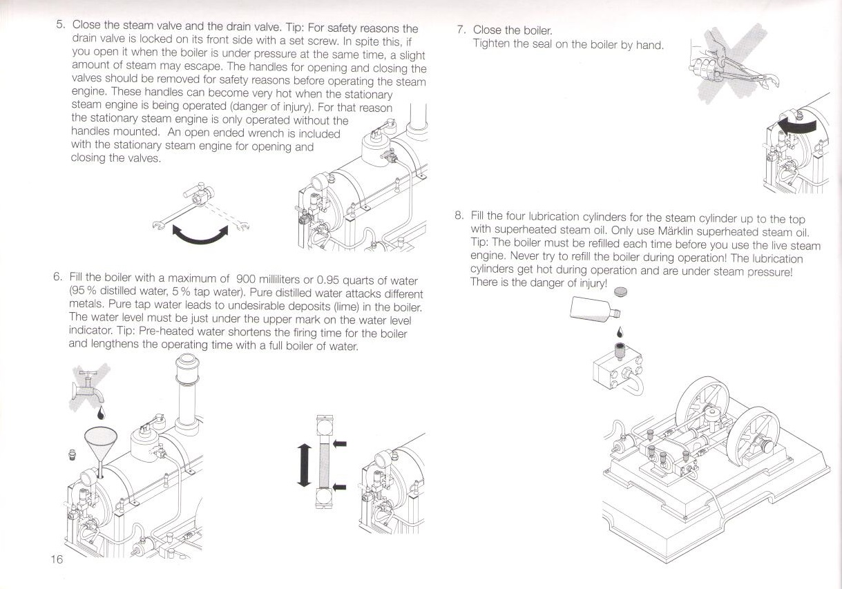

And the instructions...
Special Oil for SuperHeated Engines - PN 651828
